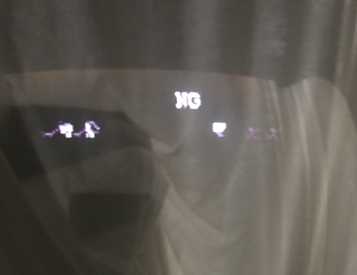

Last item I’ll post here before trying another C board and SD card.
When running 74 Musclebomber I’ll get this on boot which is same I believe when I tested it with the original PAL installed for whatever that is worth.

@arcadeaction i get the same thing when I run that game with the original PAL. On original PAL none of my qsound games booted. Cadillacs was black screen. Others booted to RAM ERROR or RAM ERR. I expect the custom pal is just the original pal with extra routing for qsound and any higher addressing if cps1.5 data is larger than cps1.
Maybe they can send you a new pal to test out before you ship the whole thing somewhere

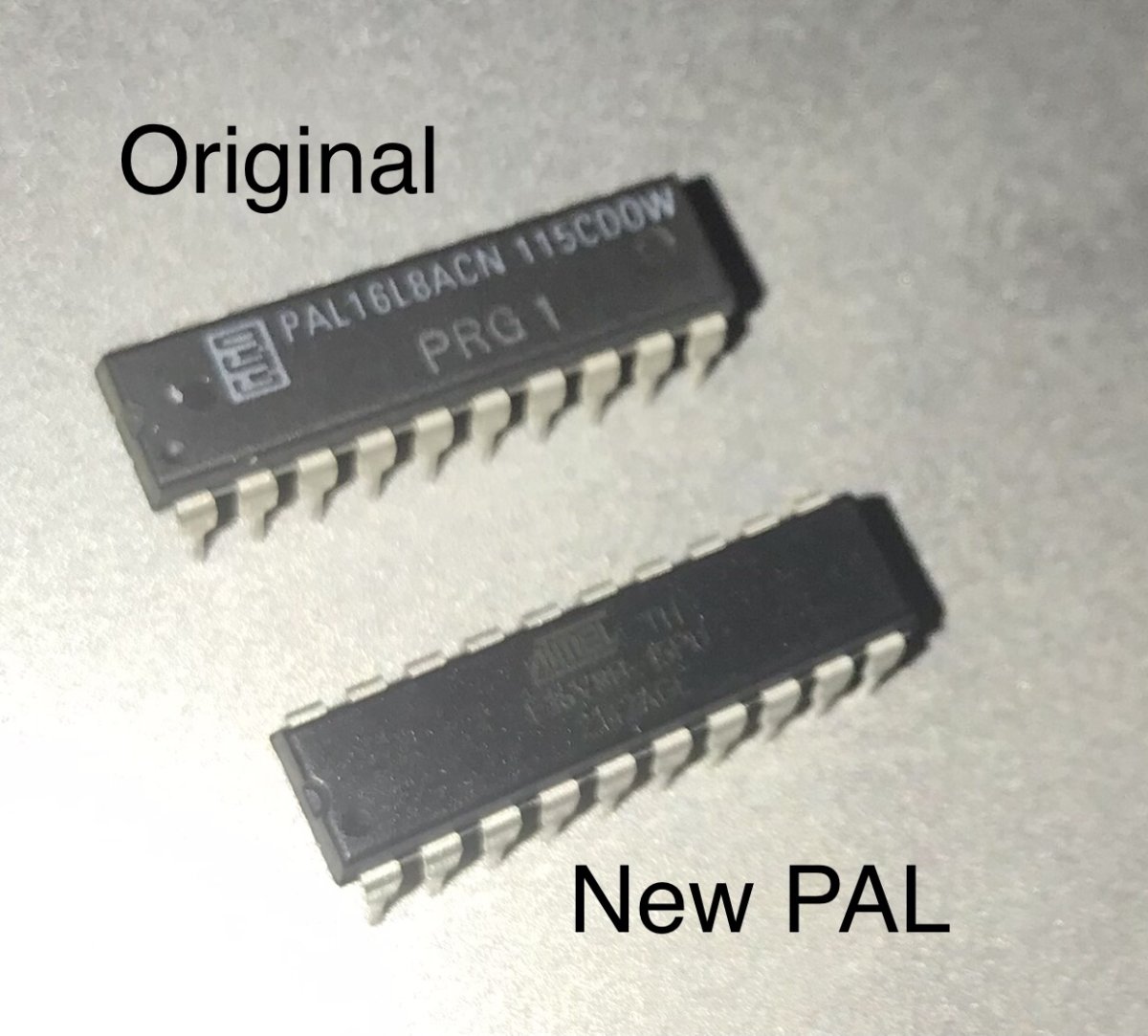

I feel like with all that A-board swapping his original Darksoft PAL got shuffled/lost (and now he IS using a stock PAL).
My DS PAL is a AMETL if that helps at all.
Here’s a photo posted earlier of the original PAL and then the new PAL provided which has been installed on the A board. All Qsound games are booting except any Musclebomber/Slammaster games, but no Qsound games have audio over JAMMA, but these games do have good audio over stereo output.
