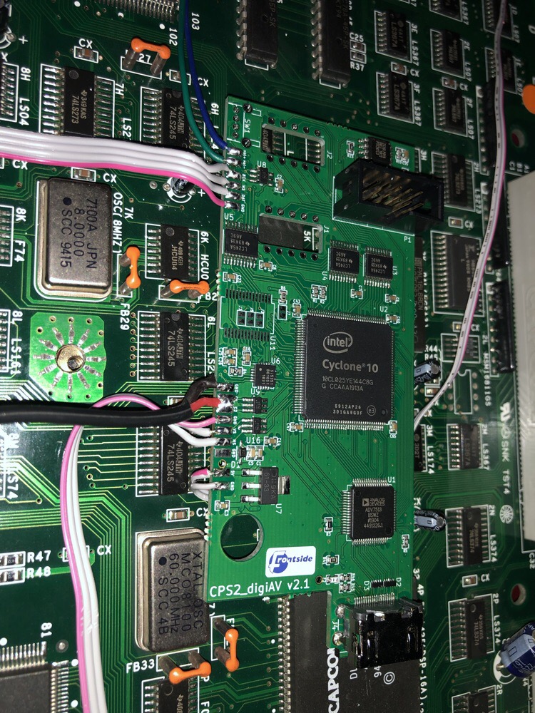

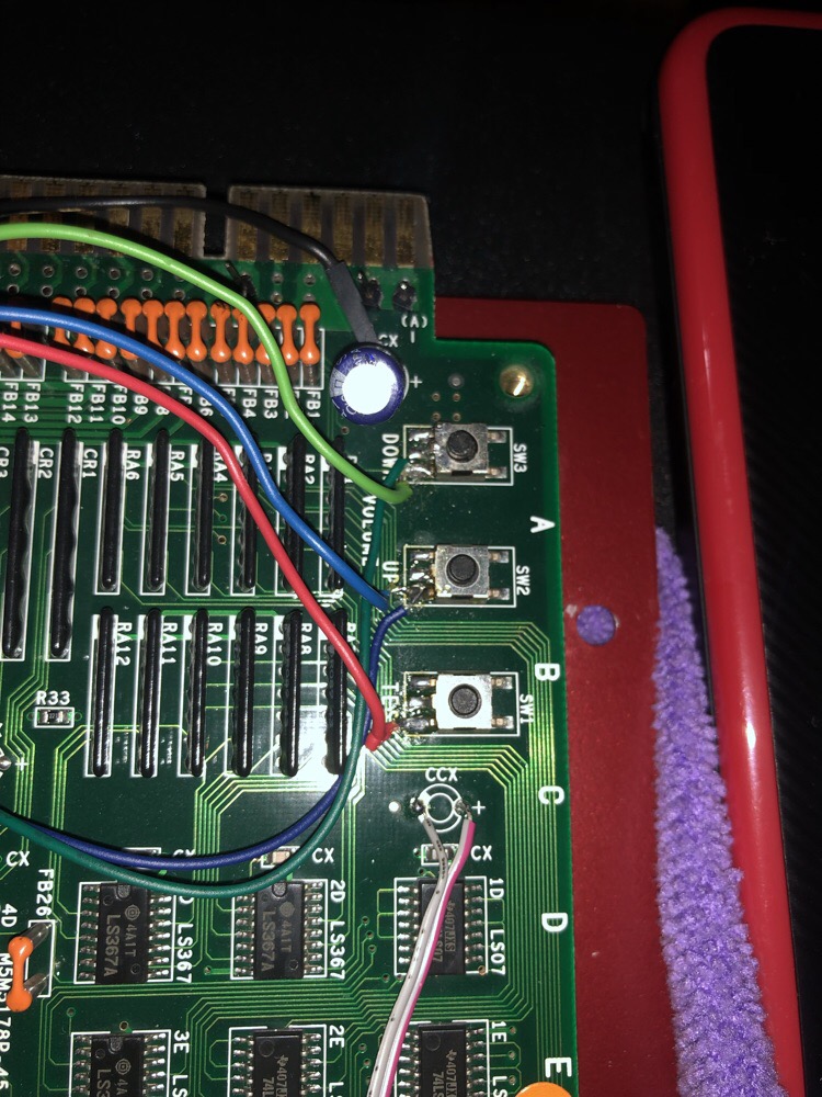

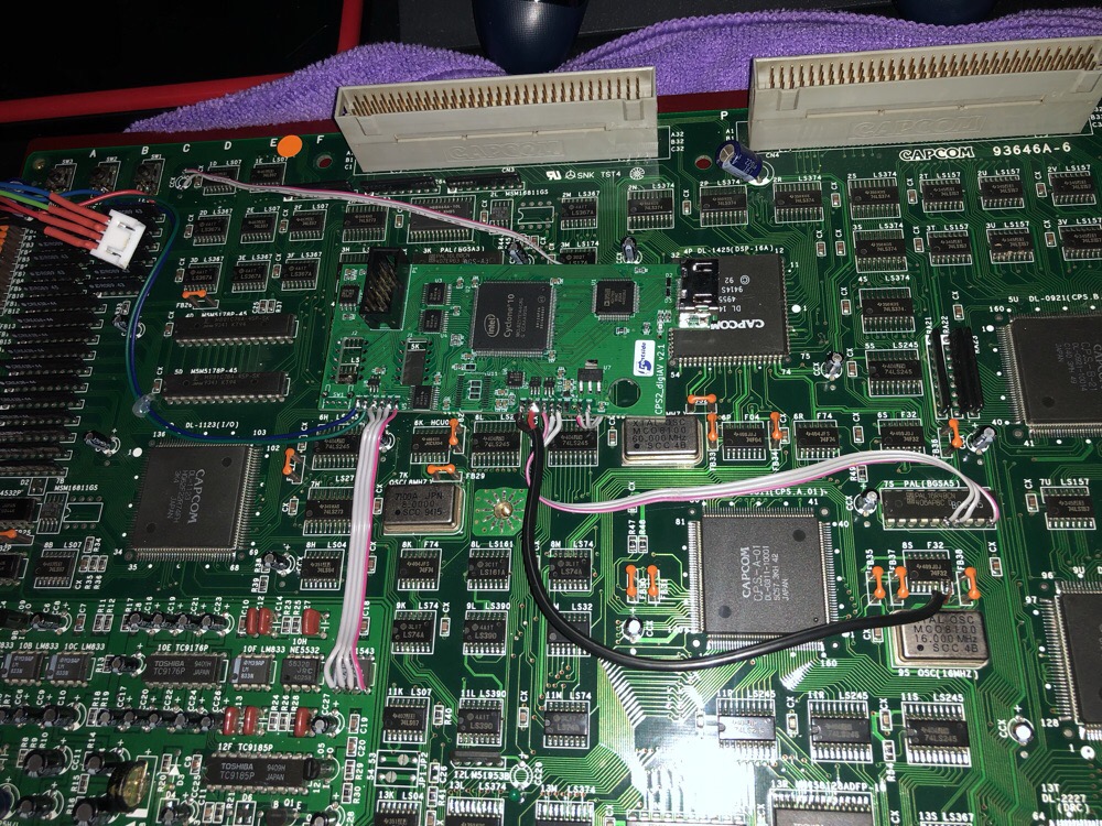

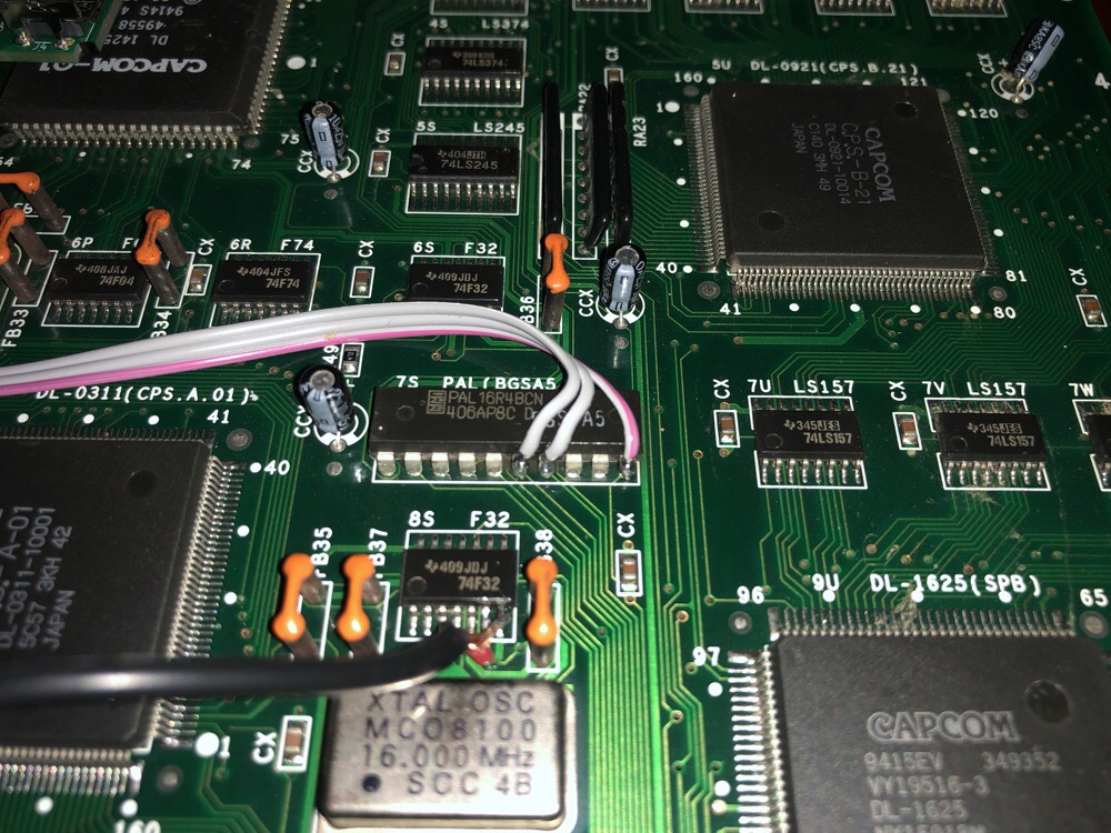

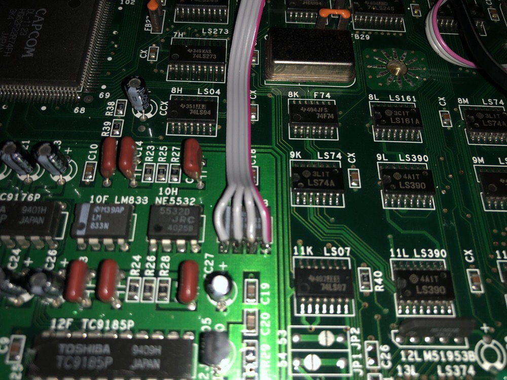

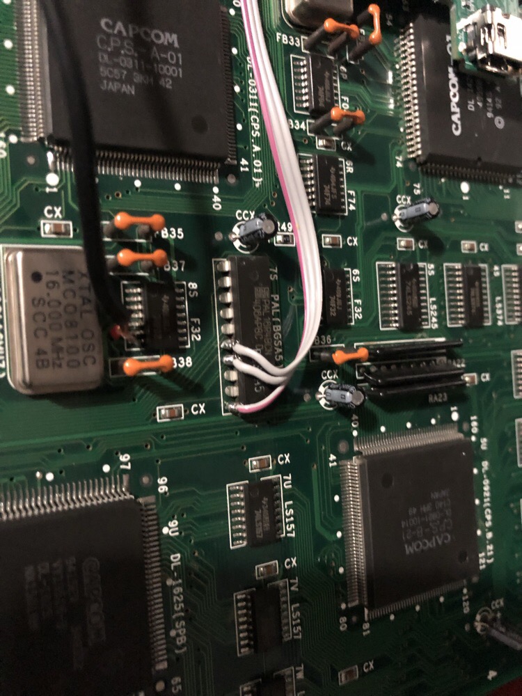

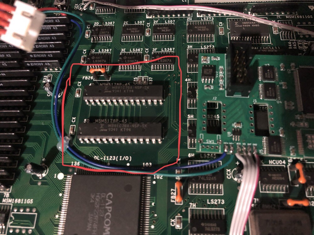

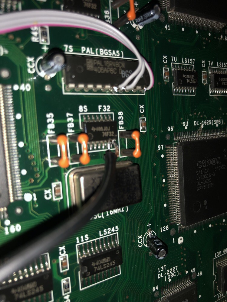

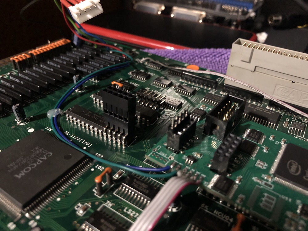

Hello everyone,
Me and @jassin000 (mostly jassin) tried to install the hdmi digiav yesterday but got no video, the tv switched to the hdmi port it was connected to so we know it’s getting power, im not sure if i missed something, honestly i went by @RGB photos and some other online photos. If someone can help that would be great :/

You forgot about something :)
Also, I suggest thicker wire gauge for power (at least 24AWG).
Thanks @RGB, will replace the power wires and will put the headers on the digiav but im confused as to what im suppose to do with those 2 chips you pointed on the left side
