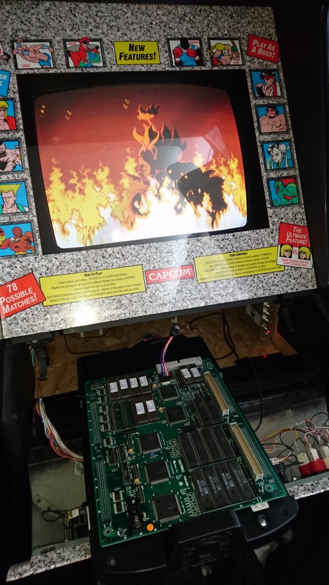

Thought i would try this method looks interesting and seeing as infinity key is difficult to get or so expensive in the uk i thought this was the next best thing, bought a set of PIC12F675 chips and coded 1 with the Tl866 and the keys for X-Men Children of the Atom Japan, made mine using dupont cables that i could plug directly into the CN9 connector, works absolutely fine luckly all my cps2 boards are rev 6 and 7 i only have one rev 4 board so i soldered header pins on for quick connect, i dont really like wires hardwired to boards.
This is a very quick way of loading keys if you wanted to go back onto battery and don't have an Arduino or can't be bothered to get it all out, anyway booted the board the game fired up i then switch off clipped the battery back in removed the mod chip and the game worked fine running off battery again, great mod 👍 so much great information on cps2 now, wish we had all these mods years ago when i first bought my super turbo and X-Men cota back in 1998, absolutely bricking it when it came to changing batteries in the old days, how times have change.
Thought i would try something different, quick release mod chips to de suicide a board these chips are ridiculously cheap so bought a few, with the help of some chip sockets i can mount the chip in the holder and place it in my custom cable, I've coded 7 chips already for some of my most used cps2s, thought i would test one board, i have battery holders all my boards so pulled the battery and killed the board, put the chip in and de suicided it and put the battery back in, this is a very quick method of reloading the keys, i do have adrino but this method is a lot less hassle, and you don't need to power the board externally like you have to with adrino, as someone who prefers to keep batteries on boards this method is ideal for me.

I can mate but usually ssf2 nc comes on a rev 3 or 4 board which means no CN9 connector, instead you will have to solder the chip wires to the cn2 connector like someone has done here, i have the same board as you and i soldered header pins on so i could use my cable.
