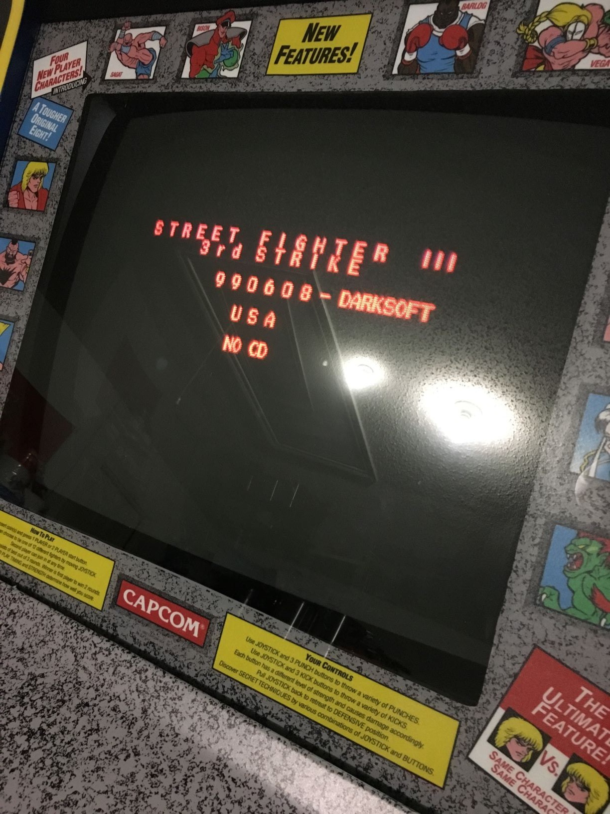

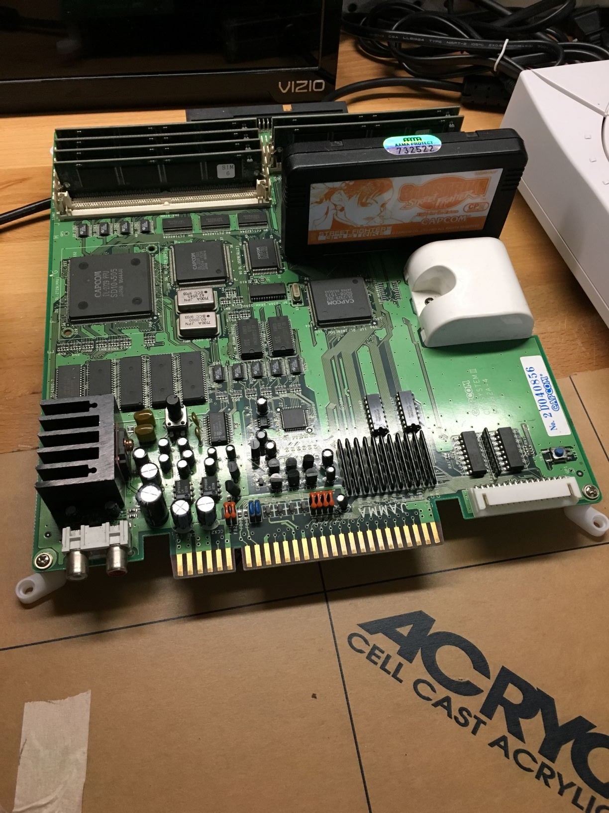

Hello everybody, I purchased a cps3 pcb with 3rd Strike cartridge off of ebay from some guy in CA. Game works flawlessly. My dilemma is that there is no CD nor scsi2sd hooked up to it. How is this possible? Is this some sort of new cart mod? I've attached a picture of my set up. Thanks in advance for y'all input.

You have the no cd version. A few of the game have such version. Do you know when the battery was last changed? These thing are very temperament so be careful if it's still on battery

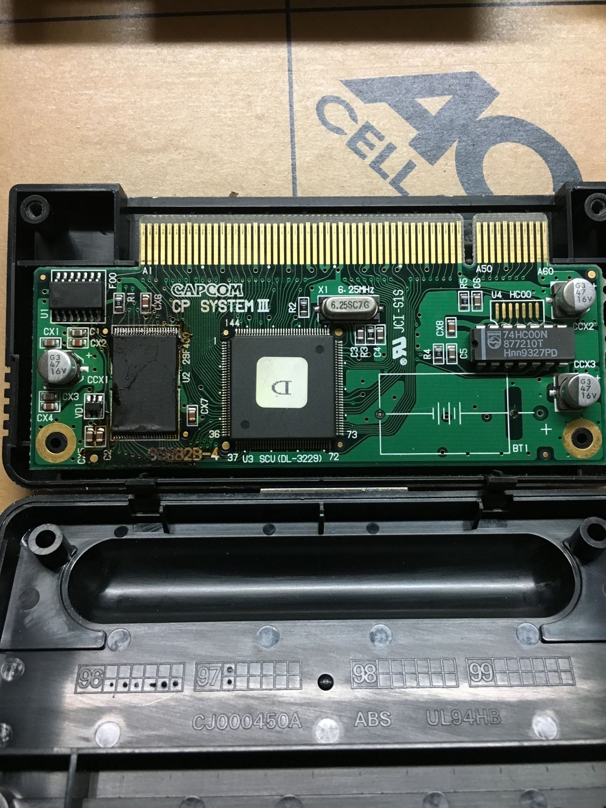

I opened up the cart and is battery suicide (no battery). When I start it up it says USA no cd darksoft. Would I be able to flash the super bios to this cart?

That is a modified superbios cart with the cd drive disabled. You can flash the original superbios to it if you like. If you have a spare cart I would flash that cart and pick up a drive. This way you can flash a game when you like and just use this cart to boot with cd drive disconnected. Your current cart is not link to 3rd Strike. It will direct boot whatever game is loaded on the Simm with out a drive. Only issue I had was with red earth where it was laggy if I remember correctly

You have to pull the bios ic flash it and solder it back in. It's the IC next to the big one with the D on it with a bunch of flux on it

If the cart has no battery and it's running Darksoft SF3:3S nocd then the bios chip in the cart must already be the Darksoft one. Looking at the bios chip its definitely been replaced...
surely the simms have just been flashed with the nocd image and can be re-flashed with the normal one by adding a cdrom drive with the correct cdr inside (multi-custom bios).
