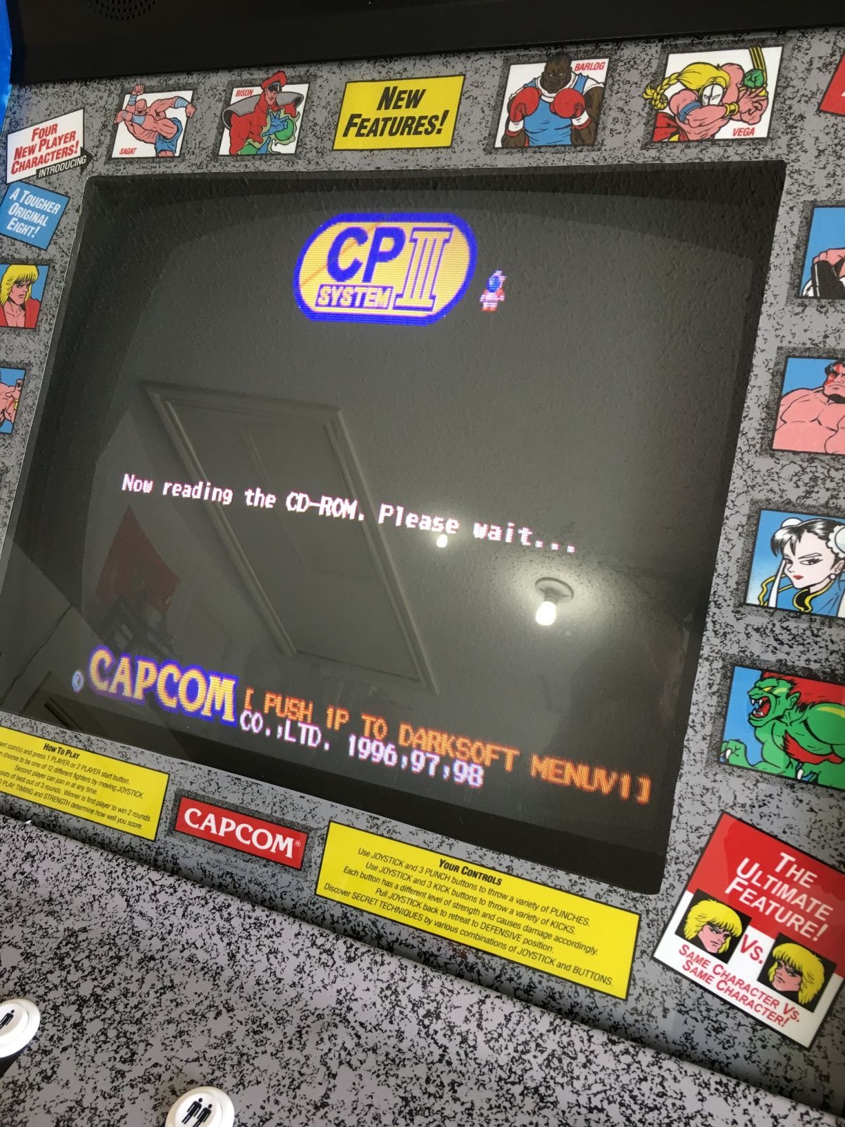

Are you sure he set the options of the SCSI2SD, or did he just write the image to SD card for you?
You of course need to do both, first set the SCSI2SD options, then image the card.

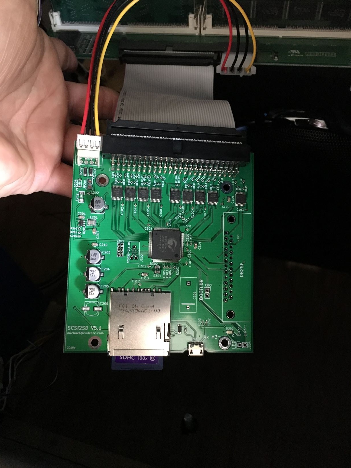

If your ribbon cable worked with the original CD-ROM it still works and isn't the issue.
You can skip the molex power cable, it isn't needed with SCSI2SD device (ribbon cable only).

First remove that molex power cord, you don't need it.
I highly doubt the cable is bad, what I see in your pictures is you didn't line up pin 1 of the ribbon on both ends (red stripe).
The red strip should always be closest to power on both the CPS3 motherboard and SCSI2SD PCB.
See mine?
Notice how on both boards the red strip of the ribbon is closest to the power connector of both devices?
I think you'll need a longer cable to do the "twist" in the center to flip the cable around, or just keep the SCSI2SD upside down.

Make sure you burn the “custom” superbios image, not the “standard”
Make sure to enable parity and scsi ID to “1”

What kind of power supply are you running in that cabinet?

Yea once he said you had the same hardware working on your setup, I knew it had to be cable related, but new SCSI cables coming in bad?
Fuck I've never seen a bad one in my life (even creased beat to shit looking ones from 1990)... Only... If you plug it in backwards, yea that's just not going to work. ;)
