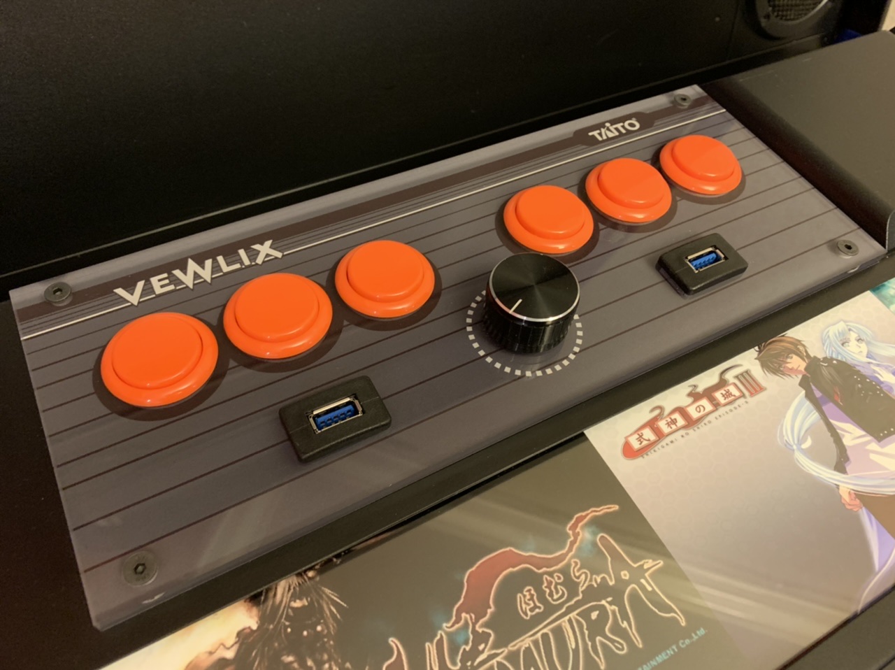

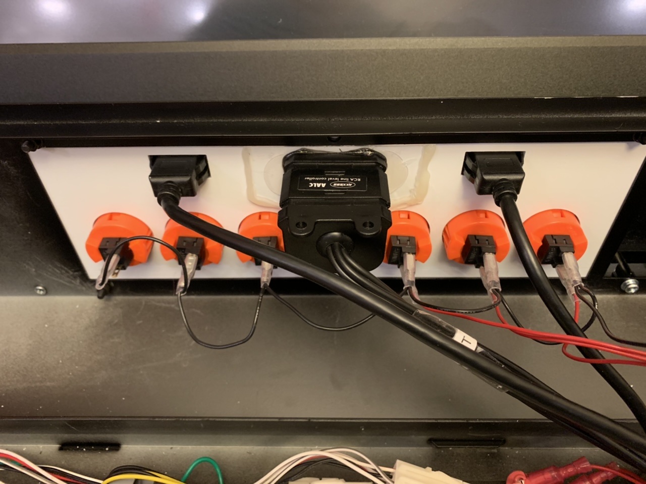

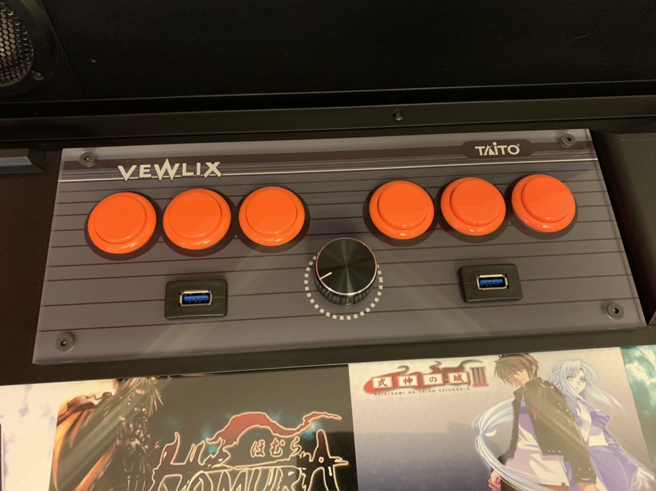

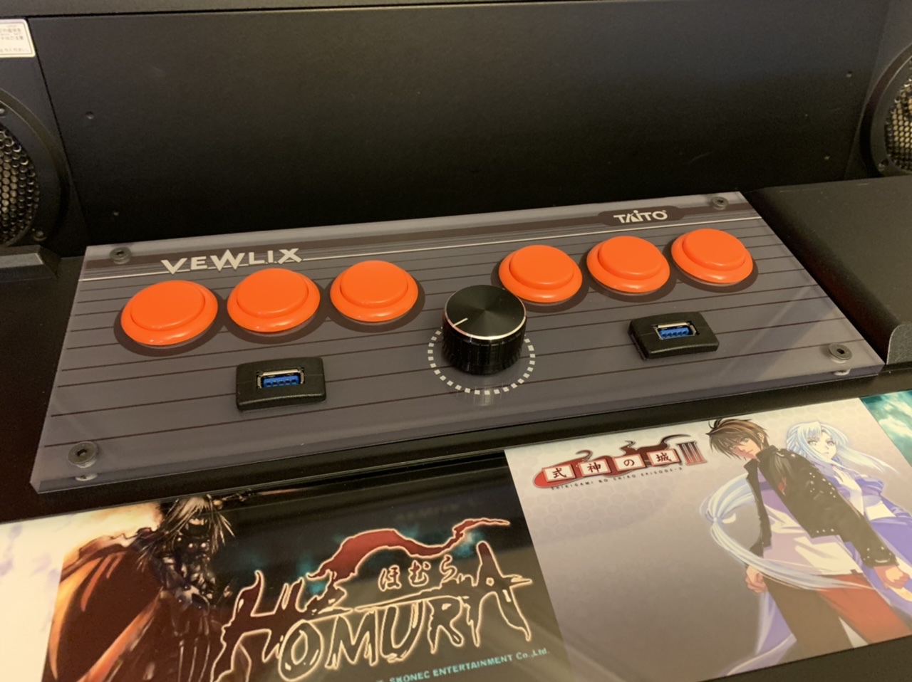

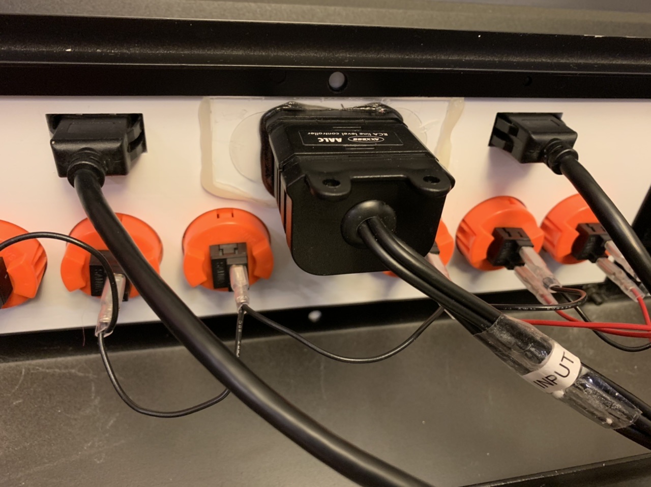

The panel looks amazing! Really professional looking. My thread on the volume knob was also short. Here’s what I ended up doing..
Epoxy a small plexi to top of the knob. I shaved it down to get it as flat as possible.
I then mounted that plexi to the bottom of the panel and used hot glue to adhere them together. I used hot glue here because it’s easily removable if I ever need to.

I believe I used the M4 bolt in this kit. I slowly countersunk the holes by hand to make sure I removed just the perfect amount of material off panel for it to sit flush.
