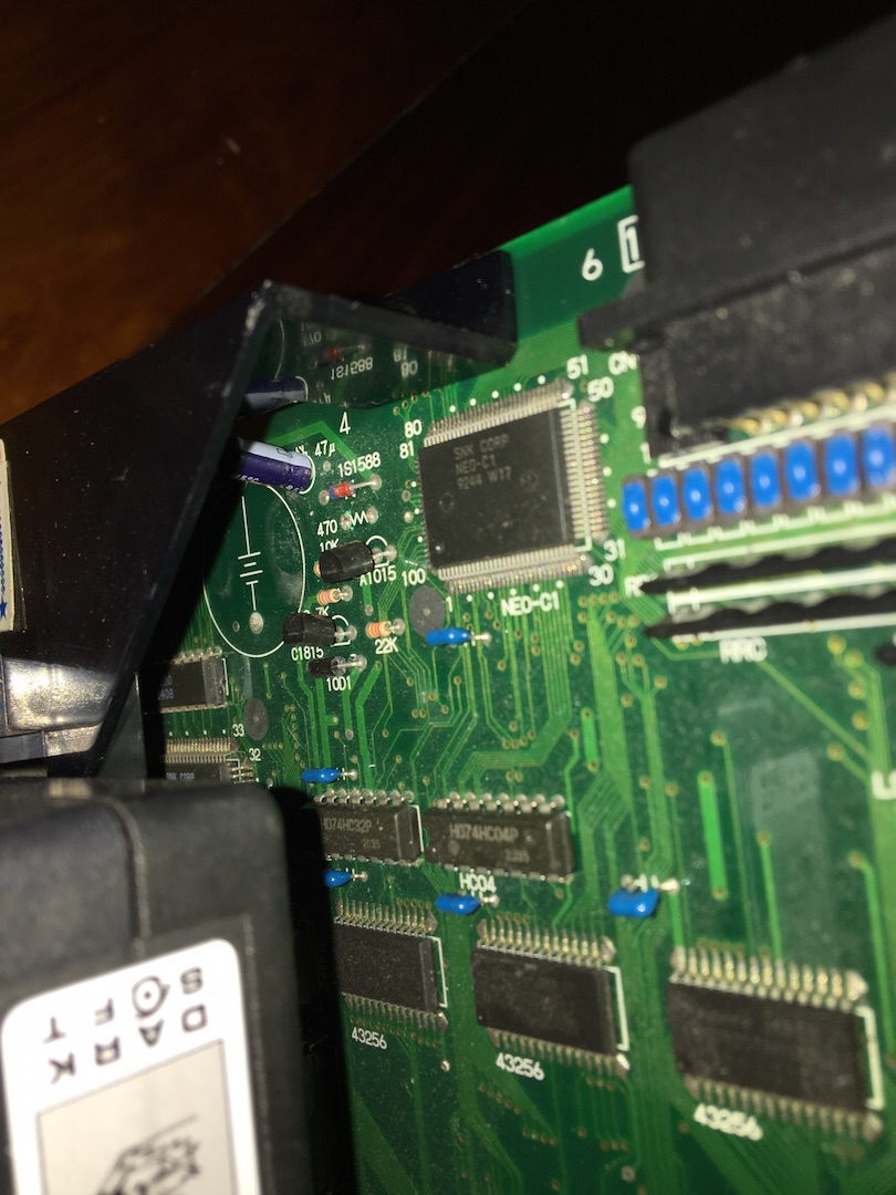

Cheers for the replies. I will try another SD card, I assumed the "no games found" could also have something to do with the lack of battery as it usually happens from a cold boot after not using the cart for some time.
Huh. You could be onto something there. I don't think I've had the issue since I installed a battery. Let us know.
It's the battery, the multi stores configuration parameters in battery backed NVRAM. If RAM is bad/corrupted you get the issue.
I can install a battery if that’s the case. I removed it because I remove the batteries on any Neo boards that cross my path.
Easy enough to throw on a CR2032 and disable the charge circuit though (I may have already disabled the charge circuit on it, I forget now)

I'd remove it if it hasn't been done already. A CR2032 lasts a long time, way longer than a rechargeable one as you probably don't use it too often/long enough to properly charge it. And even if so, it's loosing its charge pretty quickly.
What's the best way to replace the battery ?
Anyone have any links to good battery holders and the elusive resistor to remove ?

The resistor is a 470ohm resistor literally right next to the battery
Battery holders should be easily obtainable from your local electronics hobby shop or Element14/Mouser/RS/Arrow etc depending on country
If @djsheep can take a photo of the battery area on his board you can see the resistor (1F)

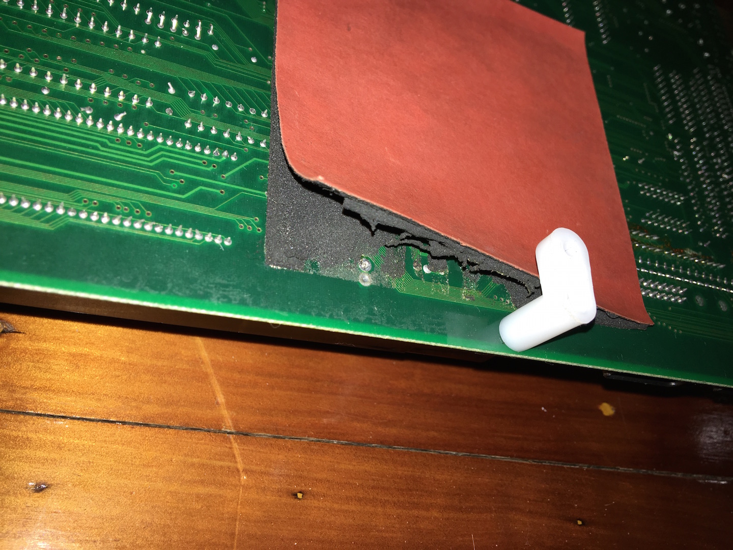

I see you already removed the 470ohm resistor. I think the biggest tackle here now would be getting that foam off the motherboard ;)

Also, I cleaned up the foam around the pads for the battery so I could remove the battery with the desoldering gun. I remember that board. I had a LOT of trouble trying to clean up the foam for the resistor pins so I gave up and cut it instead. The foam on that board was very difficult, it's gone completely rock solid and it just flakes off when you try to clean it up. I'd leave it, you should still have access to the pads to install the battery holder.
