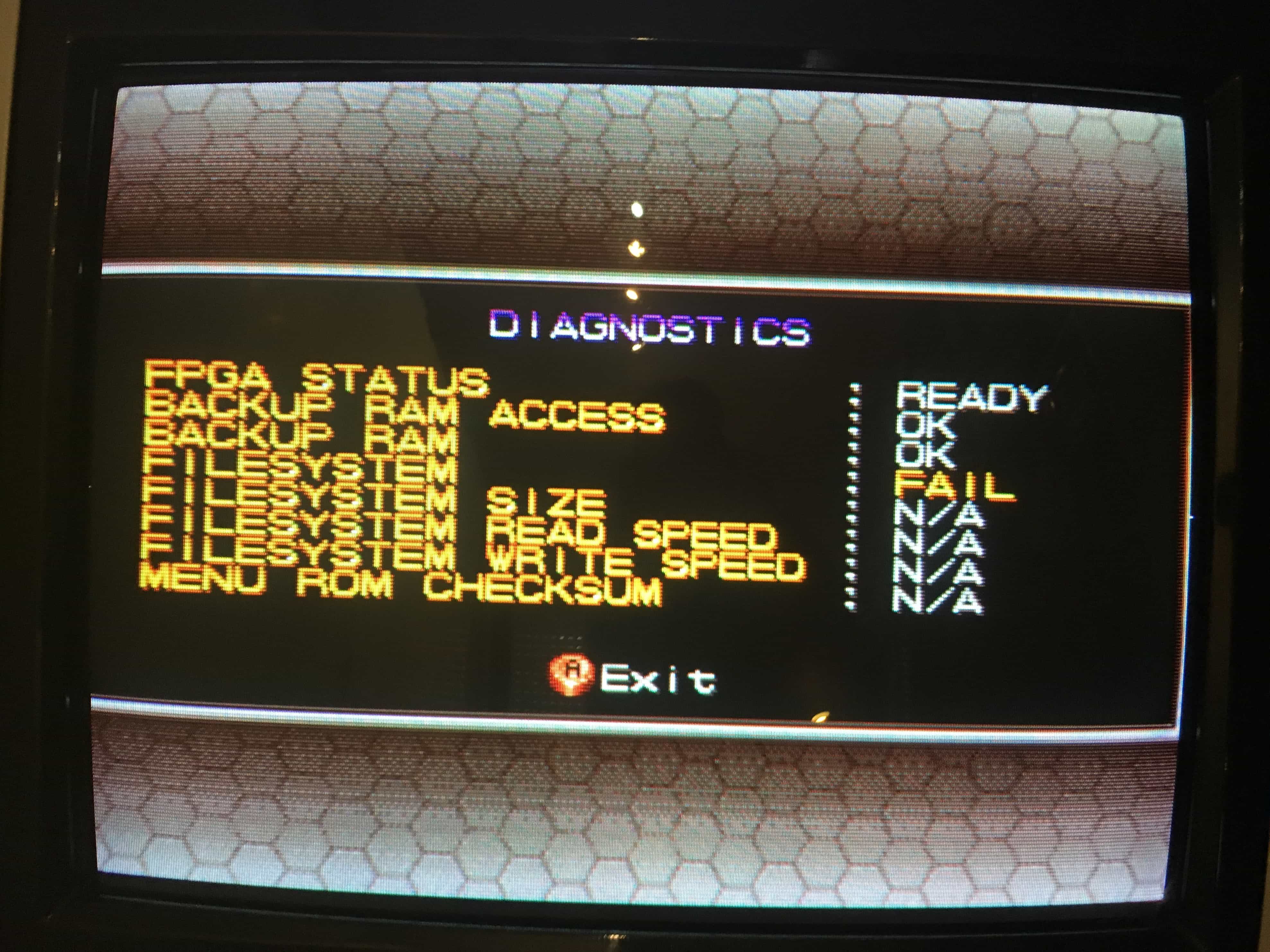

The about matches the one in the first post. I updated recently with the new firmware and Mar 24th Menu. Have now updated to the 1st April Menu and I'm getting a file system error when it is booting up. When I run the diagnostics it is showing as a fail on filesystem.
I have run some tests and some games are working fine. I can flash to the slots individually but if I try to quick flash slot 1 by pressing start then it hangs on please wait screen. If I try to run RB FF 2 in MVS mode I get SNK warning screen but if I change unibios to AES it works ok. Filesystem error is 0x01. Hope this helps.
I updated the flash file first and the filesystem error has gone. I tried RB FF 2 and got the SNK warning screen in arcade mode on the unibios. I then updated the top file and now RB FF 2 works perfectly. Thank you very much for all your efforts in sorting this out.
