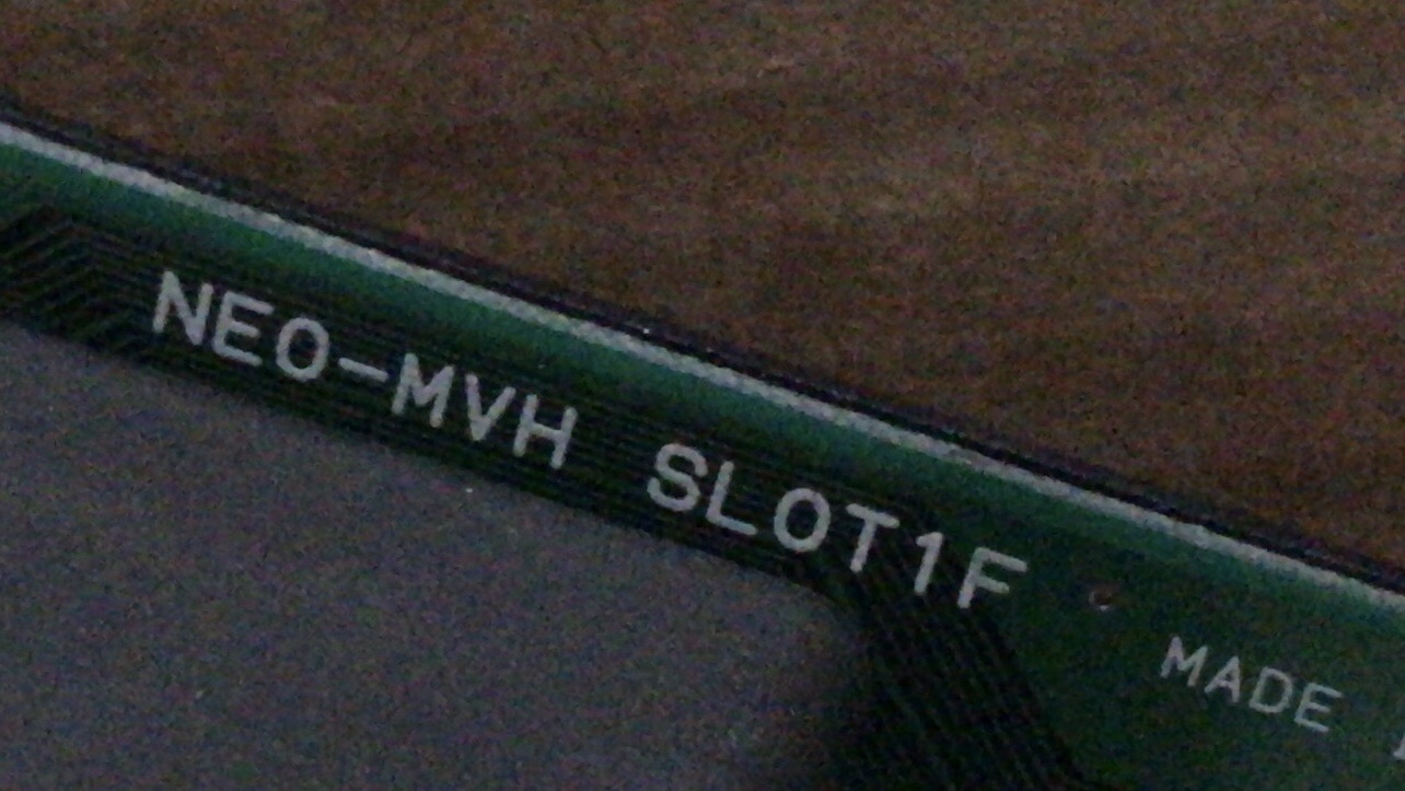

You have the fitting menu to the older firmware please
