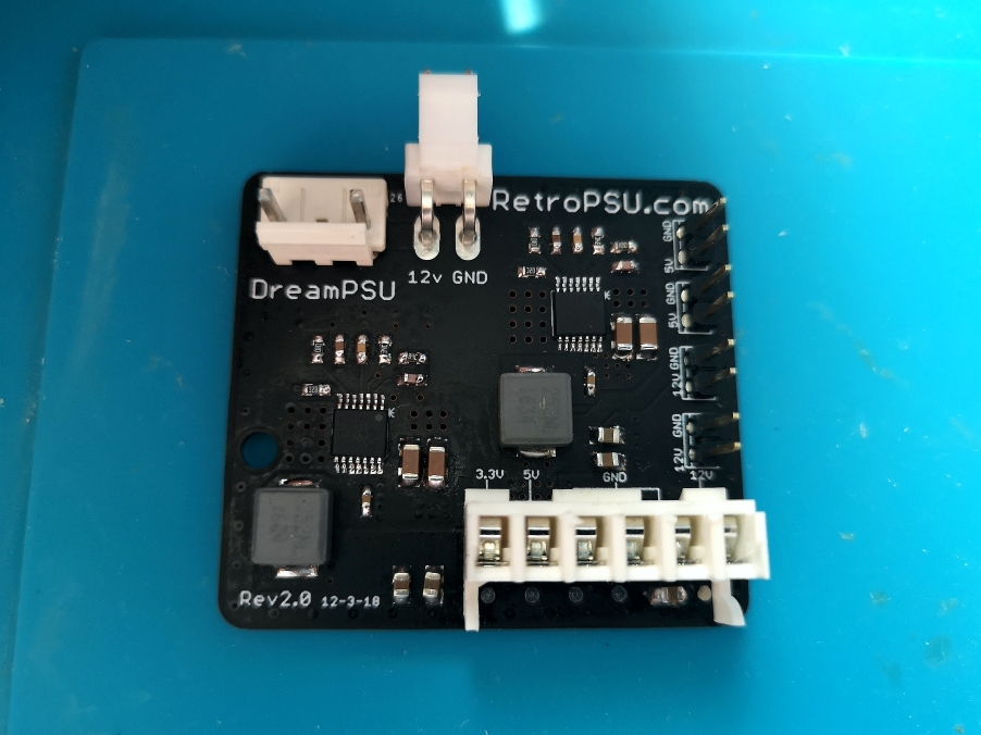

i have both 3 options on hands for DC (Chris2600 pico psu,pico dreamcast unit and for this i'm looking for a pico psu and also i can remove that components from the stock psu without problems) ... but , in the hope i solder right my DreamPSU board and will not be necessary to use the Chris2600 pico psu option (i have the board but i don't have a pico for it) .
Again ... if the smd's are on the correct position , hope the DreamPSU i've solder will be fine for my VA1 DC console. Thank you sir !
Also, if you guys need to compile by yourself a DreamPSU unit, @PascalP have some uncompiled - components + boards (for that you will need to install eagle and load the board project there to see where the parts must be soldered) . Mine wasn't checked yet because i don't have an adapter for this purpose yet , but i'll buy one (until i will buy one , my only option is to go with on a friend who have all i need to check it) . I'll report my feedback here anyway.

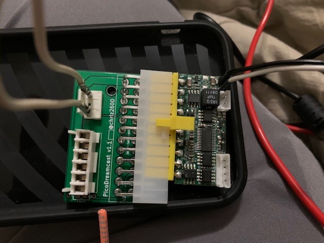

For those of you out there interested, the 20-pin 80 watt Pico PSU works just fine with the Dreamcast Pico PCB which has a 24-pin connector. A little unsymetrical, but it is going to be in the DC case anyway outof sight (see pic below). I tested the voltages being piped into the Dreamcast connection header (the 5-position header on the bottom left) using a Fluke meter without load and they are very stable. Installed it and it works like a dream (pun intended) and runs super cool with GDEmu.
I definitely think this is a much better than the DreamPSU solution which IMO, no one should even bother with at this point. However, this puppy is a tad expensive.
