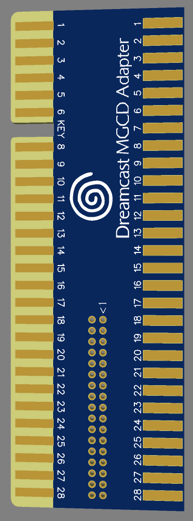

So a member gave me an MGCD. No idea if it works. Might be burnt out from installation upside down or something. Not sure. I am putting together a JAMMA fingerboard adapter for the MCGD. I'll post it here once done.
