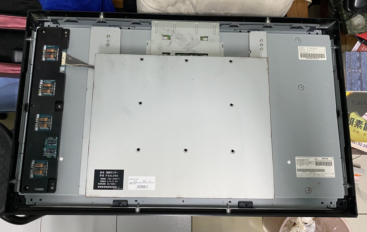

I really don’t know what’s the issue with my type P32L050 monitor.
I even can’t find any “FANS” behind the monitor.
Please help me!

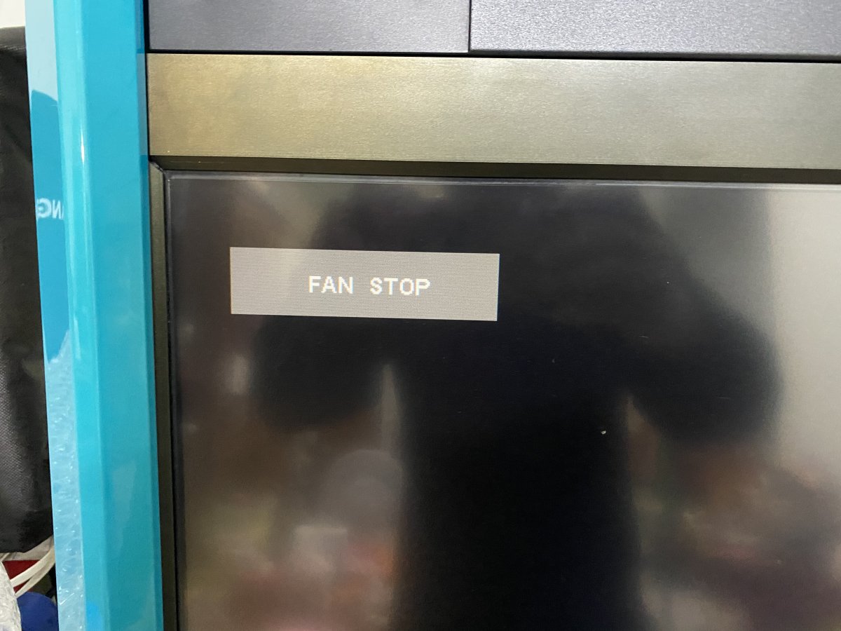

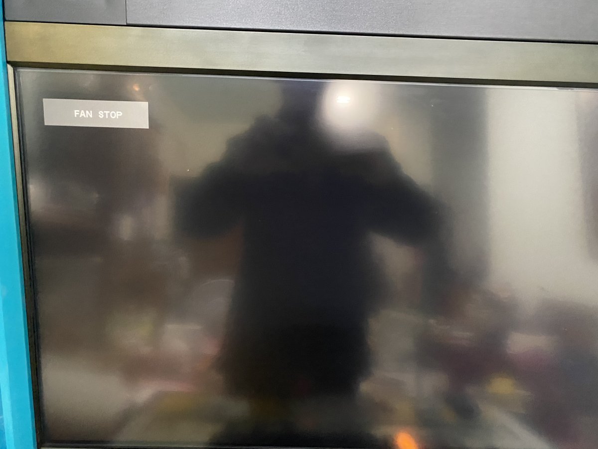

Is your error message on the top left or bottom left of the screen.
From what I've gathered chasing errors on my two cabs, top left is a problem with fans inside the lcd screen itself, bottom left error msg is for the fans powered by the cabinet.
This is only my experience working with F and FC monitors, take with grain of salt.
Like this.
