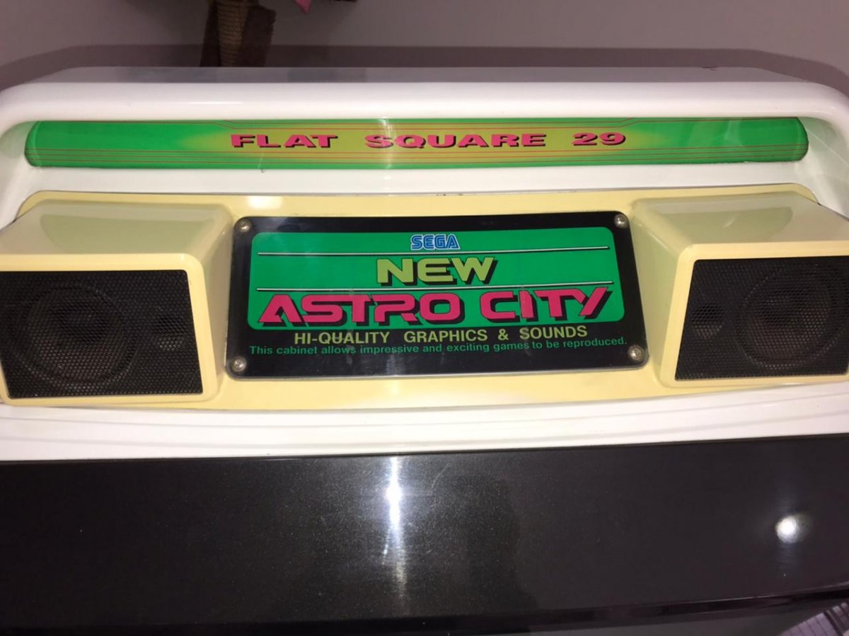

1. Speaker part at at the top - Yellowing
This part is plastic and I believe it can be retrobrited or repainted. I haven't done either of these myself; I think other members can give more details.

1 - Top marquee is in good condition besides yellowing.

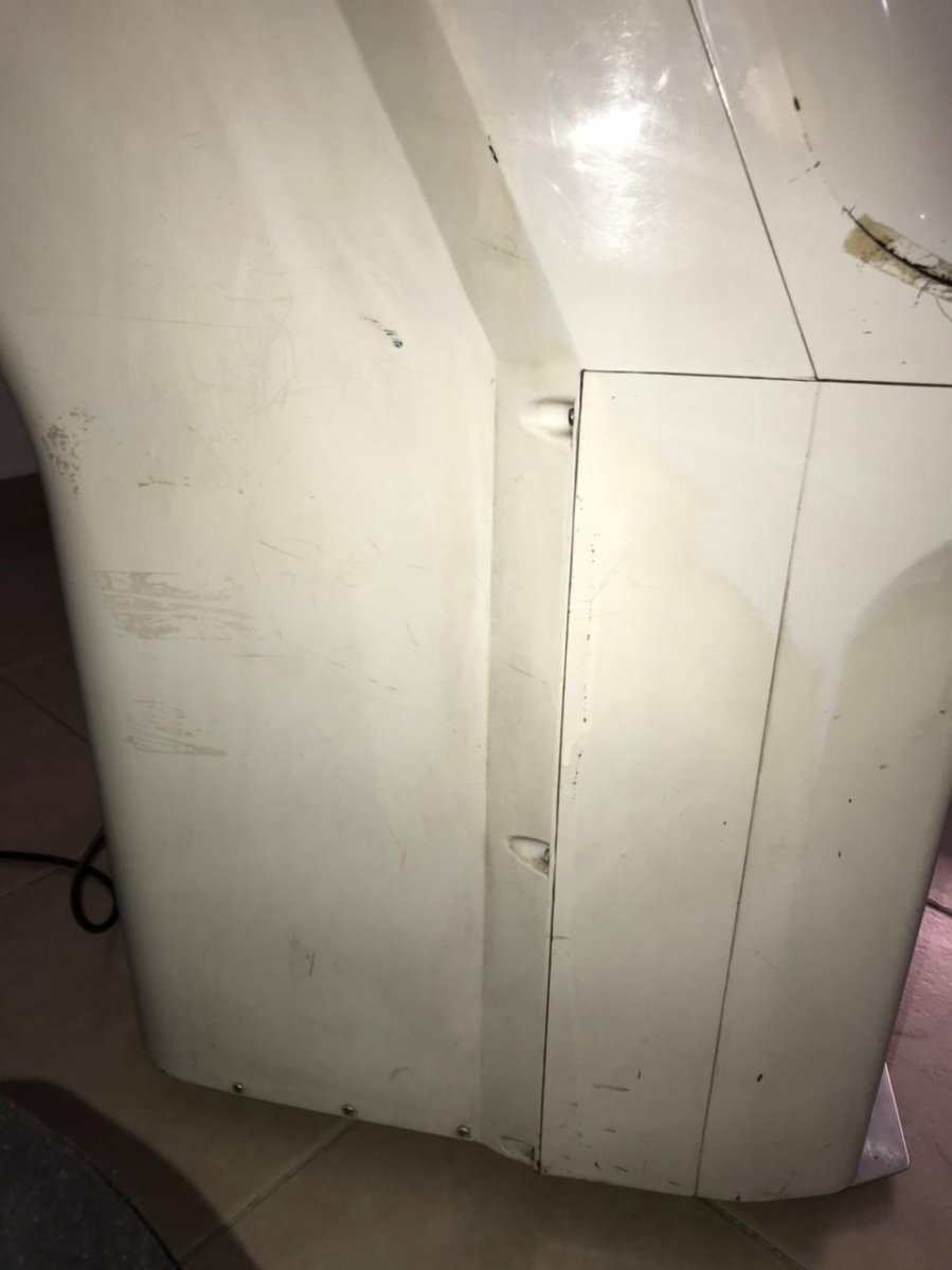

2 - overall paint is in so-so condition but not terrible, scratches all over the body is understandable.
Left art if missing
3 - I will need to get repro side arts for sure!

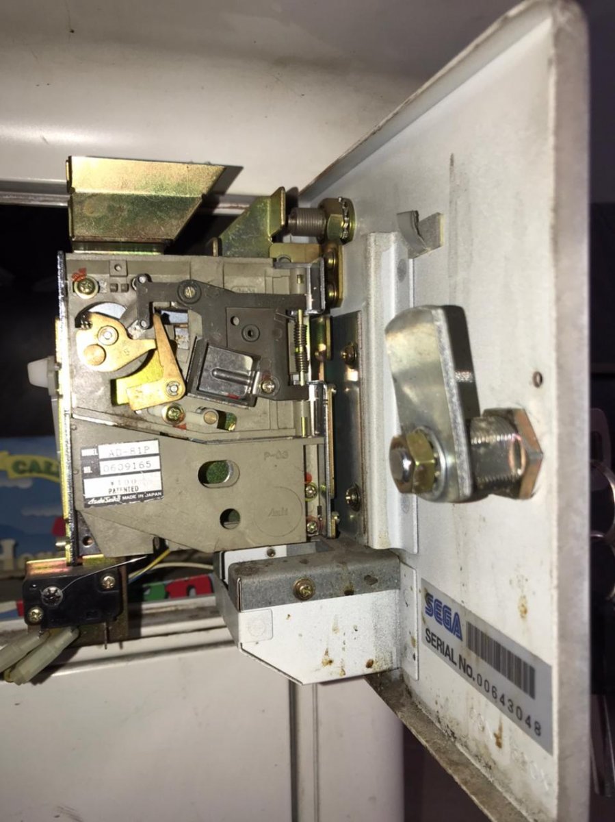

7 - Only keys i got:
Locks:
CP Locks are there but do not work properly
PCB main door lock not working
Coin Mechanism is working and lock works
Coin bucket is unaccesible due to missing key

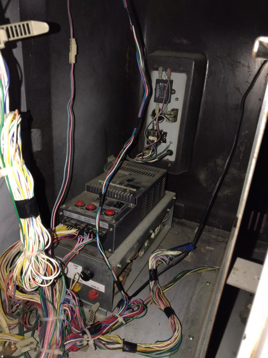

9 - Original PSU (thank you jesus!) and pre amp in there
For some reason speakers are routed directly to the jamma (not the preamp).
Kick harness is included
Marquee light not working but tested the sockets and voltage is ok (ordered a new tube from amazon).

If it's a normal Astro or New Astro amp, the speaker amp is for stereo games (which have non-amplified outputs, like RCA connectors for example), and you'll need to move the 4-pin speaker connector over to the JAMMA passthrough for JAMMA games (which use amplified outputs; the amp is on the PCB itself in the JAMMA spec, so the Astro wires the speakers in mono series when connected in mono mode).
So when switching between stereo and mono you need to move the connector back and forth.
If it's a non-standard amp setup though it could be done totally differently in terms of wiring, but it's still worth being aware that different games may handle audio differently!
If you take a picture of the internals that could help identify what's going on.
When you say that the CP locks "don't work", what do you mean?
Sorry for the late reply @Softdrink:
Here it is:
Thanks!
Juan
Nice, it's got the stereo amp in it!

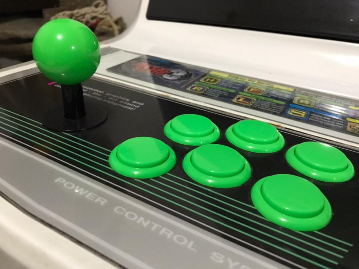

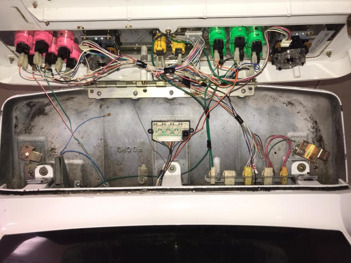

So yesterday i received my new joysticks and buttons kits that i ordered from amazon (Sanwa JLF),i went for green and blue as the pink kits are sold out and buying separate will come out more expensive...for now im ok with that as the colors are very nice.
Buttons and joysticks snapped perfectly in place!

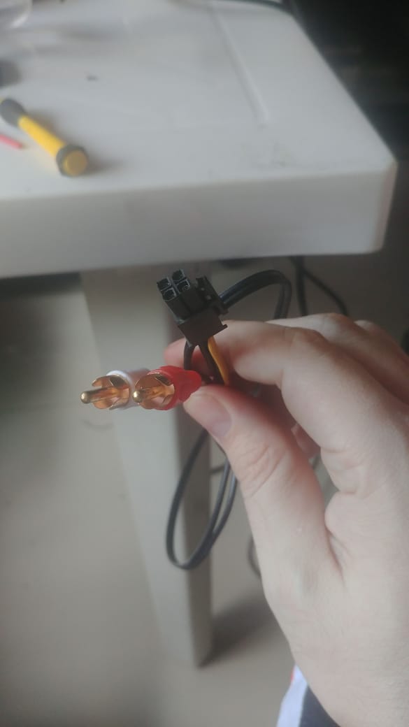

Hey Juan, I made an adapter for the same amp, it works great! pinout is ( R- R+ (top row)
L+ L-) (bottom row)

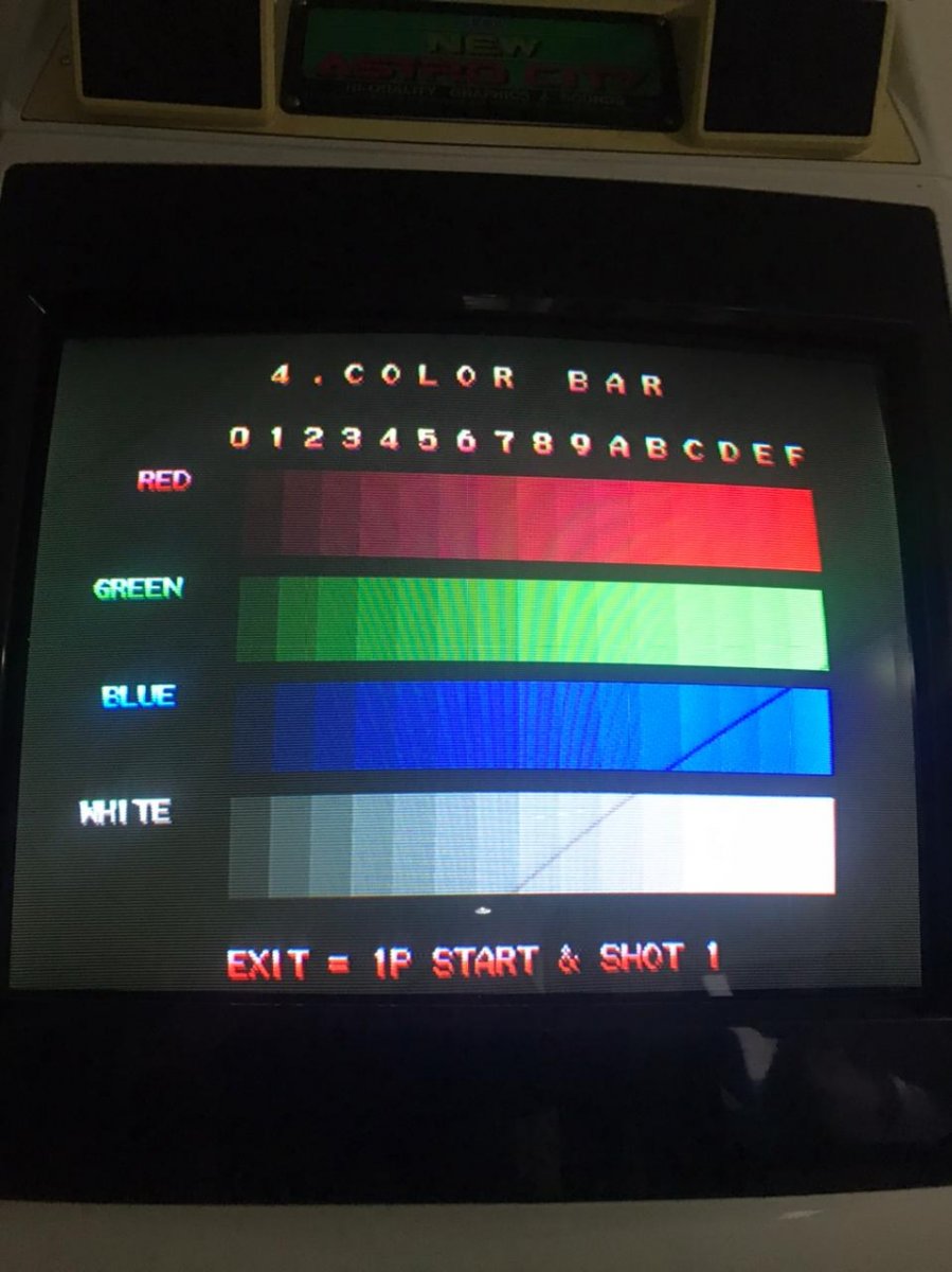

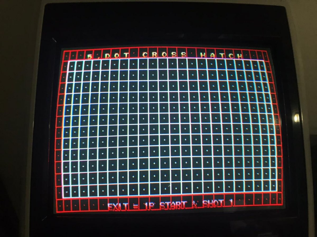

As previously stated i have some issues with the current geometry and colors, here are some examples:
1 - Red colour wash out in the middle of the screen, off course this is only very noticeable when a full red color occupies the middle center screen in a circle like shape and stays long enough for you to see it.
Color bar shows good colors but the red does not takes the spot were the wash out happens.

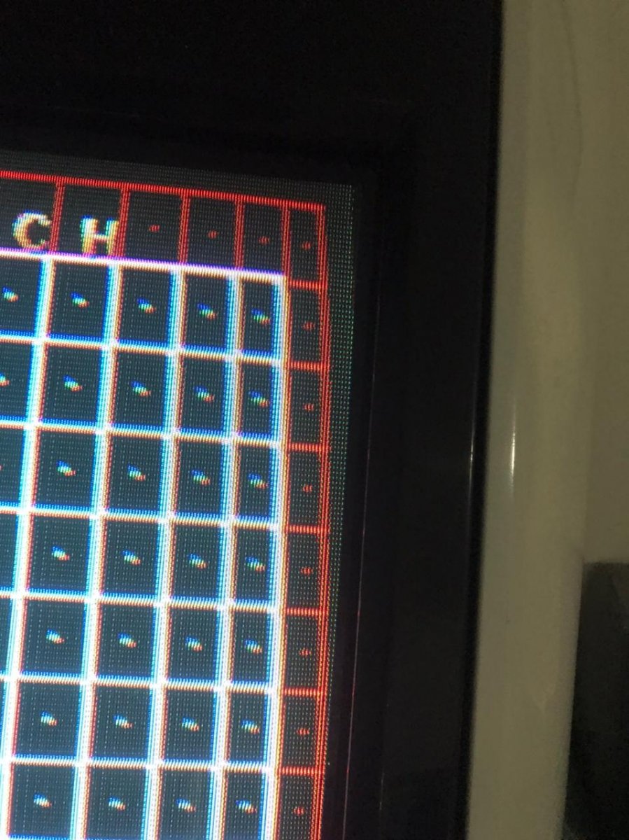

2 - Geometry.
Overall is ok but i would like to fill the entire screen.
Mostly noticeable at the bottom and all four corners.
What do you guys think!?
Thanks.
Juan
recap the monitor first and then we can try to work with the settings... otherwise you are doing the setup in vain. make sure you b+ is right too before moving on to more settings.
