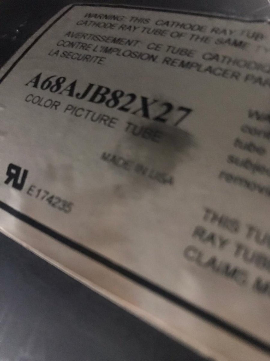

I finally moved to a new apt and some stuff happen, the arcade got here in pretty good shape but it seems during transport the ceramic resistance of the wey ya chassis snapped so yeah...bummer:
I've tried turning it on and everything works beside the monitor (no power on the tube but i can hear the game running in the background)
A month ago i ordered a Nanao MS9 but it idk if it will fit my tube, check pics below:

While i wait for the monitor to arrive from china i will start to dismantle the cab for a deep wash, im also looking for some auto repair shops that can work on the paint... i would appreciate advice on that topic tho.
