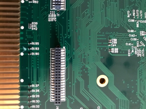

sorry if its ad dumb question, but have you tested with a multimeter if the trace is really cut?
Just to be 100% sure...
I guess that several blows of cutter is enough...
How can I test the trace with a multimeter? To be clear I am not a professional into electronic stuff, be pedagogue please :D .

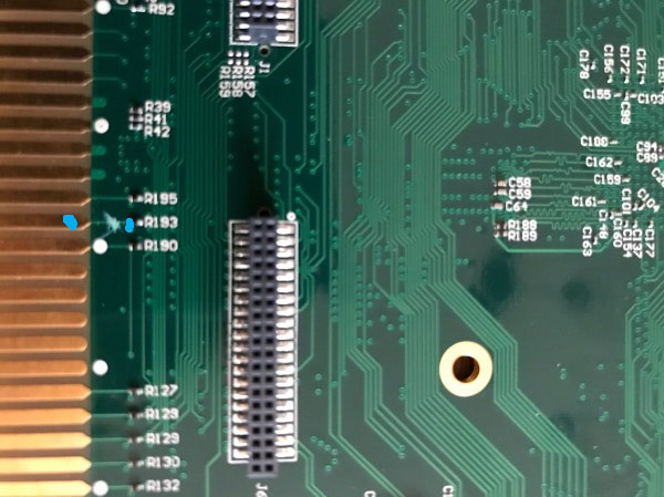

no problem, i'm a chemist :D - on my multimeter the function i used has a symbol that looks like the wifi symbol on a computer - now when there is a connection between both probes it should beep.
put the probes on the blue dots and if it beeps the line is still working

What do you mean that the meter is stil measuring 5.27?
To cut the trace is not going to reduce the voltage the MoBo sees.. For that you need to turn down the voltage in the PSU.
5.27 doesn't sound like a comfortable voltage in any case.. I would turn it down to 5.0x maximum...

no problem, i'm a chemist :D - on my multimeter the function i used has a symbol that looks like the wifi symbol on a computer - now when there is a connection between both probes it should beep.Untitled-1.jpg
I can test it even if the card ins't powered?
I can't test it if it need power due to accessibility.
