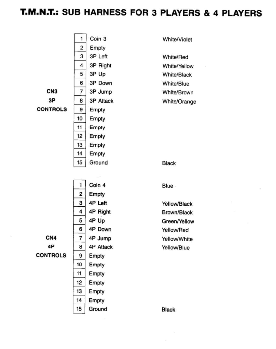

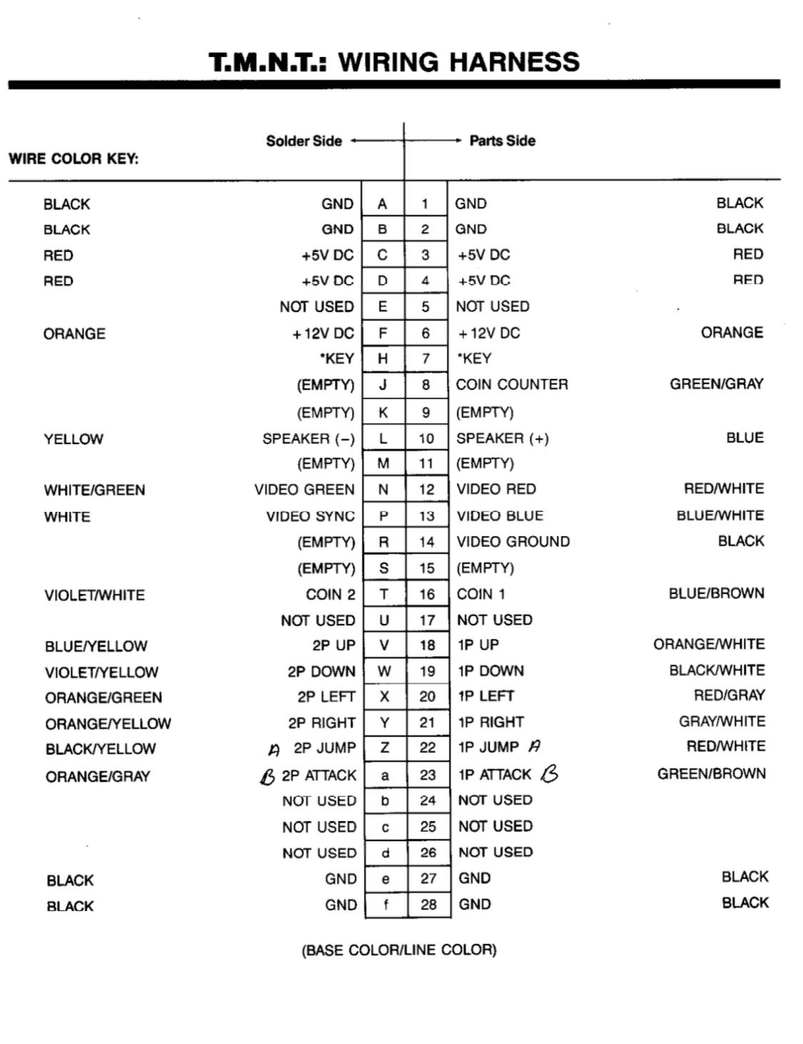

@[SIZE=2]@MoppelTheWhale[/size] I'm confused now. Coin for 1-2 player is on the JAMMA edge and for 3-4 on the aux connectors on the PCB, so this really comes down to your 3/4 player harness wiring. You could map some buttons as button 6 and use the outputs to add coin for 3/4 players.
but many cabs that are not dedicated for these types of games only have one coin chute (p1) - that means if i want to play on 2 player cab with arcade sticks on adapters for p3 &4 i can only coin up player 1,3&4
but many cabs that are not dedicated for these types of games only have one coin chute (p1) - that means if i want to play on 2 player cab with arcade sticks on adapters for p3 &4 i can only coin up player 1,3&4:)
Makes sense, I'll add remappable coin then :)

Another edit(brainstorming :D) @MoppelTheWhale @xtrasmiley - what you need is Coin2 for the TNMT, right? Can you think of games where Coin1 would be useful to have as one of the "action" buttons?
tnmt is the one usecase i have atm, i would think the other konami 4-player game of that era might behave the same - some other people can chime in on this... from what @opt2not wrote on another thread it sounds like he has some of the other games...
How the the 4player games on cps2 behave i don't know, but they have coin chutes for player 3&4 and start buttons wired on the 4player harness
Thanks. So from what I understand, some cabinets only have one coin chute, so you can't select the character nr 2 in some Konami games.
I think I will add a jumper/physical switch to enable the coin remapping, since the RECO is also used by the arcade operators - you don't want people to add coins by just pressing a button.
3/4 player games rely on the harness, so this isn't in scope of the RECO (harnesses can be wired to whatever you like).
yeah all the Konami 4player beat-em-ups use p1 coin for position 1, and p2 coin to position 2.
p3 and p4 use the sub harnesses for those positions. Aka , characters.
