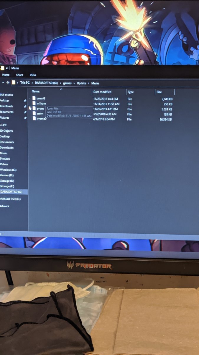

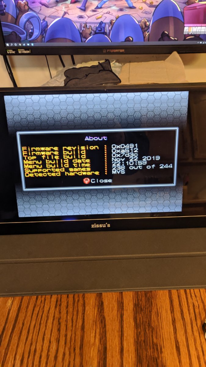

So this is the latest current firmware. I extracted and placed the previous firmware as instructed in the update folder and the menu files in the "menu" folder. I cleared the nvram before placing the cart back in then inserted the cart with the micro sd but the cart didn't downgrade the firmware and the files are still on my microsd card and they're supposed to be gone if the update was successful.
Christ what a dounce I am...Thank you.
Ok so I downgraded successfully let's see if I can actually finish a game of samurai shodown
So before I started the game I'm not getting any sound in the menu or in game. I cleared the nvram again before the successful firmware downgrade. When I try to change the menu music I get "z80 error". Foregoing that, I played the game to completion with not a single crash I could never even get half way through the game before a crash. But I can't stay on this version with no sound...any idea of the z80 error? If not it's ok I can at least confirm your previous version plays the game with no crashing.
