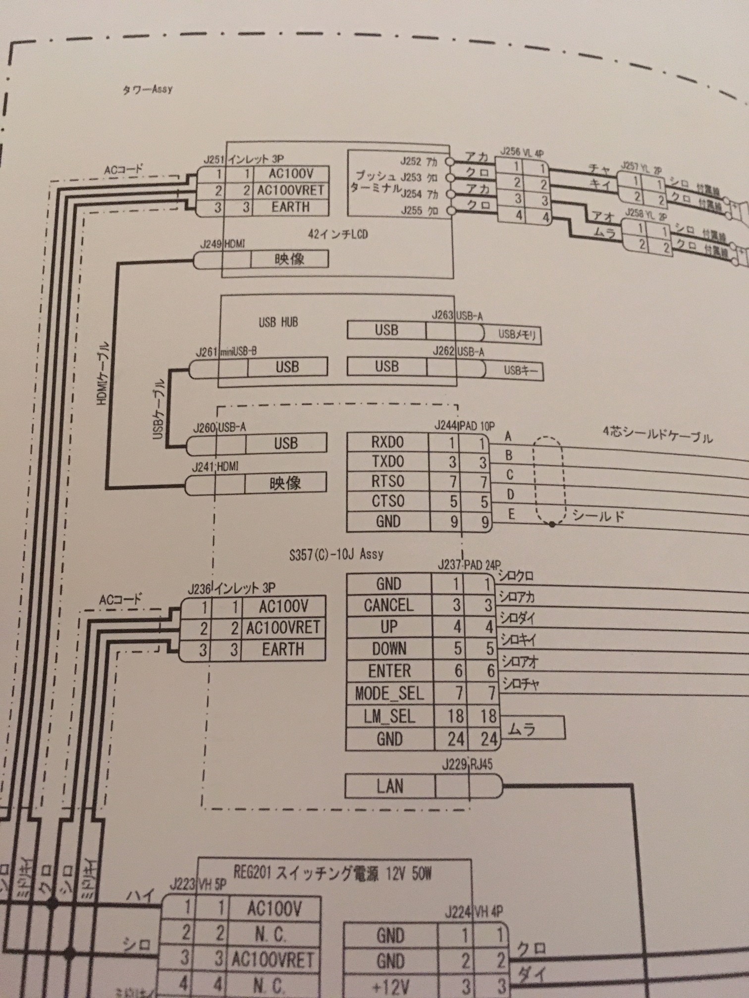

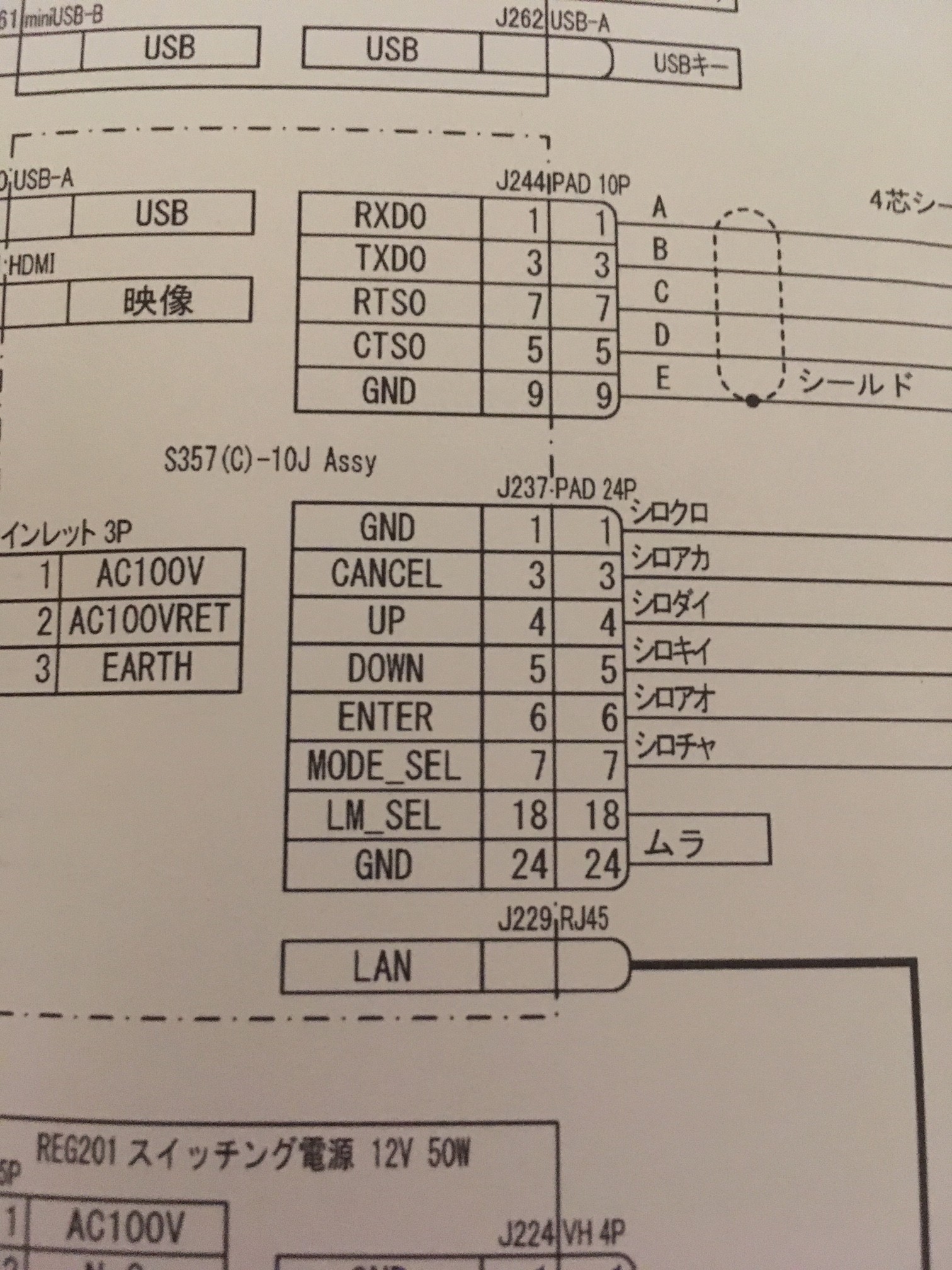

anyone know if this live monitor jumper matters. i found this on the manual also found the wireing harness has the same jumper

Hello, I just need to change this 5 to 1, right? thank you
