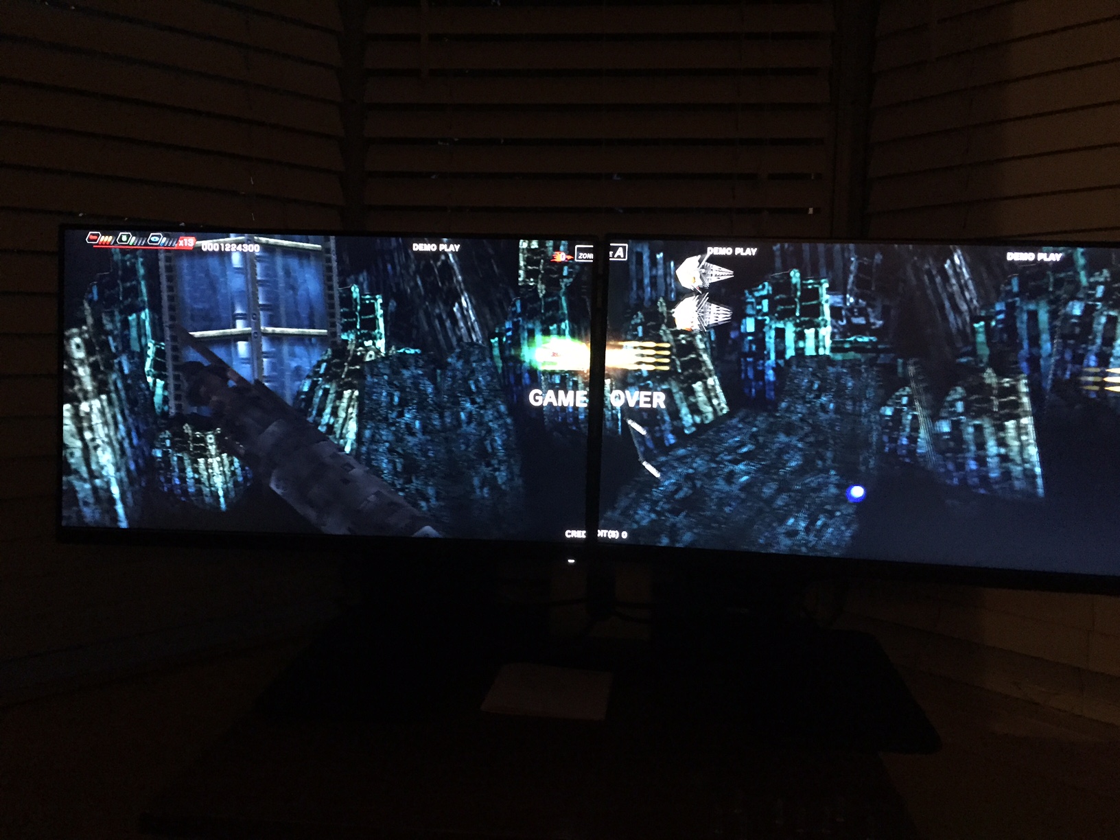

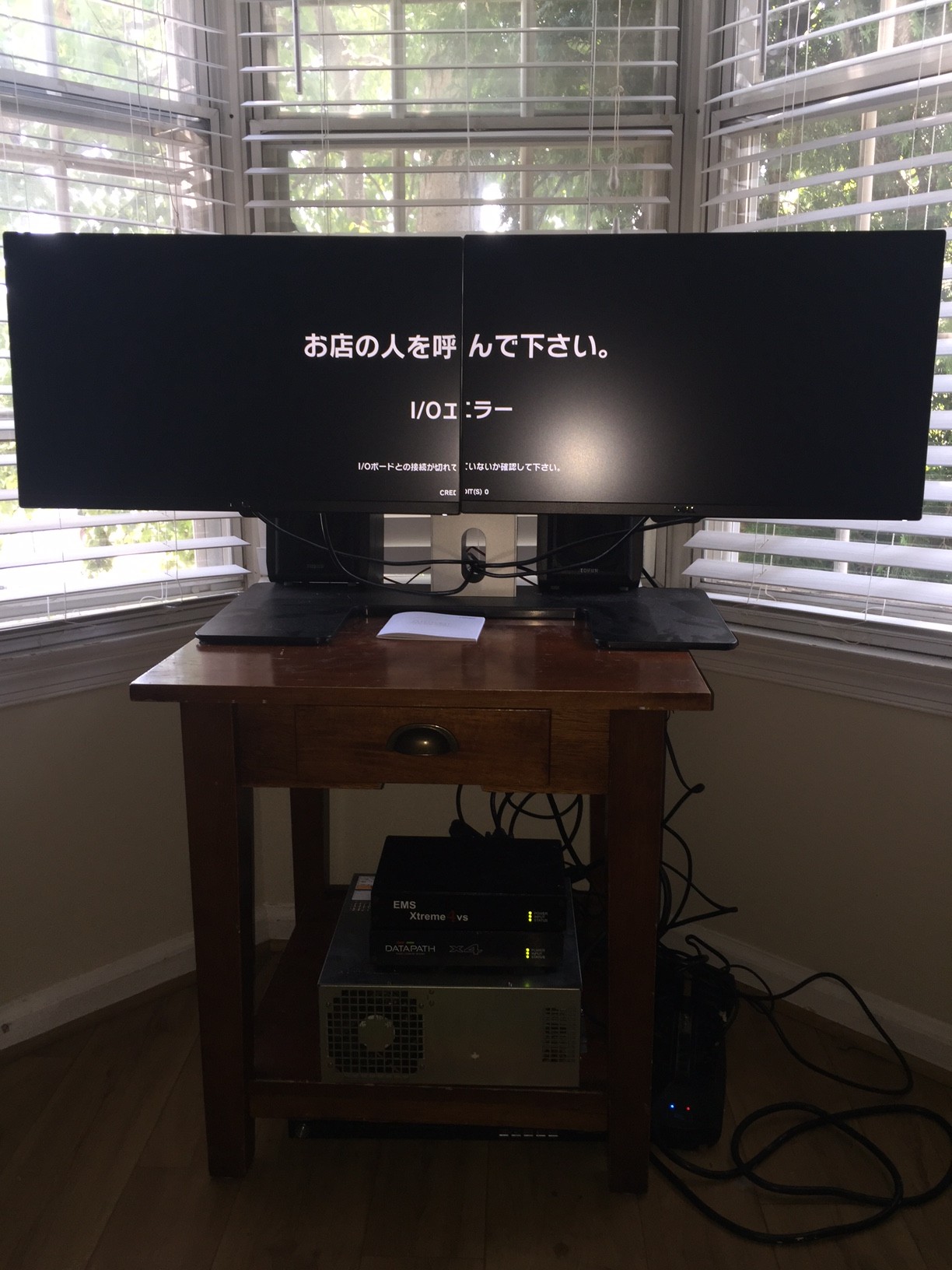

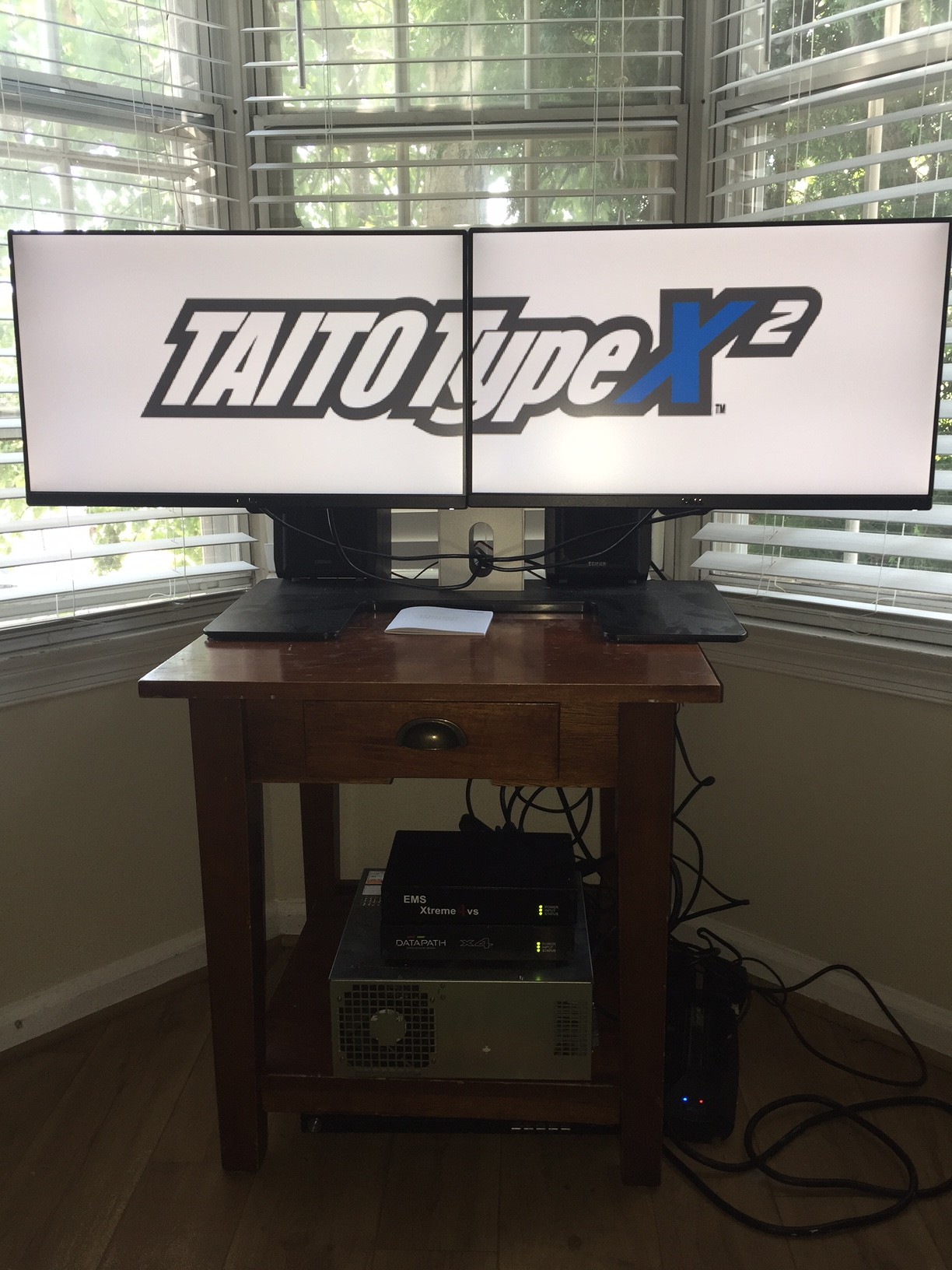

@SNK-NEO-GEO what are you using to flip the 2nd screen? Or did you modify the exe? 8)
I am using the detapath X4 device to flip the screen, Corey looked into flipping the screen but it could only be done on a window based and not full screen.. my understanding is that the datapath x4 adds 16ms of lag.
Good info, thanks! 1 frame input lag doesn't seem like it's the end of the world, especially with low latency monitors.
The monitors that I am using are fast so it should be ok..I will report the end result soon..the fast I/O box is on the way; it has taken handful of people skills set, knowledge and time to get the game on a "console" form. It is well documented if anyone sees magic on this game and wants the same setup..the downside; it is not a cheap project.
