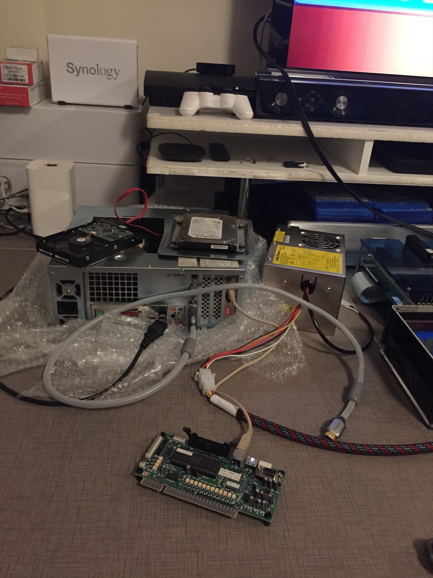

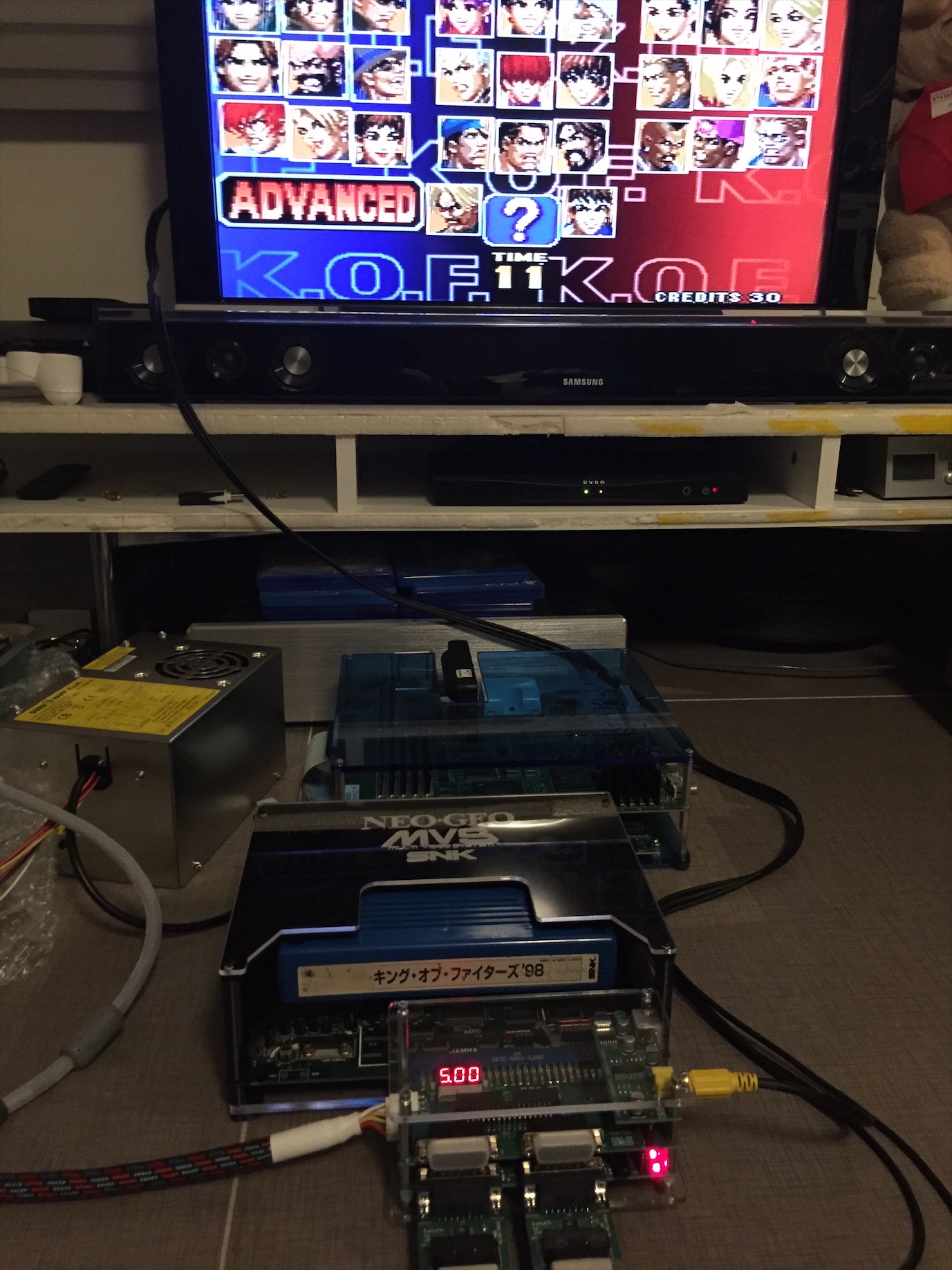

My MVS is ready for darksoft mvs multi :P . Just finish to test with taito type x2 multi and the jvs I/O work great with HAS.
But after a few in and out of the Jamma connector, the edge of it is already broken, so I strongly recommend the use of a Jamma extension harness to connect the HAS.
Will test a sega model 3 setup later.
