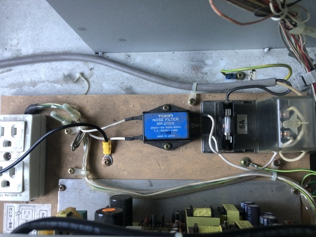

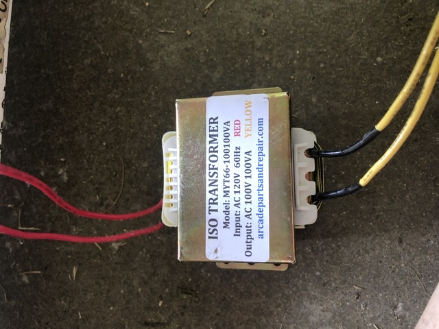

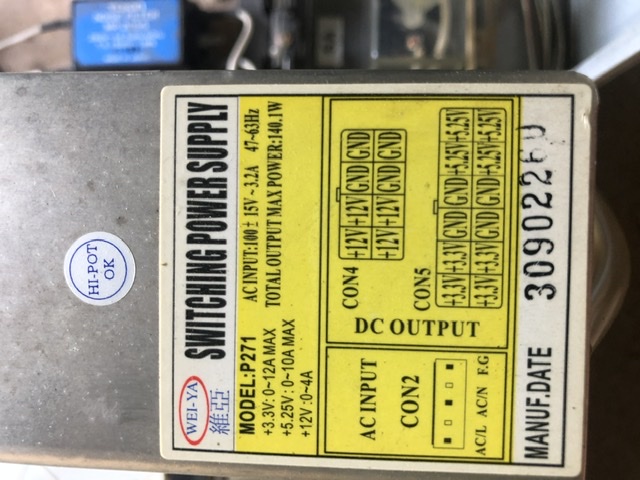

Hi Everyone!
I just received the iso transformer, and in all honesty, I’m a tad overwhelmed here .
I’ve posted some pictures of the current setup along with a picture of the isolation transformer. I know it’s a lot to ask, but if someone could be so kind as to point me in the right direction. Sadly, I have no idea where to start.
Thank you so much for your help. Sorry to be a bit of a bother.

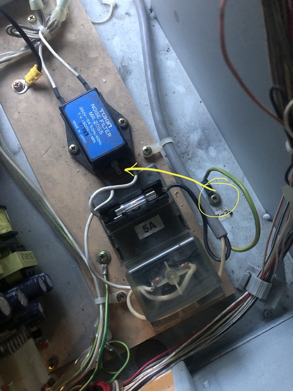

Ok, I’m beginning to make a little headway following the Bob Roberts guide. Quick question though... Referring to the picture below, B Roberts guide says I should attach the earth ground from the ac cord to the middle prong of the ac filter. Does this look correct, and should I do this instead of leaving the earth ground attached to the designated ground screw on the floor of the cab?

it looks like you got a 120vac input iso with 100vac output. I don't know what your manual said, but I think you need a 1:1 isolation transformer that does 120 input and output.
Once you verify you have the right input and output voltages just hook up the iso to the plug that's already there for monitors. plug -> iso input -> iso output -> monitor input. (do some voltage checks along the way before plugging into the chassis).
the switching power supply is already hooked up to ac. it looks like it has an output too which could probably be used to feed the iso as well, but no reason to do that. I would try to use the existing stock wiring as much as possible.

leave it where it is. the line filter in that cab is sitting on a nonconductive piece of wood. it kind of depends on a few factors but metal candy cabs should be earth grounded to their chassis. sega astro city cabs have the ground symbol next to a threaded post on the filter board plate.

Your 120VAC to 100VAC transformer would have been fine. The chassis is expecting 110V. 9% difference would be in tolerance. What voltage are you getting out of your outlet in your home?
As far as grounding you can ground anything that needs it to that floor screw. Then take an ohm meter and make sure continuity exists between that ground screw and the ground prong of your AC Cord.
@nem 120v ac comes out of the outlets in my home. That iso will work?! Dang, just ordered another one, lol.
I agree that it would have most likely worked, but he is trying to get this set up and understand how/why it works this way. I want him to know what parts he's picking and why... It's better to set things up the "right way" and not just settle for "what works" imo. It doesn't hurt to have extra isos around either.
