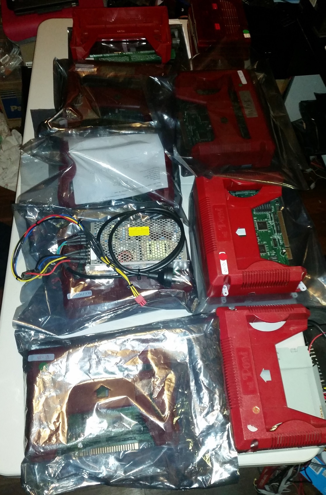

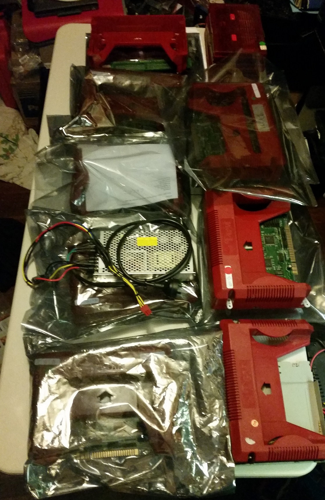

Trying to get ALL "Batch 2" PGM Pre-Modded Motherboards i sell out to custmours ASAP....
A table of PGMs i'm working on.....
