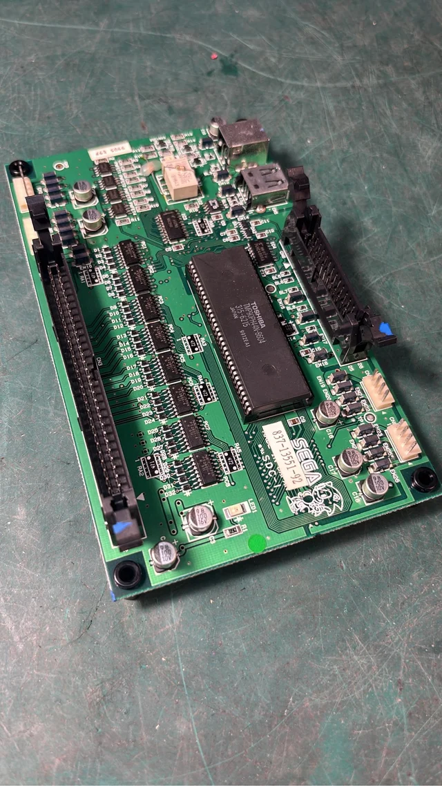

so far I just had the NAOMI MOBO and everything went perfect but with this new "solution" I feel a little (just a little) lag
mine is this one:
From some light googling you should be able to swap to: 837-14572 but I am not an expert on this cabinet 😅
