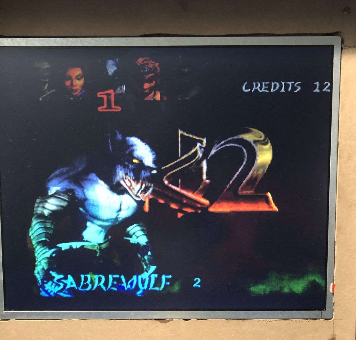

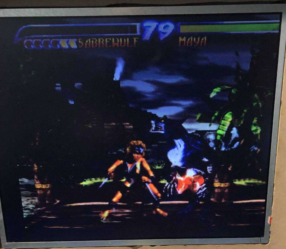

Here are a few screenshots
One is in motion of the game but u can see the video is just not what it should be
It looks very dark to me and it is off the the right for some reason
My MK 1-3 boards play and look perfect on this monitor

Well the clamp st and clamp sp settings seemed to fix the video
I have them set like this now:
clamp st = 1
clamp sp = 5
I still have an issue with the video to the right by about an inch - not sure what is up with that
