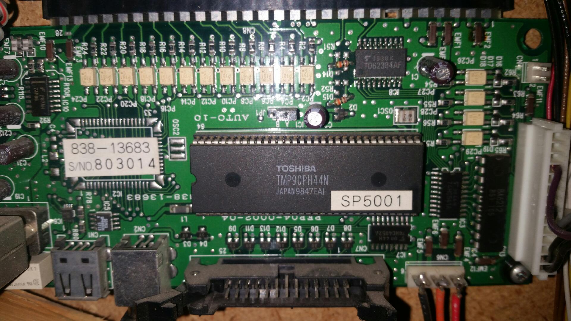

post a pic or a link to the pic of the IO that you have. If it's a Capcom JVS that behaviour that you mentioned rings a bell.
Here's a shot of my I/O board.
