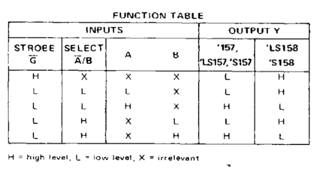

OK... then check pins 7, 9, and 12 of the 74LS157 at 8M. What are they doing?
