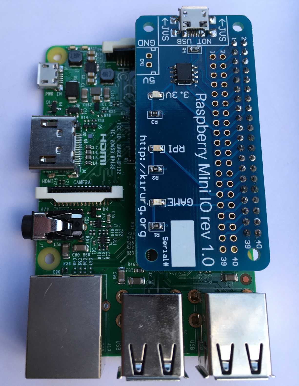

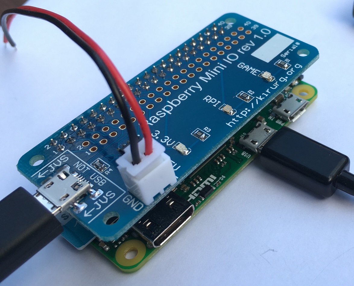

Nothing like fresh HW - couldn't resist and stopped by a local store and picked up two ridiculously overpriced header connectors, everything works :) Tbh, this is the simplest design I have ever done, but always nice with a successful 'bringup'. Was particulary happy with the micro USB connector - as I wasn't quite sure the type I ordered were 1-1 copies of the brand-name type I used when designing.
A couple of pics, the thing is tiny :)
The first run will be 28 boards. What do you guys think of the power connector - it will power the PI for those that are inclined to not use a micro usb into the PI to to that. I'm a bit tempted to either just leave the footprint there, or supply the connector unsoldered and a cable like in the picture - that way I can't really be blamed in case someone blows up their PI..
first run will be 27 boards now ;) One for me please :)
I want one of them please :)
Awesome work. Thank you....

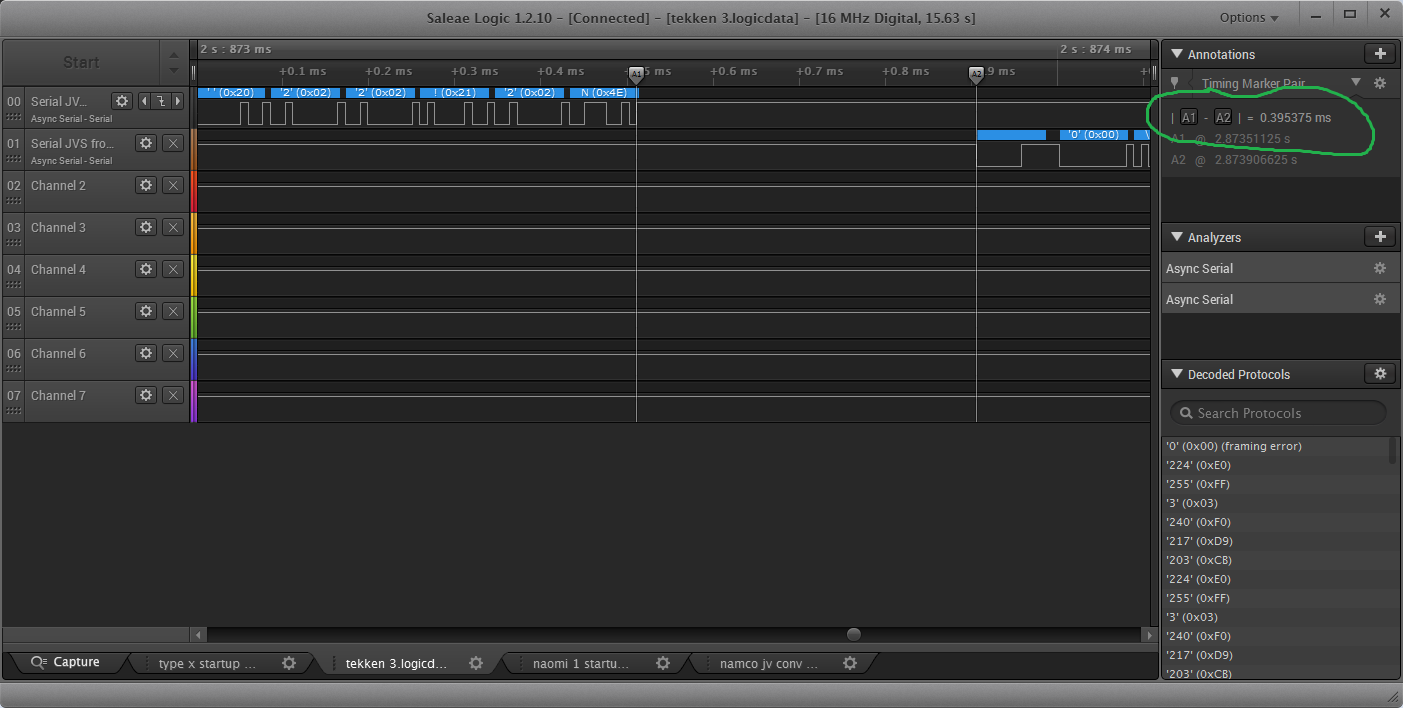

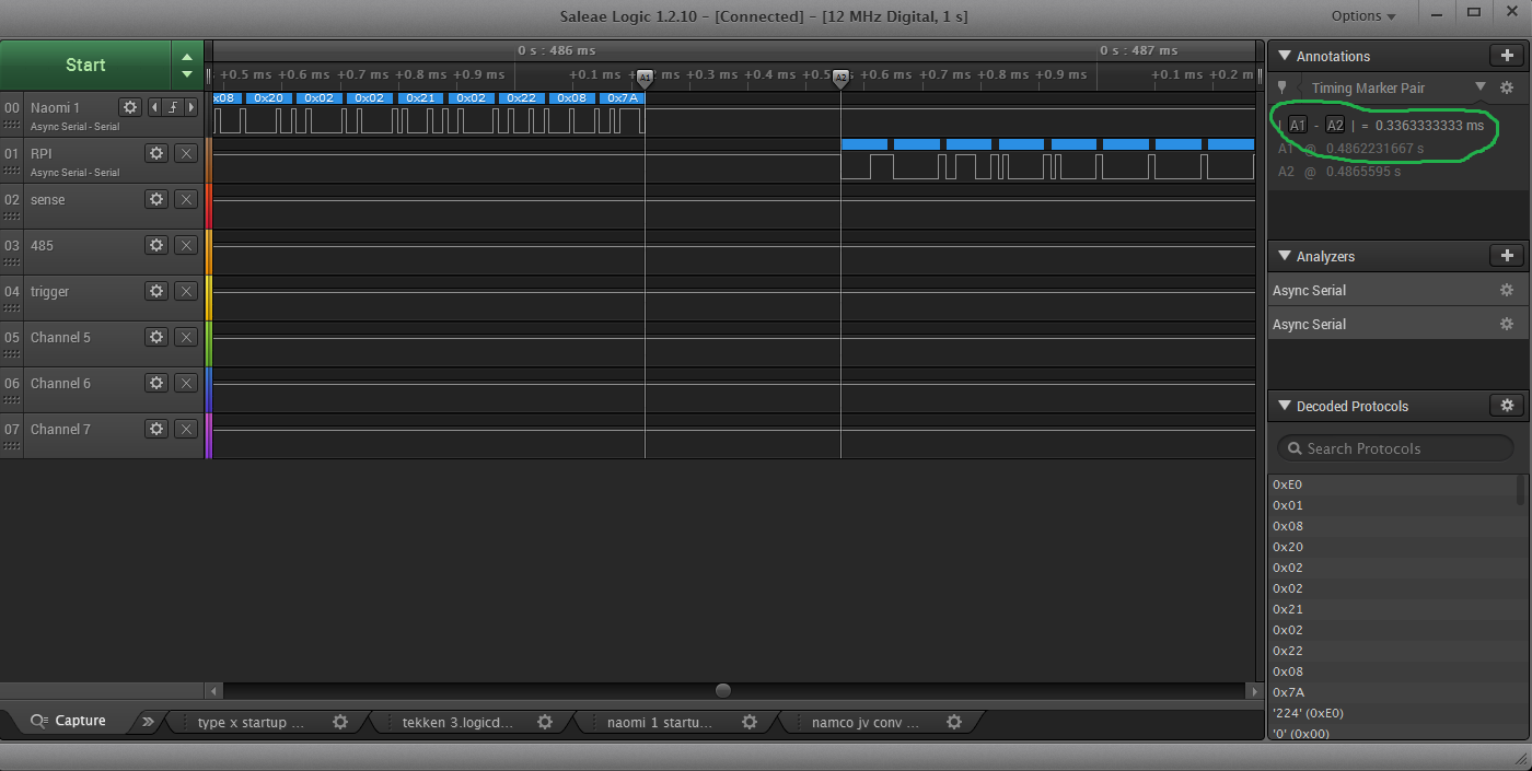

It's not ready by a long shot, there is quite a bit of 'user logic' that needs to be put in place for it to work like an appliance. In the meantime, I took a capture using my LA for those that asked about lag:
This is a capture going in/out of the serial transceiver, top is the request from the game, and the second is the response from the raspberry.
This is a capture of a Sega IO (one of the jamma versions) for comparison.
This is from a raspberry Pi 3 - but I expect similar results on the zero. The JVS daemon is writtin in C, runs with real-time priority and accesses the UART directly, and besides, it's not exactly number crunching going on. In any case, well within spec :)
Fast PCB turnaround there- looks great!
I'd either leave the power plug off, or switch it to a side entry type (side-entry package won't fit the board silkscreen template you're using quite right, but it should work...
Either way, put me down for two as previously mentioned. (unless you have a limit of one per)
