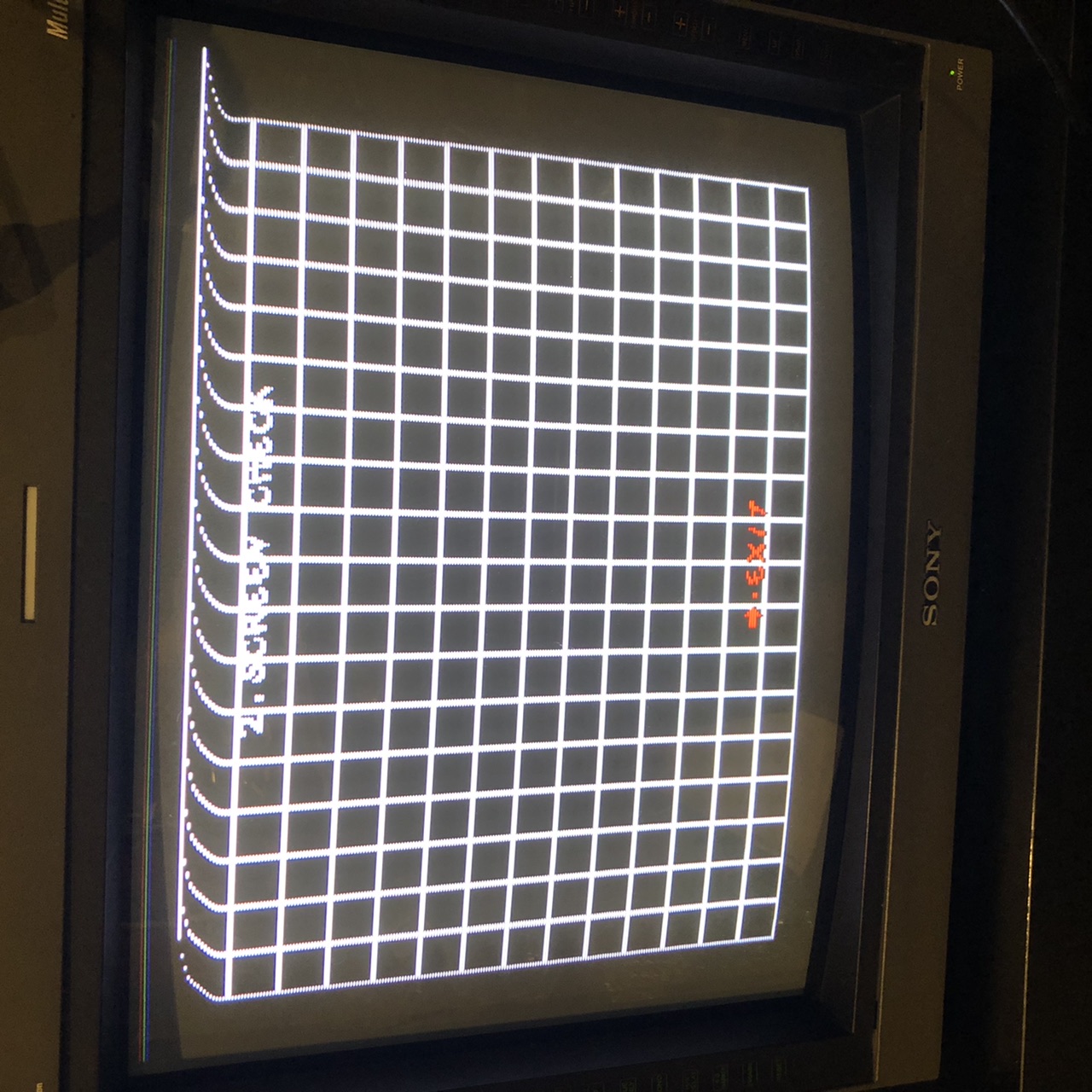

Apologies if this has been asked before, but is there something special that needs to be done with the sync signal on Konami PCBs? Both X-Men and The Simpsons have an odd horizontal alignment issue at the top of each frame when I connect them to my minigun, but no other game PCBs that I’ve tested do this.
I've seen similar issues with some arcade PCBs and game consoles work my setup. I use an Extron RGB 203rxi to fix it.
