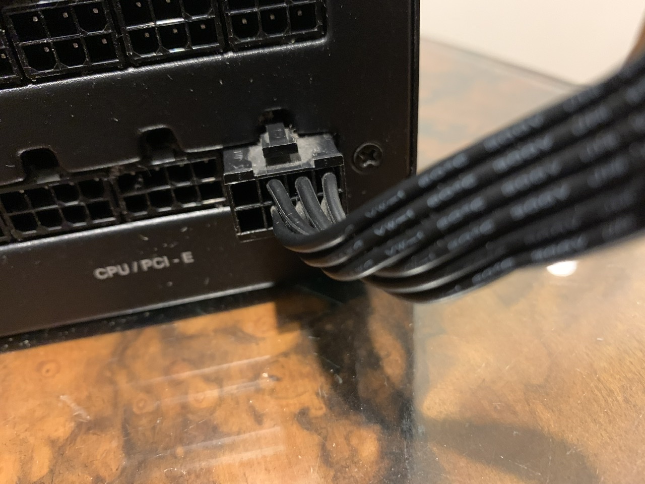

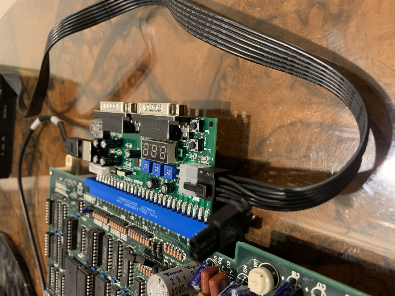

Do you have a picture of the cable you’re using to connect to the PSU and also a photo of how it’s connected?
Sure do, appreciated.
I believe it’s the same cable I power my GTX 1060 with

OK. That’s the issue there. You need to make a custom cable that follows the Minigun pinout, it doesn’t use a standard ATX cable.
The underside of the Minigun PCB shows you what voltages are for each pin. Just wire up a new cable, or repurpose your existing one with the correct voltages and you should be good to go.

Also, if using ATX you may need to bridge the PS_ON pin to ground to get it to power on.
Depending on what voltages are present on that particular connector on your PSU, you may need to crimp a ATX 20 pin on the PSU side.
@dan-esc in the following thread you finde the minigun and cable pinout: MWP-606 Power Supply Cover
I would suggest to test the voltage level on the jamma connector before you connect it to your PCB.
Most power supplies will not output good voltage levels without a significant load on the outputs.
