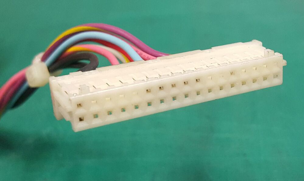

Here's a question I know I haven't asked lol, do you have to plug the kick harness into the Supergun? Or can you go straight from the CPS2 to your buttons while using the supergun? My DB-15 P1 and P2 ports will be going to an arcade panel, instead of using a conversion for pad/fightstick.

The kick harness goes from the Supergun to the CPS2. That's simplest.
In a real cabinet you would wire the kick button micro-switches to the kick harness on the CPS2.

This will be going into a cab I built, yes. That's why I was curious about my options for the kick harness. For me it would be easier to go straight from the cps2 if that's an option while using the supergun

It definitely is possible. As long as the circuit is closed, the input will register. Just make sure you get the proper pinout for the CPS2 side.
I recall that I had some confusion as to the orientation of the pinout diagram. I wasn't sure if ground was on the left or right. You don't want to get that wrong.

Sorry idk why that didn't finish, that should have read "some special connector from the CPS2, to the supergun.". But as long as I can come out the the CPS2 directly with the kick harness and still use the supergun, that's all I need. At least for this project.

You have the kick harness for the CPS2? You can rig something if you don't, but the real harness is best.

Like the Jamma Harness? Yeah I have that, it's just figuring what I'd need to put the rgb cables into an ossc
No, there is a kick harness that connects to the CPS2. It is separate from the JAMMA harness. Do you have the CPS2 yet?
It looks like this:
Do you have the 9pin (Genesis 2) minigun?
If so, you can go via scart or component video to the OSSC. Scart is the most cost effective method.
