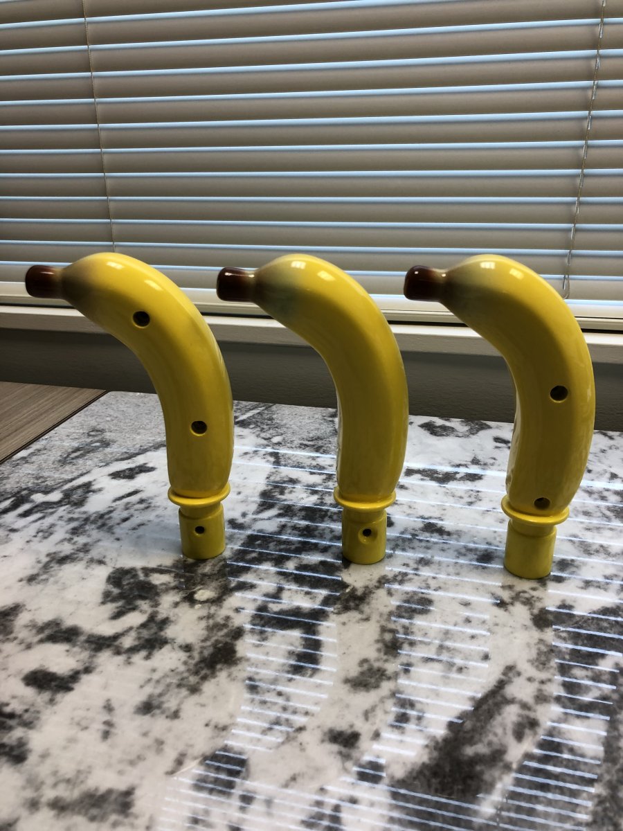

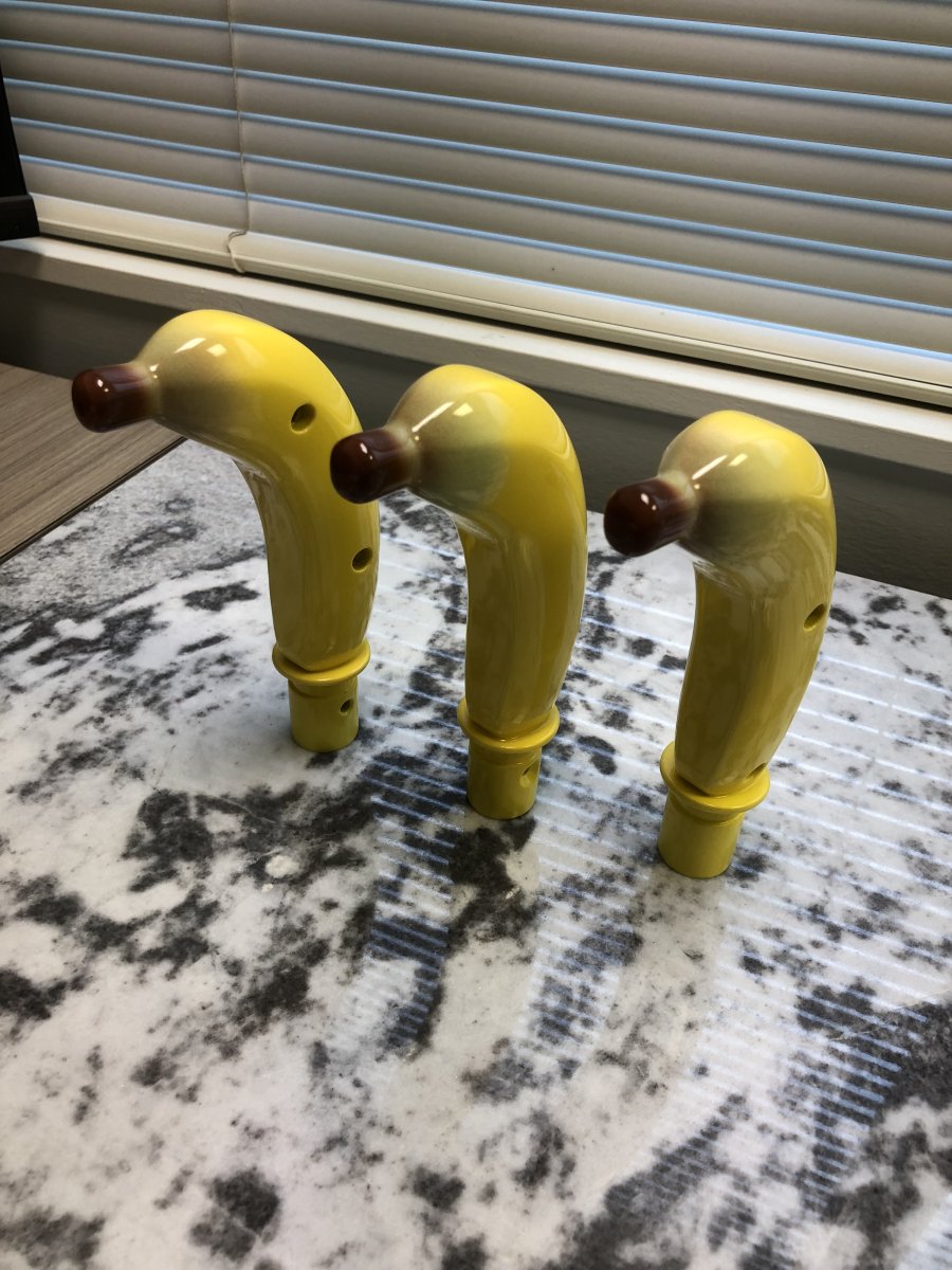

Ok Guys! We got 1:1 copies!! Available in 3 types:
Left- Gundam shaft (lower mounting hole will be counter sunk like the center one on final production)
Center- Gundam shaft no holes
Right- original Monkey Ball shaft
Credit goes to XeD for sorting out all the model revisions!
These are printed in one piece, the last 2 samples I posted were printed in halves then glued. I tested those with only one screw holding it to the shaft and the connector screw not fully tight, after 3-4 hours of normal play they began cracking at the base. I did this to see what would happen if the screws fell out or loosen over time.
One solid print is the way to go. Game is super fun!!
Anyways.. hope you guys are happy
Mirko

They look fantastic! The middle one with no holes is the go...
Any idea what the price point is?
$66 US each + shipping, XeD will start a new thread so people can order these but we are looking at options to save on shipping, I've spoken to @alberto1225 about sending me all the panels so I can ship out a banana and a panel to those who want both. there will be a harness as well. I'm still working out shipping costs and logistics. We have some Gundam sticks as well ;) so a full kit can be offered...
