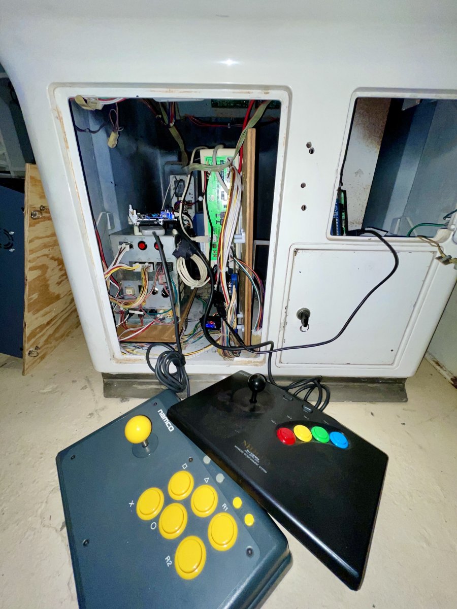

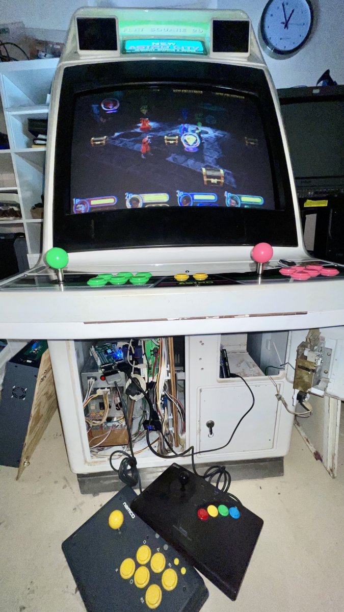

Wanted to create a post about playing Powerstone 2 on a New Astro City with three other players. I read a post earlier in this thread about how this is only feasible with the Capcom I/O and so I wanted to post about my setup.
I am feeding JVS inputs for players 1 and 2 to the NAOMI through the wonderful TD-IO and daisy-chaining the inputs for players 3 and 4 through the MultiJVS. Having the DB15 ports on the MultiJVS means players 3 and 4 can use a stick on their lap while seated around players 1 and 2 on the control panel. This was all plug-and-play and a great way to enjoy Powerstone 2.
