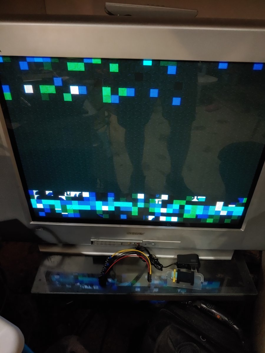

I left the mvs-1c powered on without a cart for awhile and this is what it started doing.
After rebooting it again, it gave me this garbage screen each time I rebooted it. Strange.
Yeah all of the listed other games work fully on the mvss-1c ONLY the garou doesn't.

I booted the board this morning and everything worked fine. I booted it without a cart and it went to the I/O menu and I cleared the RAM memory again. It appears to be fine, again, no luck with Garou. I did a continuity test on the cart slot to the underside where the pins were at and everything checked out.
