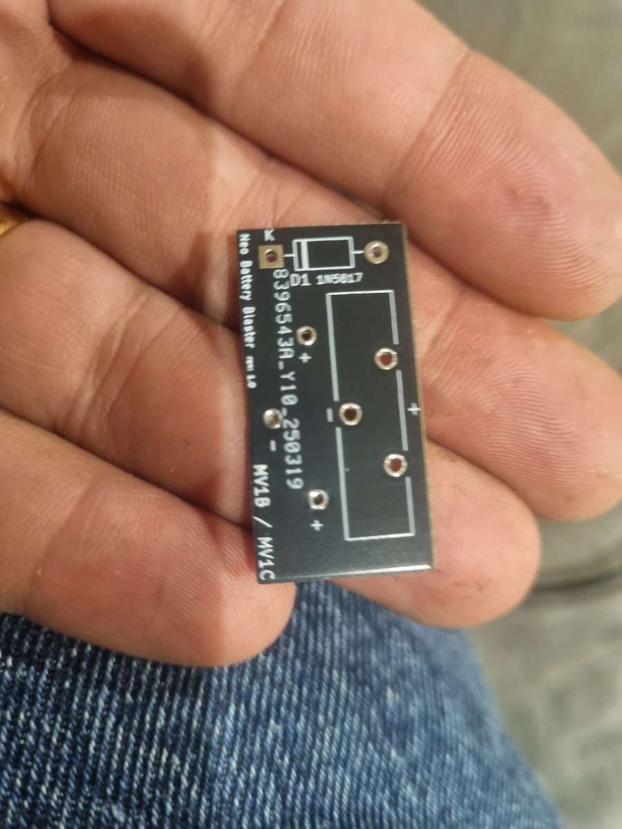

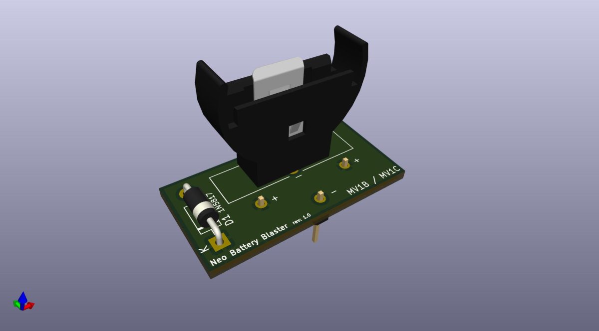

I was playing around the other day and considered this as a potential battery solution that didn't require resistor, diode or trace removal. It is based on a similar design I made for old 486 bios batteries., from an original design by scrapcomputing. Without looking in detail at the charging circuit of the MVS it looks like it will achieve the desired result there also. My question is... Good idea? Bad Idea?
Well, I’m not smart enough to know by looking at it, but if it works and is safe then yes it is a great idea and I’ll take 3.

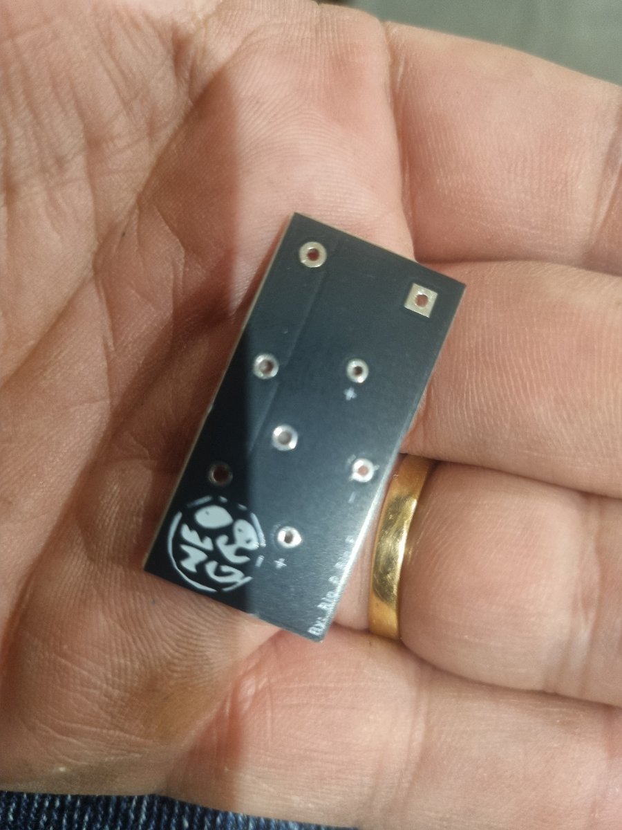

I have tested this off board and it appears to function as expected I'll get a few boards printed for a little longer term testing before I 100% decide that is a good solution.
I’d buy one from you if you end up making them available for sale. What an elegantly simple solution. I hate losing my high scores after days of unuse!
I have ordered the mini pcb and I'll put one together and run it I'm my cab for a bit when they arrive. If I am happy nothing unexpected happens I'll make up a few for anyone interested and likely open source the pcb gerbers.

Good to see it's fixed. I have had the coin cell and diode solution wired up on a bread board to my MVS for a while now with no negative outcomes.
I'll order a bunch of pcbs next time I put in a pcb order. I was going to order them but they are so small and shipping is almost as much as the board order.
If you're still running with this, I'd be interested in picking one up, too.
Yes I am. It's just such a tiny board that it really makes sense to bundle it together with another pcb order. I put in an initial order a few weeks ago but have made some minor layout changes because it extended outside of the mv1b footprint. But I should have these ready in a few weeks.
