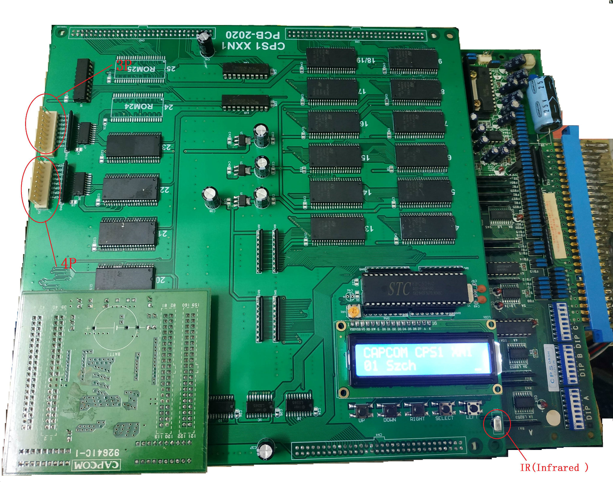

my capcom cps1 32n1
Not sure how the Lydz multi handles kicks, I assume on these 2 connections labeled P3 and P4
CPS2 only has one kick harness pinout, on the A board to the right of the JAMMA connector
Unless you're talking about the CPS changer/1.5 hardware?
i am referring to the hardware indicated in the topic of the thread.
There is a CPS charger version of Street Fighter Alpha/Zero that is included in this 32 in 1.
CPS Changer is Capcom's consolization of their CPS1 hardware.
Thanks.
Street Fighter 2 games use P3. I tried all the pins on P3 and P4 on alpha/zero and they didn't seem to do anything.
4 buttons are available by default.
2 punch + 2 kick.
Light Punch and Light Kick are missing.
I'm not a huge alpha/zero fan but I want to understand the unit and the is no documentation that i am aware of.
Probably some Chinese handywork where they didn’t include or map all buttons from CPS charger to CPS1 platform?
I’m not familiar with CPS Charger, any idea how these buttons are handled there?
On the filter board like CPS1.5
I'd hazard a guess they aren't connected properly on the conversion as you mentioned

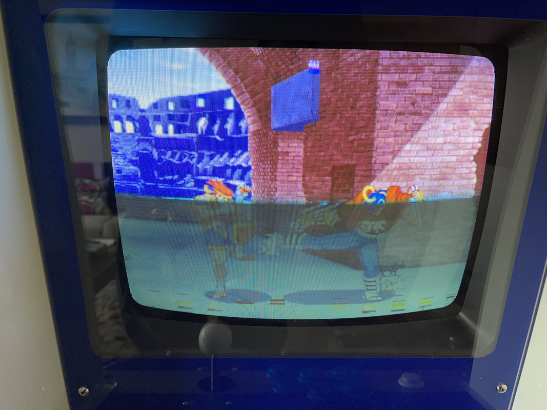

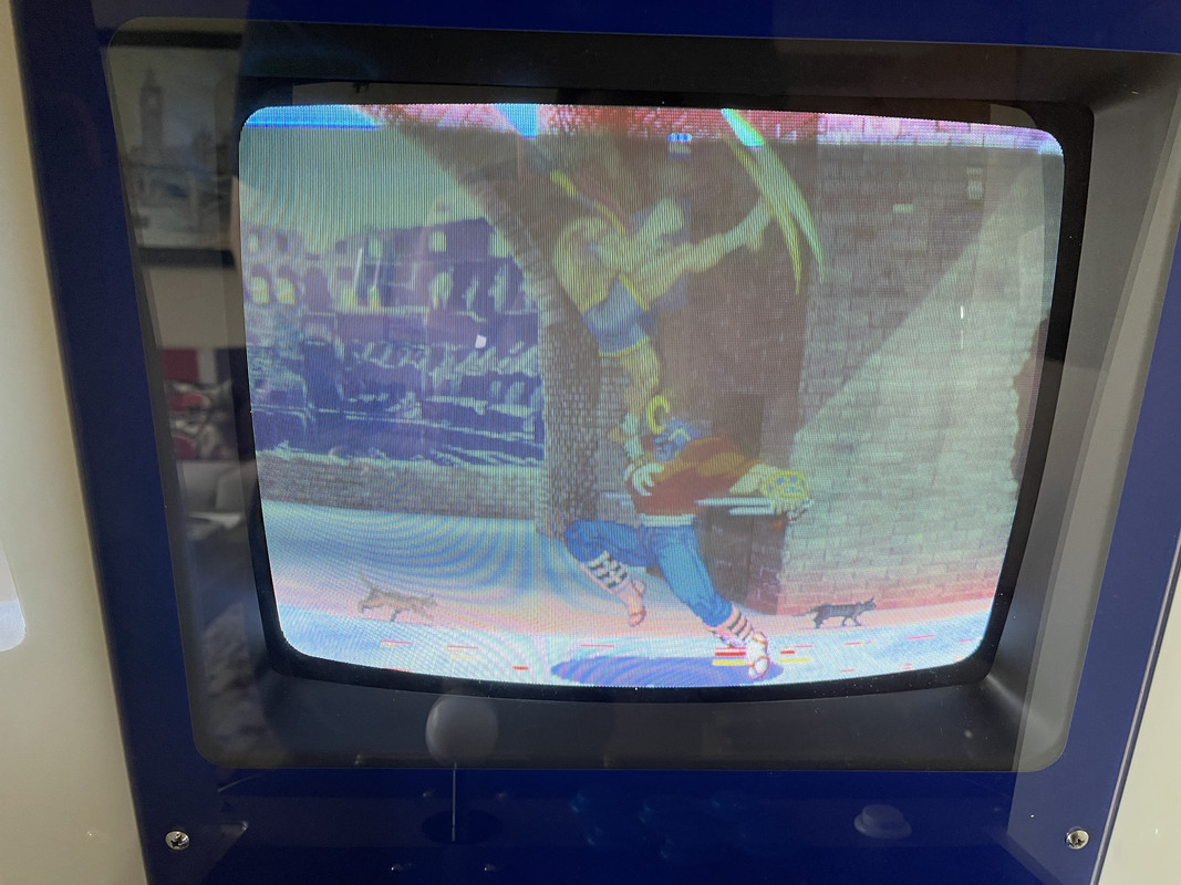

I’ve had my 32-in-1 since about April last year and recently the Z80 died (it probably committed suicide after playing the same Cadillacs & Dinosaurs level 1 music over and over!) and more recently the graphics have started corrupting. Sometimes it’s the sprites and sometimes the backgrounds. Is this because the voltages aren’t properly regulated? Sorry the screenshots aren’t great, you can just about see the HUD is missing or glitched.
