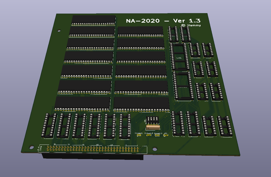

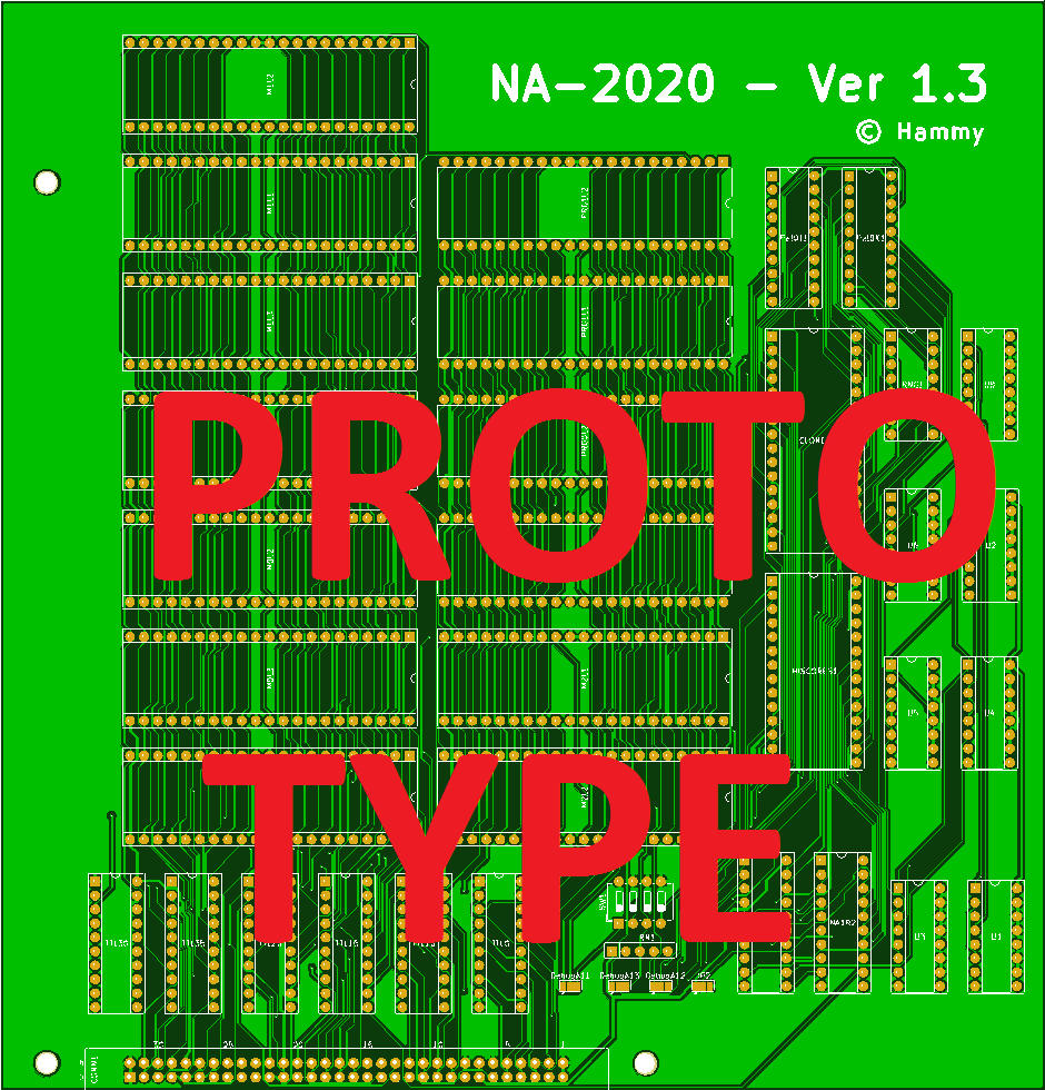

Final features;
Games list is:
1 Knuckle heads
2 Numan Athletics
3 F/A
4 Tinkle Pit
5 Cosmo gang
6 Emeraldia
7 Super World Court
8 Exvania
Keycus in hardware for real RNG and less hacky roms :D
2x backup ram 'profiles'
You can have 2 'defaults' setup for horizontal / vertical cabinets.. or 4 player and 2 player cabinet (no messing about with test menu's each time)
The backup ram can be easily dumped so can share highscores and other things like trojan parts of the board such as key customs / bios. And Debugging :D
Storage : 13x 27c322 roms - not 3 volts flash rubbish :P
Possibility for expansion / onscreen menu someday but the board will come fist.
A massive thanks to @caius for helping getting this thing finished and getting the schematics translated to PCB correctly.
Without him this would still be on 0.3 version and stuck in schematics format ;)
A test run is on order, hopefully she works!
Ok, sleep time now
:D
Some more....This should keep you all tied over till it's ready ;)
