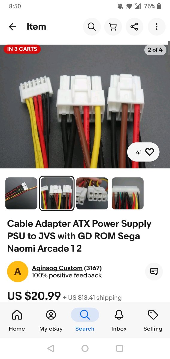

Thanks for the reply, any particular Power supply you recommend? How many watts would I need? Also I'd need to get a seperate force feedback board aswell for MT2?
I just used one I had lying around - maybe a 400w one? Pretty sure that is overkill even - and got the ATX->JVS power adapter.
And no - the exact same force feedback board you have in there works fine!

Would something like this do the trick? Sorry for asking so many questions, I'm still very new to all this.

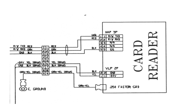

So - the card reader, it is not cable compatible with WMMT3, if I remember correctly you will need to use dupont wires out of the existing harness and into the new one (different connector) - and something with the power.... ok - yeah, look at the wiring diagrams, for WMMT3 - its 24V and the serial connection:

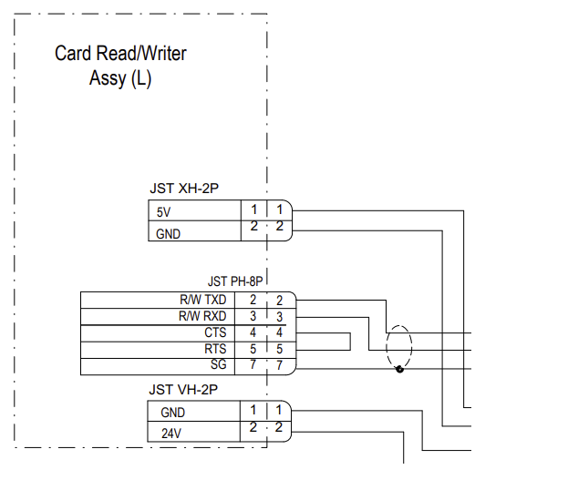

for WMMT2 - you are going to need to give it 5V also:
But - other than getting all that sorted out and the right wires hooked up (don't' forget to feed CTS into RTS per the diagram) it works quite well - I ran WMMT2 in my cabinet for a few years before finally getting WMMT3 going.
Somtimes the card reader was squirrely - but I attributed that to me not having a great converter cable - I was using dupont wires.
