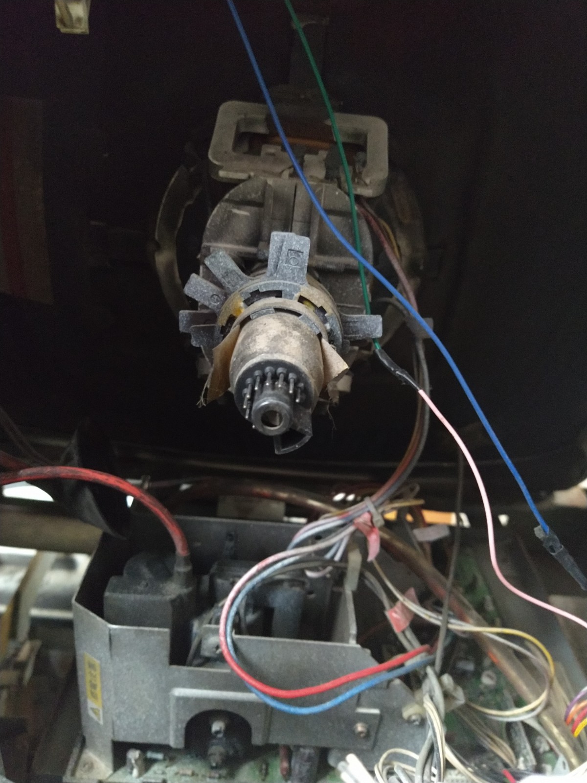

Last time I discharged the whole CRT, let it rest for about one week and I started to fiddling with it again today.
I managed to pull out the neckboard out of the tube with little force, avoiding to damage the pins. On my previous posts you pointed me out the neckboard was crooked out on the CRT.
Thankfully that didn't happened at all - the reason seems that the plastic connector pins were desoldered out the board.
Its legs are pried apart out of the base :crying:
Hopefully this can be fixed... Would soldering again be an option?
Thankfully the CRT pins seem to be fine, that made me more relieved at the end. Next would be to take out the monitor out of the Cab to start the cleaning process on the chassis - Thanks for all the advice.

Good thing the tube's pins are okay. You should be able to fix the plastic connector's pins by resoldering or using patch wires if needed. I'd desolder the entire plastic connector first, then look under it to see where all the pins/traces go. Then resolder it back on.
Way to go @Pacheco with more and more time you will become even more comfortable working on or around CRT's as you gain experience.
The first time is always scary and especially in a situation like this.
This is actually good news that the neck boards socket was damaged and not the actual tube or its pins. You can repair the neck board or possibly get a replacement too and that is far easier and cheaper than repairing or replacing the tube. You could also just replace the entire chassis and neck board pair. Save the old broken chassis for spare parts or sell it as is to make some cash back.

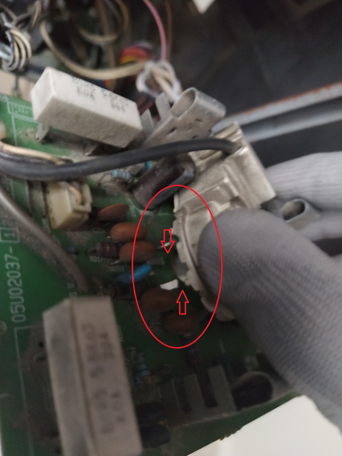

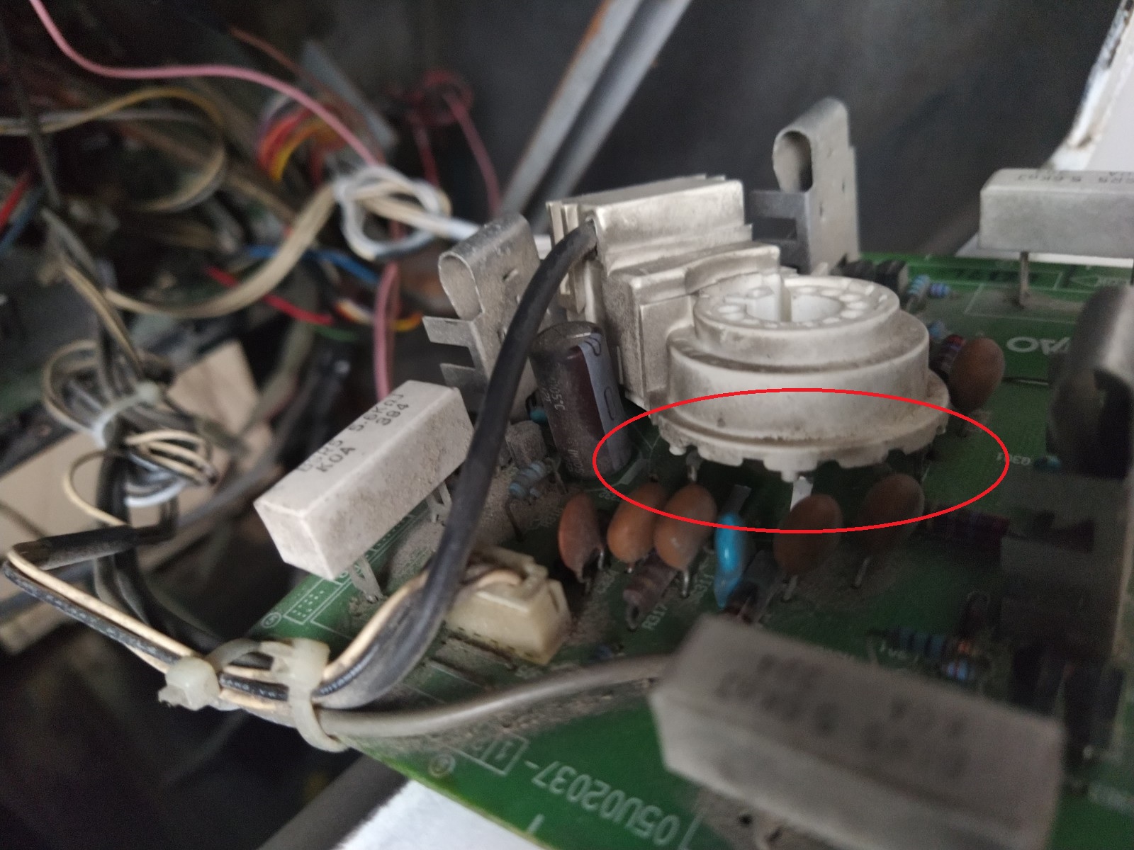

Its hard to tell but the sockets actual pins look to be damaged at the base of the plastic like they snapped. Which might be tricky to repair.
You might could find a way to solder it back though.
Edit: I missed where you said it came out of the socket. If the entire metal pin came out it may be possible to put it back inside of the plastic socket.

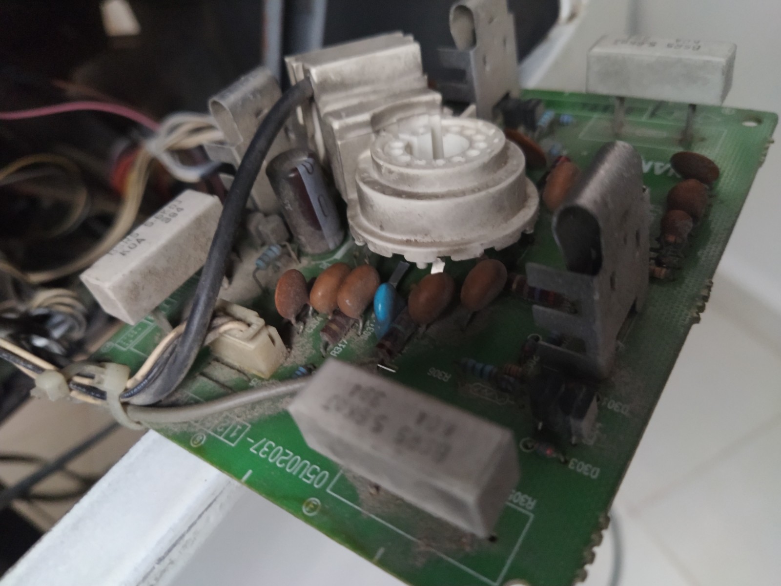

If you can get us a picture of the back of that neck board too where the circuit board is if you can. Could be some damage to the traces for that socket.
It looks like at least one pin has snapped. That would explain the funky image you were getting. The chassis being loose and dropping off more than likely pulled on the neck board and that's why it is like it is now. IMO send it off for repair and make the seller pay for it.
If you want to fix it yourself, you need to desolder the connector. I think I have a spare neck connector here (I would have to check, no promises). Or maybe someone closer to you can pull off one from a parts board.

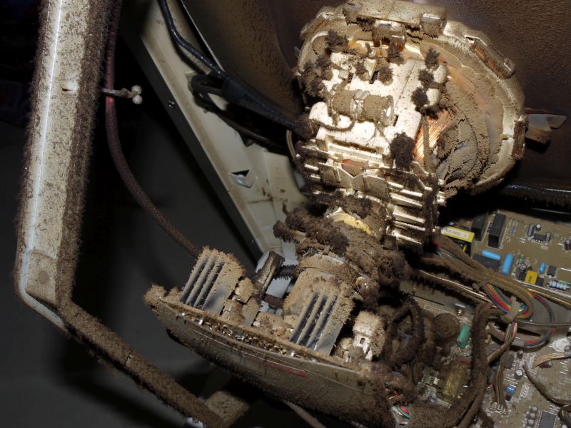

Nobody is saying the dust is creating problems. Where are you getting that from? It's having your hands emerge covered in tar from working on or swapping a chassis that is undesirable. If your things are only dusty, then you're very fortunate, as that's not typical for things that from from operating environments.

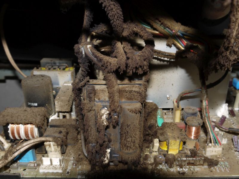

As for dusty, I label the following under dusty. I don't know, we might have different definitions:

That picture shows a lot of dust attached to the nasty smoky tar of the machine, which in my experience is pretty different from more mild household dust. Of course it's fine like that when running, but if the time should come to adjust the yoke and convergence rings, or remove the chassis (and get intimate with the anode connection) then it becomes a bad time for my hands.
Naturally it is not like these things just happen randomly during ownership or operation of the cabinet, so these are things I consider "first day" tasks when receiving a cabinet or monitor.
As for alcohol, I generally do not submerge, but go through a substantial amount of a bottle entirely soaking components in it. A spray bottle is used so I can forcefully get it into tight areas. I have fairly high confidence in the alcohol's ability to thoroughly reach the spots that water has. Furthermore, generally wouldn't do this process unless it's fairly hot outside, as the heat and sun do a lot to assist in drying the chassis. In a few instances where I wasn't feeling as sure about it, I depopulated all of the non-primitive components from the board for separate hand cleaning.
