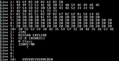

Looking at some print commands from my WMMT logs, and looking at the output on an old card, this game doesn't have much fancy stuff. It's mainly text and some special characters from the shift-jis table such as the circle icon ● (code 819C) - this odd code was not interpreted in my command line output, so it prints a question mark.
The packet of print data for WMMT appears to be the entire print every time, since it can erase. This is going to make image generation quite easy.
Packets come in with lines separated by 0D as the end of line indicator.
There are 10 lines.
Line 1 is the name as it was entered in the game.
Line 2 is the first line of car name.
Line 3 is the second line of car name.
Line 4 is player class.
Line 5 is HP listing - shift-jis encoded - there's an odd character code of 14, which I take to mean it's supposed to make the next character subtext, and or it's some other kind of sizing parameter, because the B that follows gets printed much smaller.
Lines 6-9 represent lines where boxes get filled in with circles.
Line 10 is the online code.

The ascii table lists code 0x14 as Device Control 4, so I'm not sure how that's generally supposed to be interpreted.
My linux shell, via SSH seems to interpret this data pretty well, and even makes the B smaller:

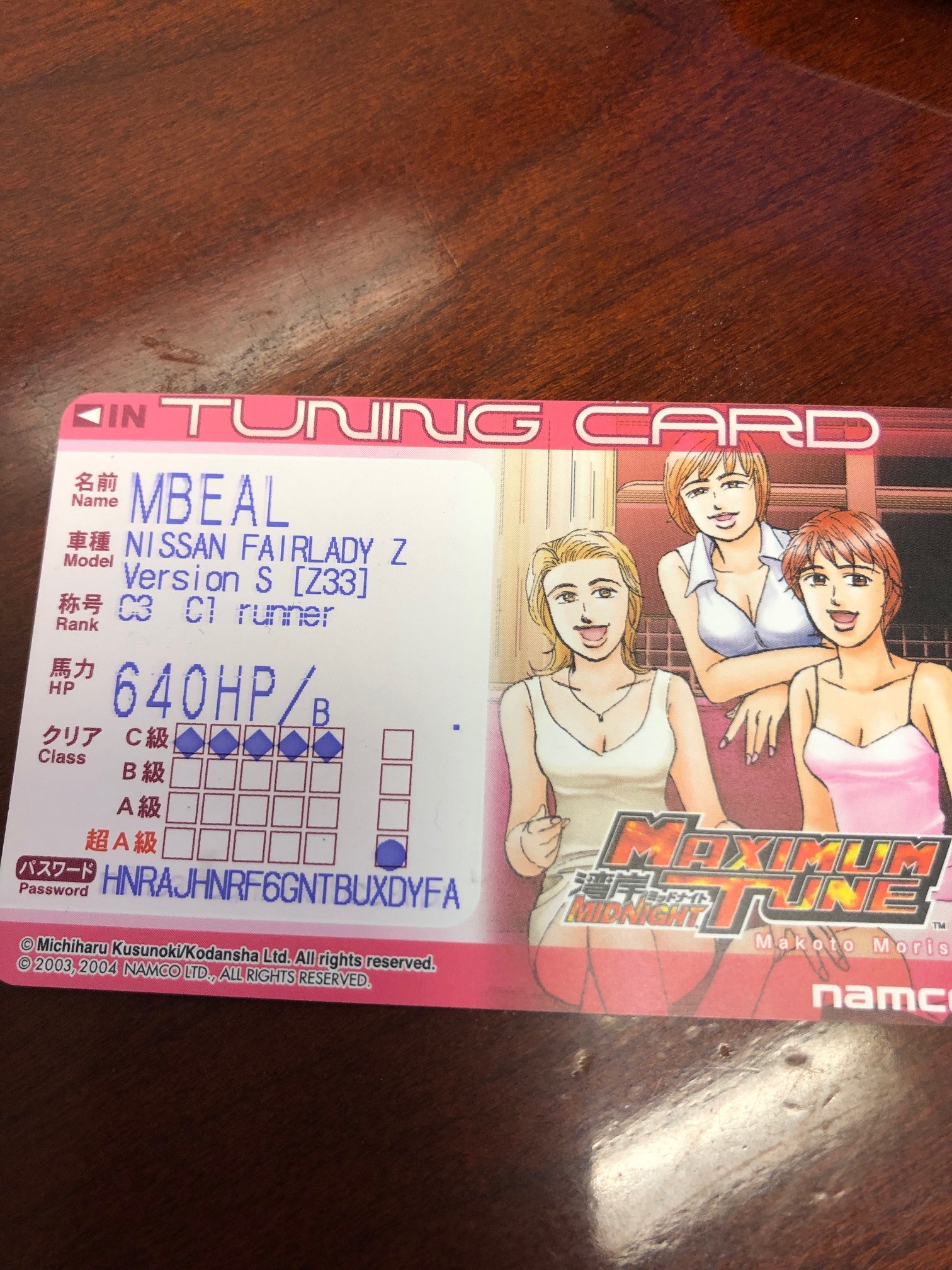

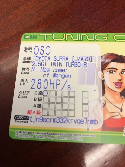

that is strange. i am noticing there are many different symbols being use in wmmt2. matthewball cards have solid diamond and open circle but my card has solid circles. wonder why the cards are different.
i am not sure but i think open object means tried the race but lost and solid object means tried the race and won. blank means has not tried the race
my card is img 1091 as can be seen it uses circles
from namco's own webpage for wmmt2 this card uses stars triangles diamonds and circles
I just ran a race and lost one - to see if it would do a open circle, it didn't....
I think the circle/diamond might be what level you are on of the race circuits... circle, then diamond and then triangle - and then maybe star? haven't hit the star yet.

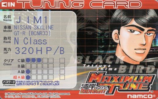

Here's a quick test to see that things are lining up. The text image was generated by my script and I simply put it on top of a card I scanned in a photo editor. Since my server is web-based, the final implementation will likely be a blank card picture with the text picture overlaid on top of it via css/html.
Note that the card I started with had the code at the bottom burned onto it, while everything else was blank, so the code generated by my script is sitting on top of one that was already on the scanned card. The benefit to having that printed data was I could capture the color from an actual print and make my rendering look pretty close. :thumbsup:
I still need to do something about sizing down text that comes after the HP/, and I'm experimenting with editing fonts themselves to affect spacing and look and feel, but I'm very pleased so far and am confident this is going to work out and give me the solution I have wanted for a while but didn't think I was going to be able to pursue.
