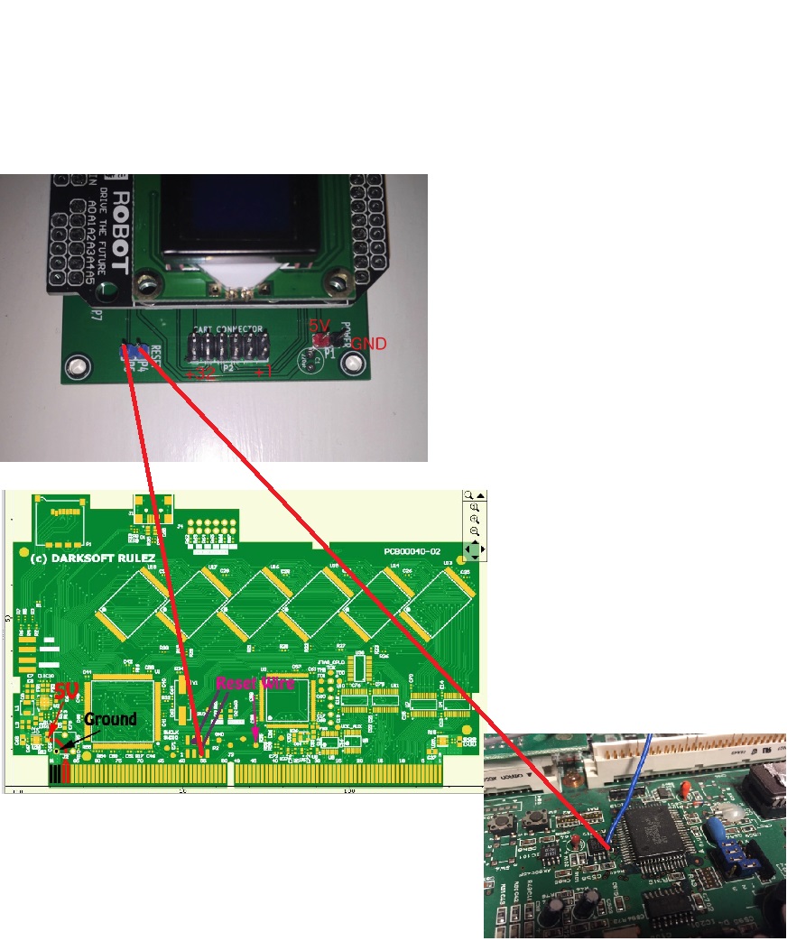

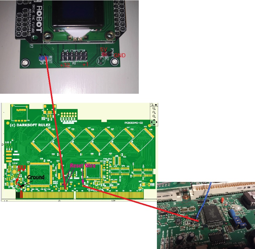

I'm working on installing a ST-V setup for @tom5151 but I'm not sure if I need to update the firmware or not.
Exactly how do the reset wires need to be connected from the LCD to the cart and from the cart to the motherboard?
That bit is a little unclear to me.
What I did now is go from the 2 blue pins on the LCD, 1 wire to the programming connector on the cart and 1 wire to the motherboard.
Is this correct or would I need to connect the cart to the motherboard as well?
Because when loading a game with the LCD the unit resets but I get a message saying something like 'error on cartridge, press service to exit'?
After doing that the units resets again and I get the standard ST-V post screen and I need to power cycle for the game to load?

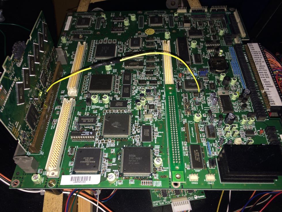

If you want the auto-reset function, just connect the reset from the motherboard directly to the multi (little pad without the pin headers), and P4 (or P5, it's the same) from the LCD to the multi (pin headers connector, can't remember the exact pin right now).

There is no way to know. It's just one cable, solder it and see if it resets.
use a resistor of 200 ohm or more when connecting the 2 points. That will make it 100% sure.
