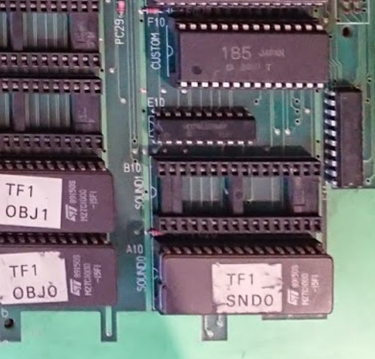

Over to the EEPROMS - from the schematics I see - SNA12 goes to pin4 on the sockets - correct? Which interestingly enough, is pin 2 on the chip? Is it possible these EEPROM's aren't seated in the right pins?. There are many on this board that aren't the same size, and they start 2 or 3 down. Here is a picture of the sound EEPROMS.

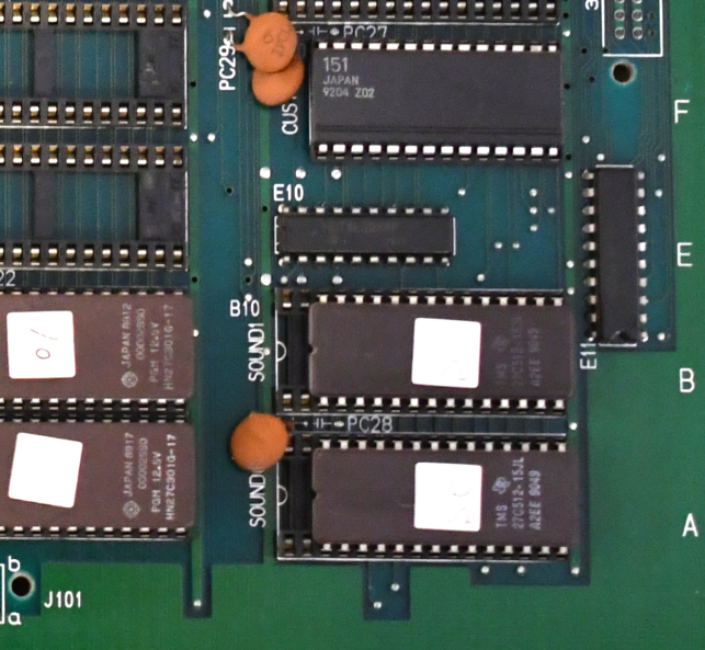

Those EPROMS are in the right place, System 1 games can have a mix of 64kbyte (28 pins) and 128kbyte (32pins) EPROMS, all sockets on the board support 128kbyte EPROMS, maybe pacmania uses 2 x 64kb instead of 1 x 128kb because it was cheaper at that time?, Tank Force uses just one 128kb
left: my pacmania, right: tank force

Both U2 and U3 are right there at the "sound generator" part of the pacmania schematic, don't know which one would be "RAM2",.. but if replacing one doesn't work I'd replace the other. And I had a pic I took from my pacmania board where you can see the 6264 exact model, maybe you find it useful, good luck!

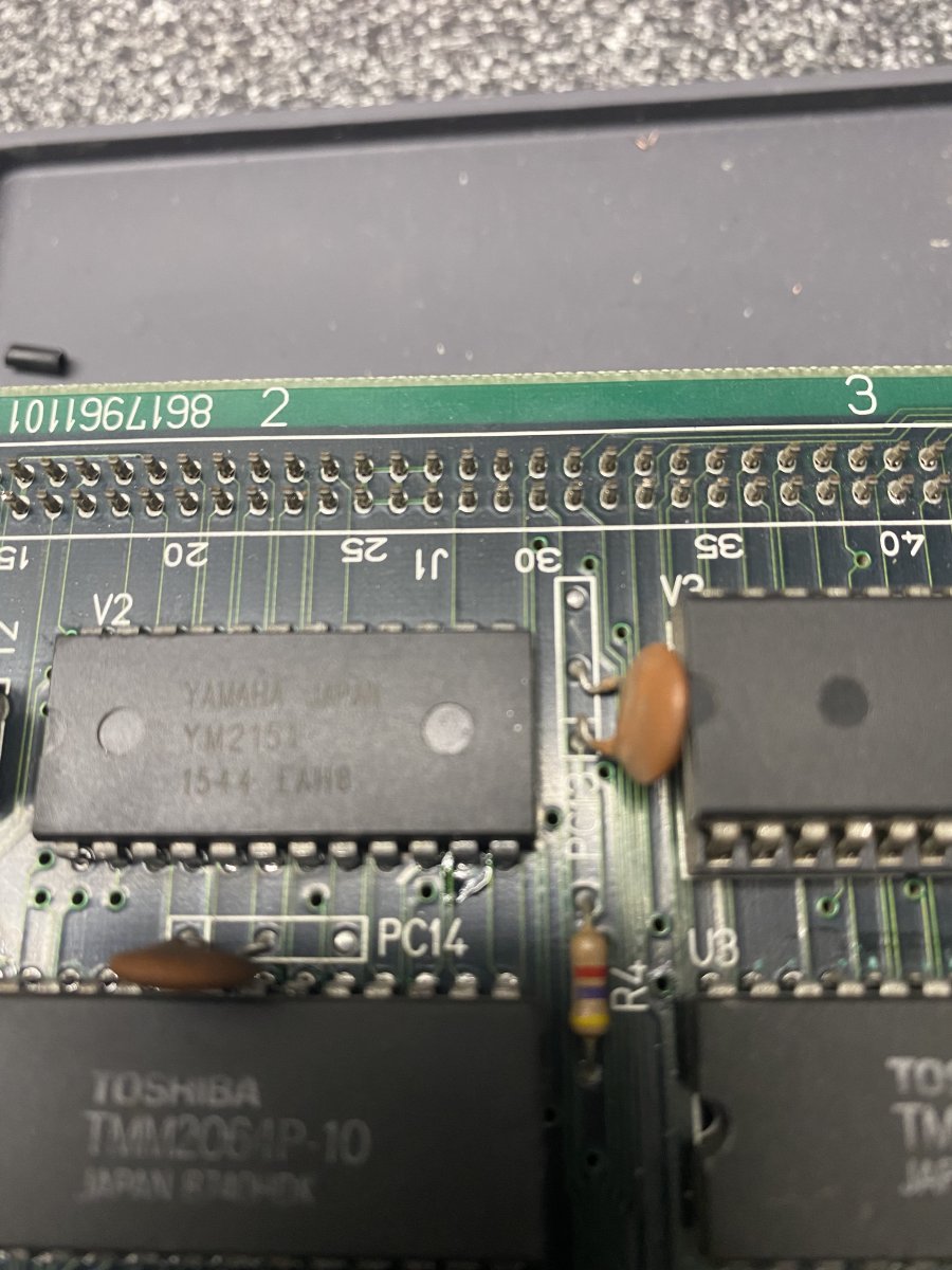

I got the Ym2151 late (today) but just soldered the new one in. I have a feeling its slightly different somehow - since when I boot the game I get garbled static basically. And when I go into the test mode I still get "SOUND CPU NOT STARTED". I will likely solder the old one back in. The picture of the one on the board is the NEW one.

I put the old YM2151 back in, and it is back to "normal" which is to mean the sound CPU is not running.
