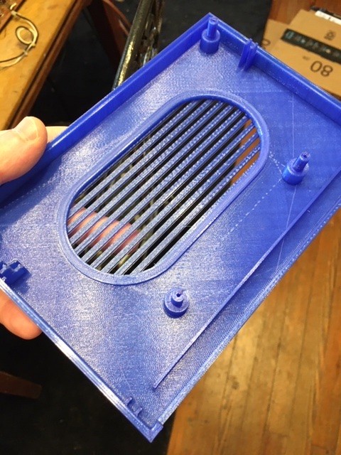

Working on an stl for 3d printing shells for these boards. Need to make some revisions and still print the other half but I’ll share the files when I know I’ve got something that’ll work. Bottom half works ok aside from the socketed Roms bumping that oval
What if you guys make something that is slightly different from an OEM Shell ?
I mean a shell or something that will tightly hold the 2 pcb toghether and will help to easy to put and remove the game ?
(just saying :rolleyes: )
I was thinking about making some bumper type holders that would print easier/faster and make inserting the boards the wrong way impossible. Could maybe modify my parts to realize something like that if these work
I don't think it has to be a 1 to 1 reproduction. So long as it has vents since those things get hot, and it is affordable.
