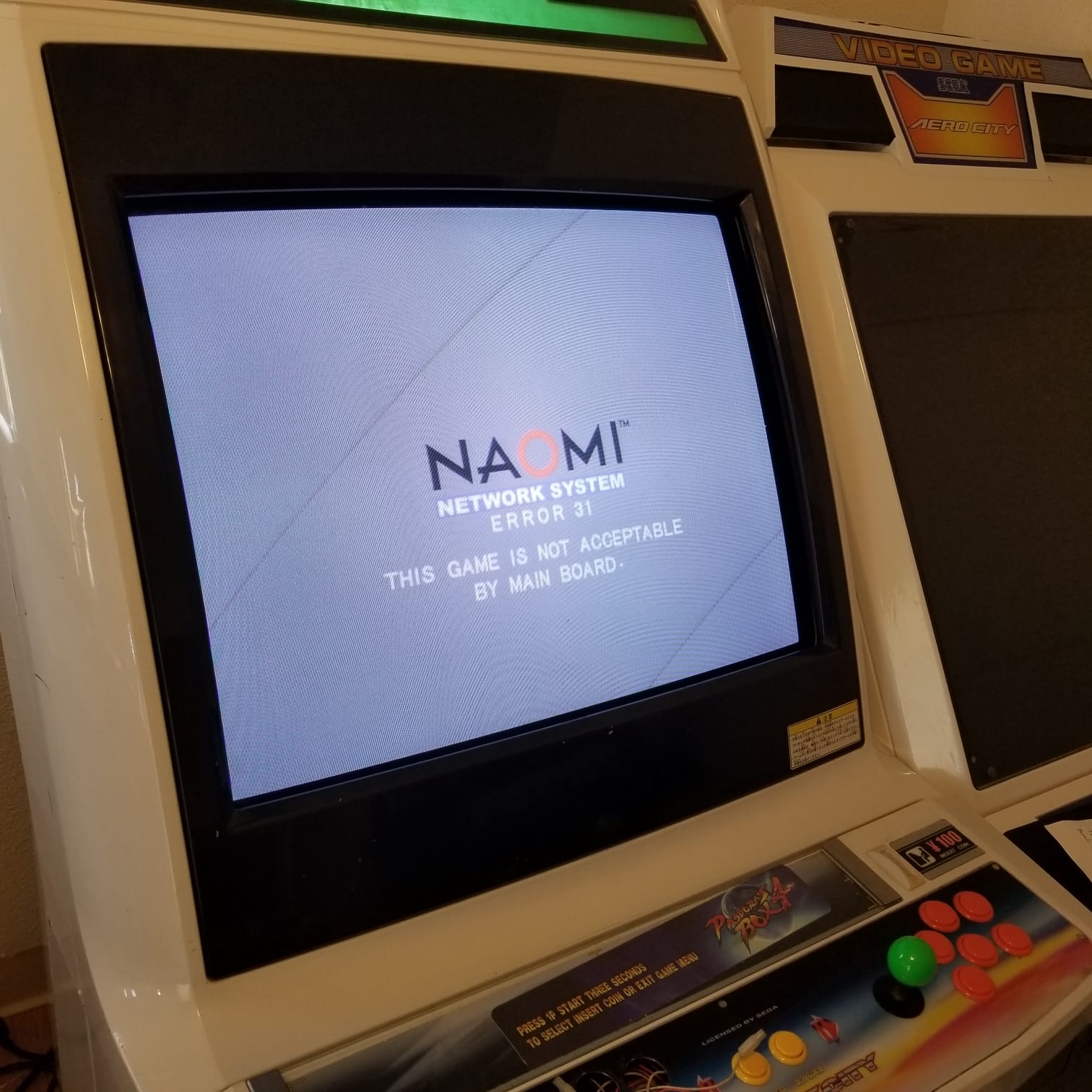

@mathewbeall After i click on the game it goes black, then it reloads and immediately i get the error 31 message.
@Malenko i am running a crossover cable directly from the pi to the NetDIMM.
Im using raspberry pi version 3

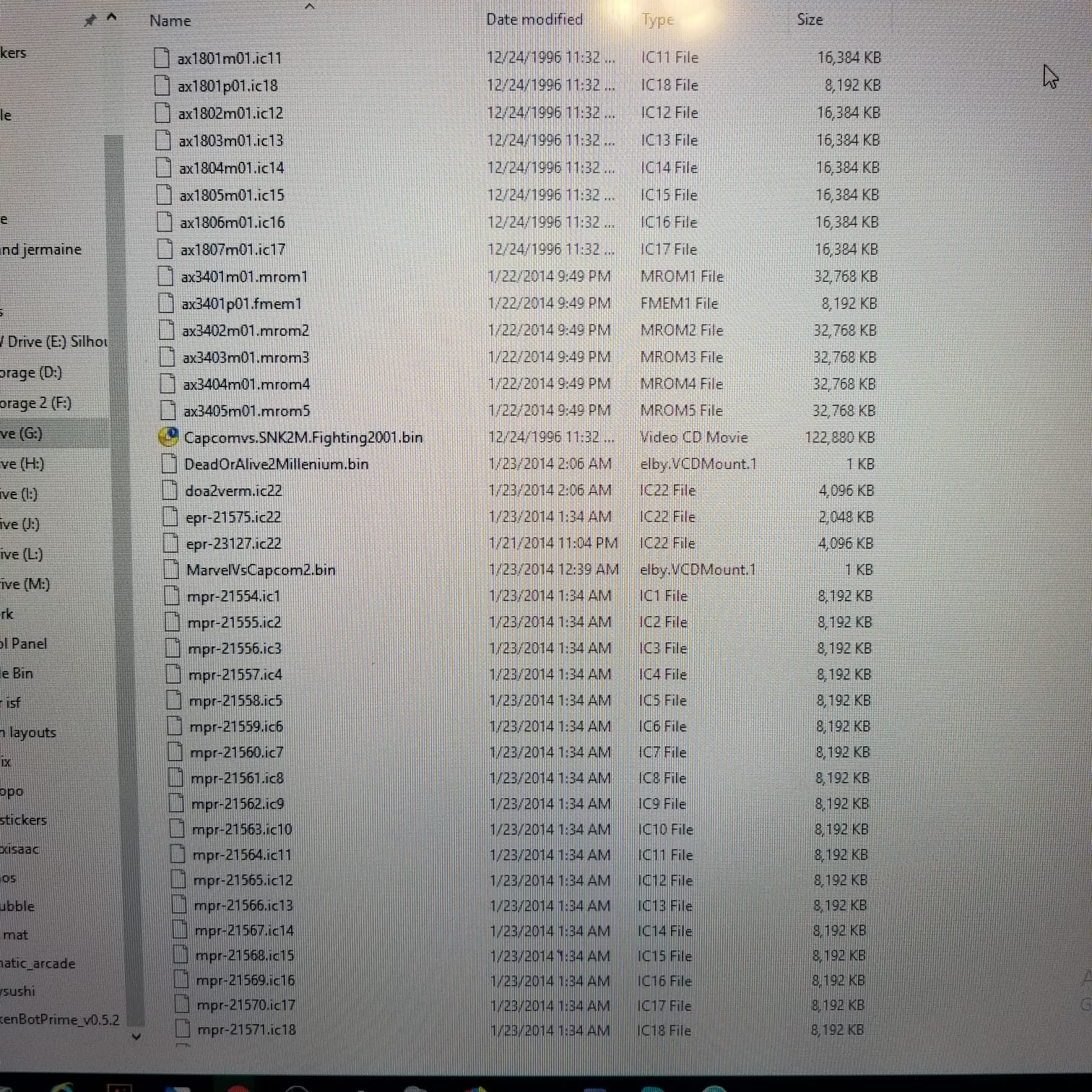

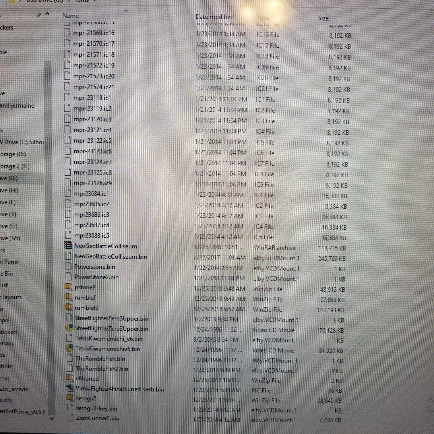

This is what my directory looks like right now.
next 2 pictures are the roms folder.
Zero gunner seems like its going to load but it stays at a black screen.
I might just start over

@jermz1 What are all those other files in your directories? Also you can screen grab using the snipping tool ( start -> run -> type snipping) easier to read than cell phone pix.

@Malenko sorry, i used the snipping tool now. All those files came from the piforce web v1.2 image.

@jermz1 can't see it clearly but it looks like you are powering the Naomi through your Capcom converter? If you are, that is more than likely your issue...
I think it can work with a naomi1 if the power supply is solid (at least mine did).
A couple of easy questions.
1. What is your NetDIMM firmware at?
2. I assume you have a zero key PIC in there from a reputable source? (I see it plugged in on your picture).
Edit: Initial D is a Naomi2 game (as far as I can see) - not Naomi1 - which is what you have. Try a rom for Naomi1.
Matt
He mentioned 4.02 earlier
^^^ This.
Start with something simple and small. Try Powerstone or some shit. You have pstone2.zip in your directory, but the unzipped bin is 1k. You also have VF4 in there, which is a naomi2 game.
Start with one game we know works with n1 and try that. Who knows what game you have been shipping to the netdimm.
Grab this powerstone2 rar file.....
https://mega.nz/#F!lg4TTIrL!Bs03RF6fYjoUg1YYUt70Dw?lshW2ADK
and try it. Get rid of all that mess you have going on in the directory too.

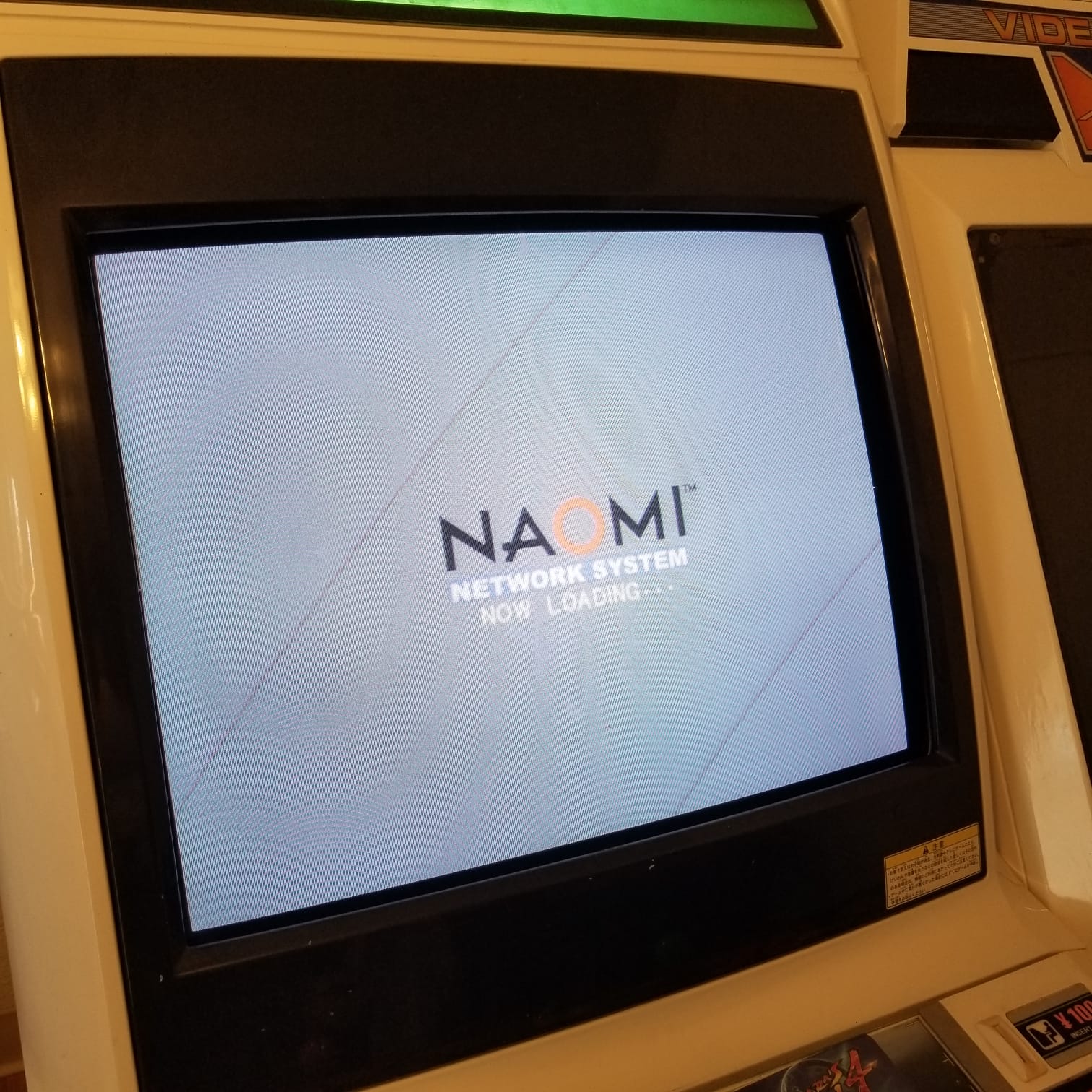

finally got it working. Thanks for everyones help.
I'm slowly understanding this whole set up.
YYAAASSSSSSSS!
Good job my man! Welcome aboard!
Edit: If you can pinpoint what the problem(s) was, please post in case someone finds this with same issues. :thumbup:
