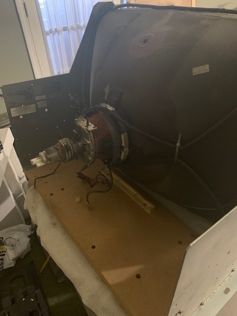

Now I mentioned to hursit that if the K7000 must go in without the OG frame, that does opens up the possibility of using alternate CRT monitors. Even donor TV tubes would work with maybe even a universal Wei-ya chassis becoming an option in a pinch. Would make those on the fence that can't secure a WG 19K7000 closer to getting on board. Now if alternate monitors become usable, then the bezel has to be thin enough gauge to be flexible to account for potential differences in screen curve. I mentioned, I've tube swaped a ton of 19" classics with preformed bezels. Screen curve differences at 19" have never been a problem since in all of those cases, those bezels have been flexible and I've been able to get them to fit without light leakage. But my previous efforst have been pressing in such bezels perpendicular to the screen. In this case, the bezel will close in with the door at an angle. At most, a user using a non-WG 19K7000 might have to do some mods with a heat gun or Dremel to make it work. But to make this happen, a certain measurement must be known: Front of screen to dog ear mount.
Given that, I have some work to do. To take accurate measurements, I must do this on a level surface with the screen face down on that surface. And because the screen is curved, I have to find some 1" rubber rectangular tubes to keep the monitor in that position stable and level. The measurements can't be accurate if things are not level. From there I will need to take these measurements:
With Frame:
  • Total depth - done 17 5/8"
  • Depth to back of frame
  • Width of back of frame
  • Depth from front of screen to frame mounts
  • Frame mount spacing
  • Frame mount hole size
  • Length of wires from chassis to neckboard
  • Total Length of wires
  • Length from FBT to anode cup
  • Total length of anode wire
Without Frame
  • Depth to from front of screen to tube dog ear mounts
  • Dog ear mount spacing
  • Dog ear mount hole size
I also told him I have quite a few 8-pin 19" TV tube donors handy for the WG 19K7000. I'll measure those just to see what the viability is of using alternate monitors. Also, many WG 19K7000's are burnt to a crisp. So many that would be candidates for use in the repro might be unusable. So I'll measure those with the same dimensions as "Without Frame" measurements. That way, we can know what the viability is of using alternate 19" monitors for those that are on the fence due to monitor consideration.

I've discussed this with hursit and will give him measurements of some ISO transformers. K7000 ISO transformers come in slightly varying dimensions. But they are all pretty similar in dimension. I mentioned to him that they are usually found near the AC input on US cabs and are earth grounded along with the PSU. K7000's tend not be be earth grounded to the frame, with the exception of 90's Williams/Midway cabs. You can always tell a K7000 that was used in such a cab (MK's, KI's, Blitz's, etc.) because the AC connector has a 3-position AC connector. All the rest, use 2 position connectors. But I have seen plently of non-Williams/Midway cabs have earth ground to the K7000 frame and even more with no earth ground to the frame at all.
@rewrite, here is further proof that K7000's run fine without a frame. Believe it or not, that is an OG K7000 frame for a 25" cab. Came out of a Dynamo Big Boi. The metal you see there is only for structural support of the tube. There was no grounding to the metal aside from the DAG wire via grounding strap->dog ears->structural support. As for the where the chassis mounts, it is jut partical board. That plastic guide you see there is just a standoff. The same one you find on a metal K7000 frame to keep the solder side from shorting out on the metal frame. Here in the Big Boi, it is just used as a fastener for which it did the job well. This monitor hosted Raiden II in TATE. I was pretty astonished to see this frame when I pulled the monitor out of this cab.
