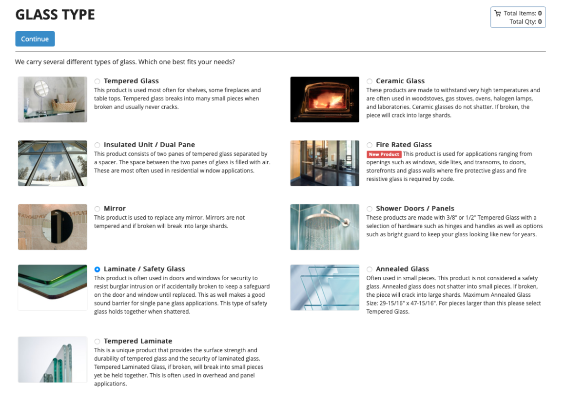

Bumping dead thread to add info for anyone in the future looking for more info - After calling multiple local glass shops and being denied, I was referred to these guys based in Washington State https://www.onedayglass.com/order-online/
After speaking to them and discussing this project, I learned there are two types of tinted glass, light grey and dark grey. Dark grey is used for car window tint, it is too dark for arcade monitor glass. Light grey is the most likely tint for this. (Other ways of tinting involve putting a decal on top of glass)
Laminate / Safety glass is what I ordered. As far as I could tell, this is what you want if you are going for the stock look.
Here's my order. I couldn't get the flat, 1-step bevel on all edges for some reason, probably due to the type of glass, so I asked them to pencil-grind the edges instead. I selected the matte/satin option.
Laminate / Safety Glass
Shape: Rounded Corner(s) (a, b, c, d)
Thickness: 1/4"
Tint: Light Gray
Edgework: Pencil Grind All Edges
Hole Size: 3/8"
Hole Quantity: 4
Total order including shipping was $260 USD. If anything doesn't fit, looks weird, or the weight is off or whatever, I'll update the thread and try again.
The reason I did not select "Tempered Laminate" is because there are no beveling options for this glass. It's "Seamed edge" standard finish only when you have rounded corners.
Regular "Tempered glass" with the same specifications is about $50 cheaper, at $214 shipped. Here's some more info on the differences: https://info.glass.com/laminated-vs-tempered-glass/
Typically, laminated glass products are a slightly higher price than tempered products of the same type and thickness.
The optical clarity for both laminated and tempered glass are excellent in either product will provide many years of satisfactory service in your door or window.
It seems the visibility is identical and it's mainly a matter of cost, preference. I went with the stronger glass because who the hell knows what could happen, right? Maybe I'll knock a lamp into the aero city some day and I don't want glass shards and glass dust everywhere.
The cutting process they use is with a water-jet.

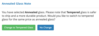

Oh also, if you try to use cheap Annealed glass, you will get this warning:
