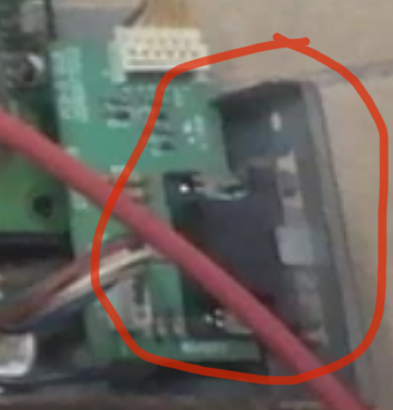

You got the little switches on the controller pcb .. if it was auto sync why would they be on the controller pcb ?
Ms2930 - Manual tri sync.
Switch off before switching res on the controller pcb
it is not an auto indeed… i have a manual one ms 2930 with the d switch.
the only shoud i say problem here is that the switch only works for 15k but not on 31khz resolution as shown in yhe video of mr hide.
Db9. For 31khz ?
