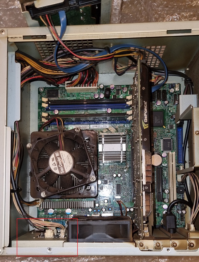

Hi guys,
I literally is a beginner in this sector without too much of knowledge and I still bought a ES1 machine, you guys can laugh at me.
So basically, I just want to know how can I power the machine on, do I need to acquire a set of controller / button which from actual cab ( I mean something like test, service and power button )?
or I can just use a generic pc power button and plug on the Motherboard? ( I think this may brick the machine if I directly plug something external to the system?)
I attached some pics what I have with me so far, may I have someone can kindly help me on this first step of my journey, much appreciate.

You don't need a power button, you can just plug it. Which Gundam is GKE again? Bonds of the Battlefield?
I'm not sure what you're expecting to happen. It will start booting the game and then error due to no IO and / or connection to Namco's server.

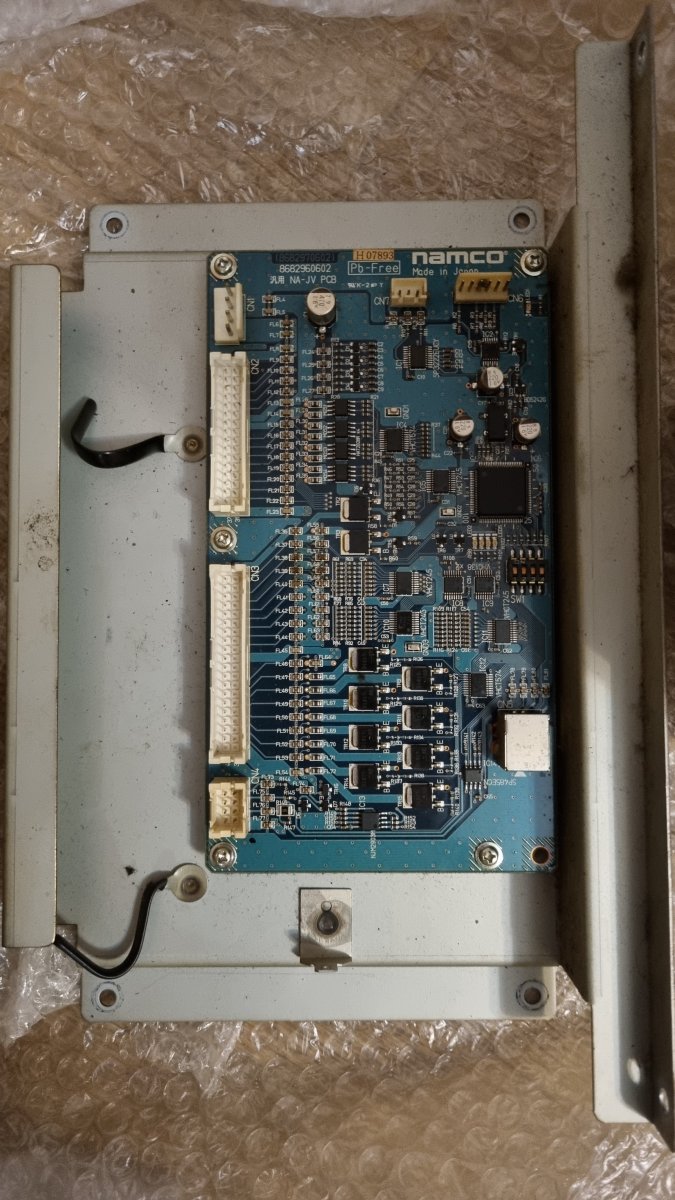

Also, do you know what I/O board will need for me to connect controller to the machine? I presume that external PCB will not be enough, since I found some history picture and seem they have power supply for controller or some essential board(?), do I actually need those official board or I can have some alternative board?

So you mean, if I just plug the power cord, the machine will just turn on?
Yes. It's set to restore power on AC loss.
I have no idea on BotB. Try connecting the blue IO board and see what happens. It connects to the JVS port on the motherboard with a USB B cable. You will have to look up the power pinout from the Namco Noir manual:

1.)so I just tried to turn it on and it really come up with I/O error, for the I/O board, I actually just plugged a USB B cable(without plug other thing) and connect to the machine,
since I still figuring out how to power up the board, since the maunal quite hard for the beginner like me to read. I mean I can read japanese word, but on the machine picture,
they just name the cable as "connector" and not mentioned what that is, and for the cable diagram, I can read the cable color and the usage of port,
but I still not idea which part represent the I/O board :(
Should I need to buy a separate modular PSU (for PC) and use adaptor to plug a 4pin power to the board first?

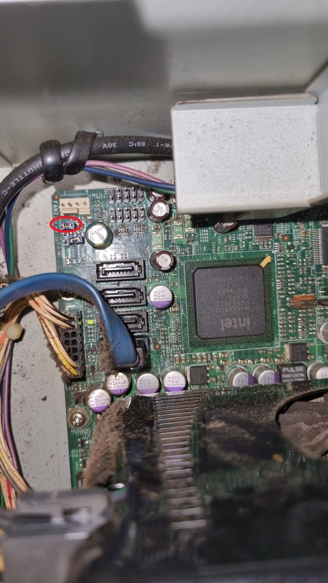

2.)I actually have another set of ES1 but that one seem having power on issue like this thread:
https://www.arcade-projects.com/thr...does-not-power-help-please.16169/#post-268248
that guy advised to unplug a header then use screw driver to turn it on maunally, but I tried one of the header, unplug and use screwdriver touch that( see below pic),
but nothing happen, may I know where is the jumper for turn on the machine?

Here's the pinout for the NAJV2 IO board from the Noir manual:
At the very bottom, you have connector J43. Also known as CN1. It's a 4-pin JST VH connector. Pins 1 and 2 are GND, and Pins 3 and 4 are +5V. Get the mating connector and contacts for it. You can just populate two of the pins, like in the Noir manual (pins 2 and 3).

You can use any 5V power supply to power the board, or you can use the PSU you have in the computer. I would use the computer PSU. The normal 4-pin power connector is a Commercial Mate-n-lok connector. Again, links to Digikey:

As for 2), I would figure out why the second computer isn't booting. Since you have two and one of them is working, this is actually easy. You change parts between the computers until you find out what is making the other computer not boot. Start with the RAM. That is very often the issue with any non-booting computer.

So for power on issue, I think I will start from swapping RAM later but I want to add some info, so when it connect to power, all fan on the machine was not running but the I see few green LED turned on (one on the board and one on the side of usb port and DVI port.

I checked the power supply in the ES1 but I can't find any power cable from the PSU were not use,
so how you draw power from the build in PSU? using something like "Sata Power Splitter" to draw power from there?
or using some pinout on the Motherboard which is not occupied? (like the pic in below?)
so I read the ES3 teardown thread and found that the little pcb which on the side was seem also have power output,
do you think if I can use that?
There's no extra power outputs from the PSU? They're all used?
I would probably use a splitter then.
I don't know what the pinout for the little PCB is. You would have to meter it.
Can you take a picture that shows the connectors coming out from the PSU?

you mean the connectors plugged to the little PCB? here you are:
And yeah, I think and power cable were plugged.

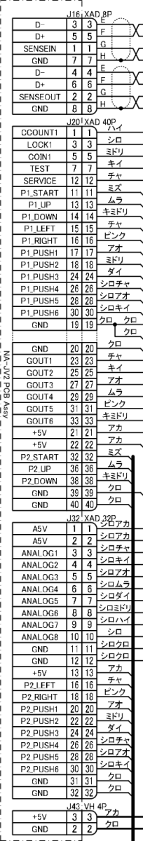

Actually I still not know how to properly read the diagram, so for example of first set of pinout( aka CN4 ), It seem only have 4 pinout on each side but it show 8 pinout,
then the number of pinout in diagram seem not in order:
may I know how can I properly read? should I count 1,2,3... from up to down? or left to right?
The orientation is marked on the silkscreen. See the numbers at the corners of the connector.
If the PCB didn't have any markings, you could also try to deduce it through the given pinout. You know 21 and 22 are +5V, and 19, 20, 39 and 40 are ground.
If you get the correct connector for it (JST XA), the numbering is also on the connector.

So on the diagram, each of the pin have 2 number, one on left and one on right ( like Test 7|7) what is the different between these
I think I got that, that only about female and male of plug ...
