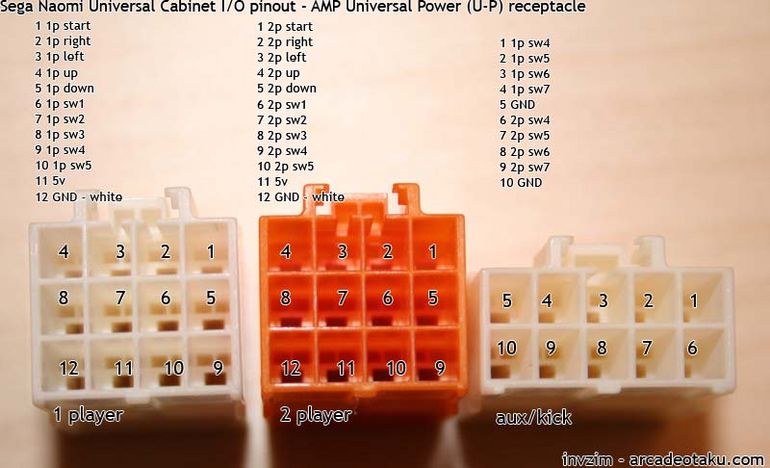

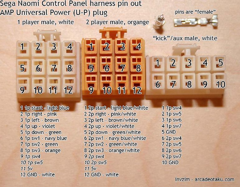

Pinouts for the receptacles you're building:
Pinout of the plugs connecting to them (that you have premade, but make sure it matches just in case):

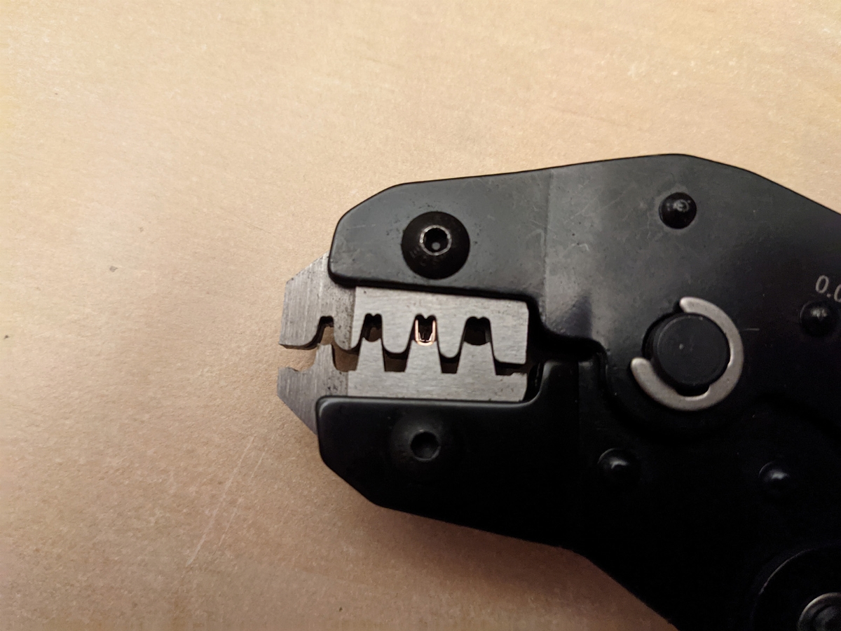

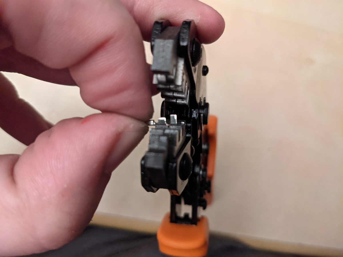

Sure. On the Iwiss, you want to use the third from left section for AMP-UP contacts.
Make sure you position the contact as shown, so that the dividing line of the crimp surfaces is between the insulation and conductor crimp:
Close it to 3 clicks of the ratchet, so that it holds the contact steady, and make sure it's straight as shown:
Now you want to strip the wire so 3mm of conductor is showing and gently insert it with very little force. You will feel it stop naturally, this is the point where you close the tool fully. It takes some practice to get a feel, so try it a bunch on scrap wire.

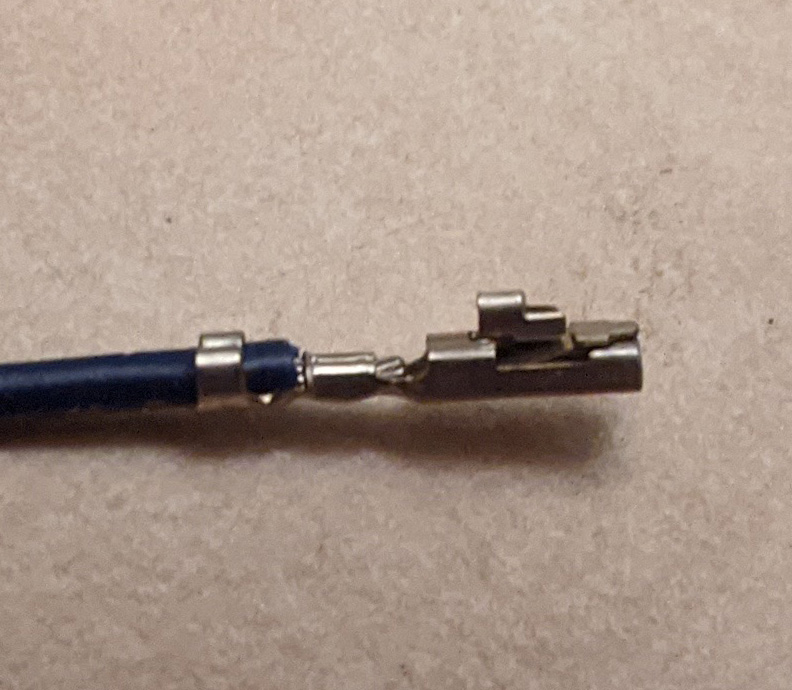

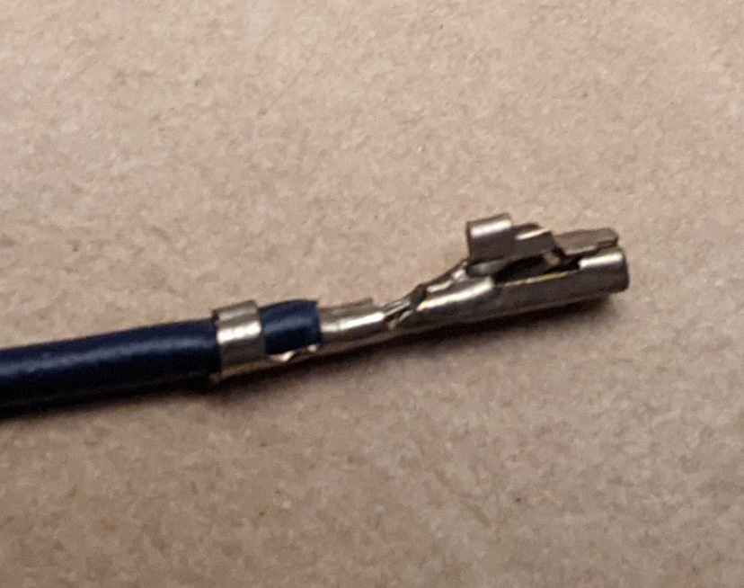

Here's an example of a BAD crimp. The main contact body is crushed. This is what happens if you ignore the first picture I posted:

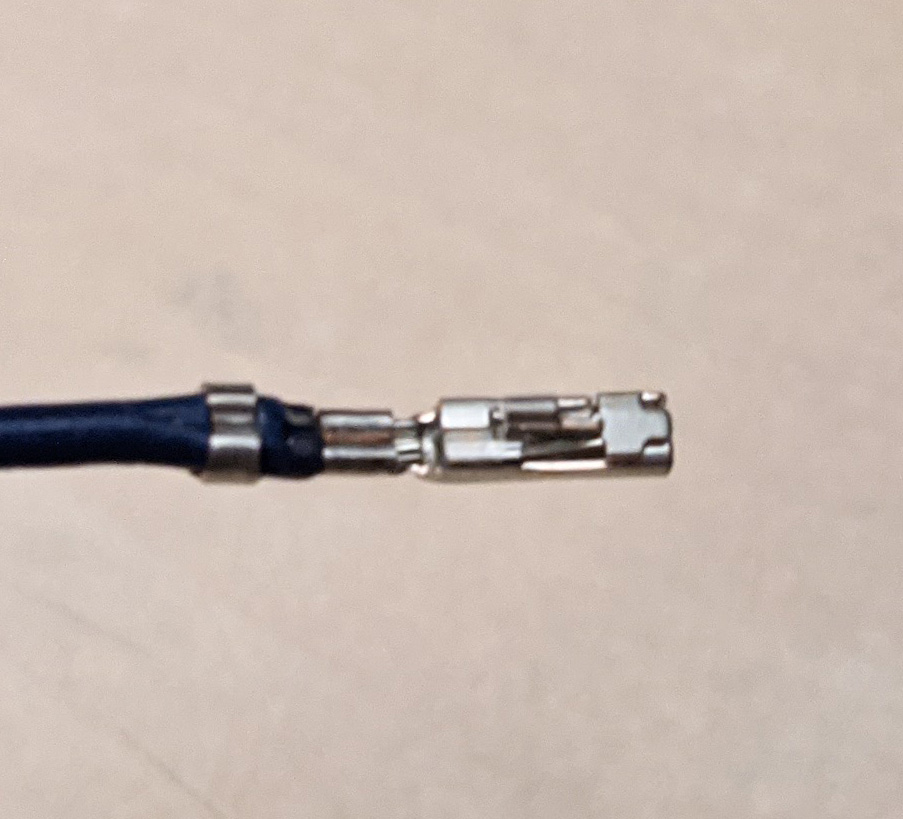

Here's the UP contact crimped with the official tool, to give you an idea of what a "perfect" one looks like:

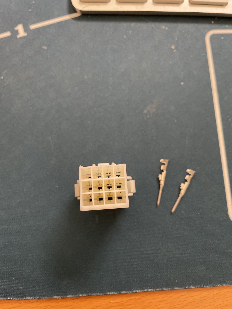

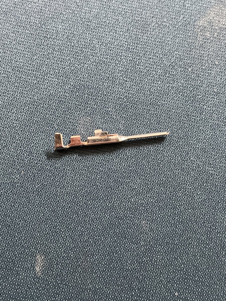

I just got my order from digikey and they look totally different
That looks like the correct crimp series, but wrong crimp gender. It gets a bit confusing...
The plastic connector body comes in both a Plug and Receptacle.
The crimp connectors come in both Pin and Socket.
You need to pair up the connector body Plug with crimp sockets.
You need to pair up the connector body Receptacle with crimp pins.
You have the crimp pins shown above, you need the crimp sockets (https://www.digikey.com/en/products/detail/te-connectivity-amp-connectors/175151-1/1152993)

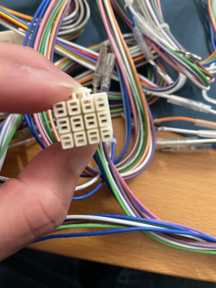

Ok. Just to make sure I have everything correct. I have this Naomi harness:
And these connectors:
I need those other gendered crimp you listed in the previous post to go with this AMP connector?
When I go to cut the old connector out of my cab, do i just make sure the right input goes into the right receptacle on the AMP connector? it looks like the colors don't match between the old harness and the new one.

You have the correct contacts for your application. I just messed up and used the wrong gender in my example but everything will be exactly the same (on the official tool, both genders are crimped in the same place). And yes, make sure the right input goes to the right receptacle, don't rely on wire colors because sega and SNK used different colors, and there is no standard.
EDIT: You don't need to buy any female contacts because you have the premade harness. You are good with the contacts and housings you have.

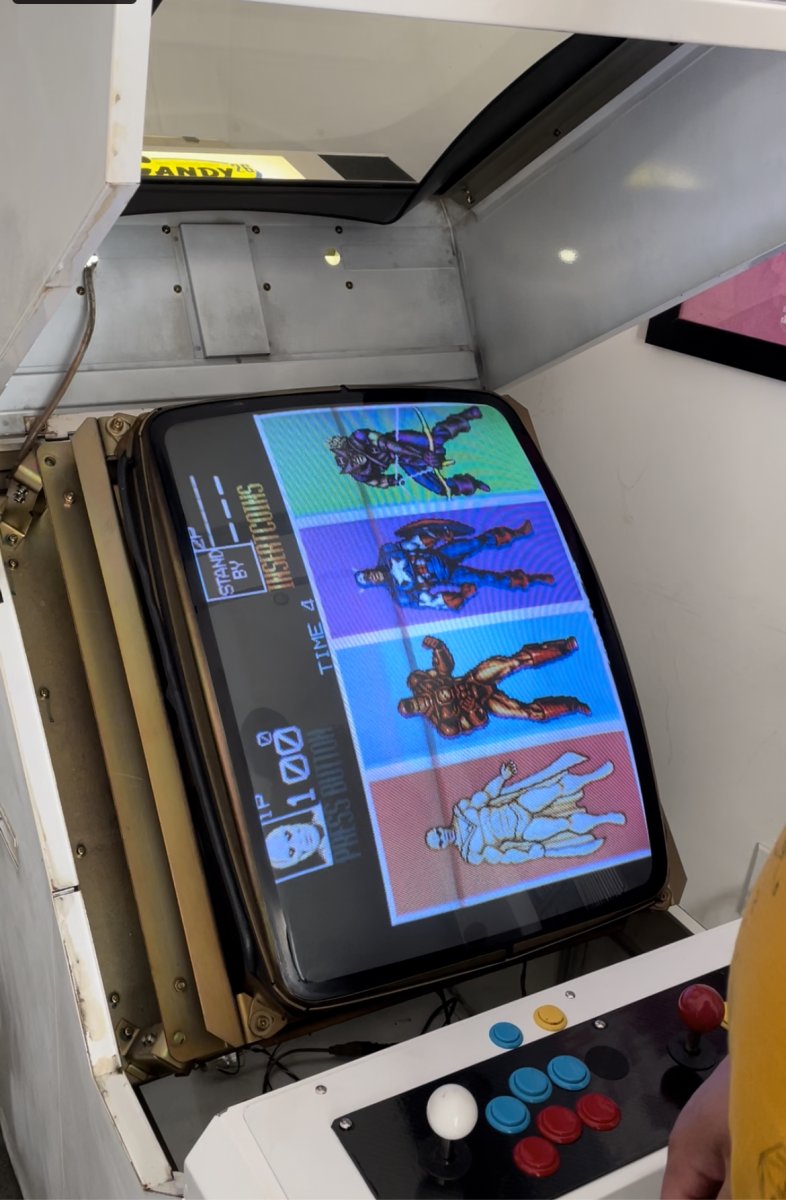

Anyone have any idea why the color is all washed out when I rotate my monitor to horizontal? I have a video of it happening in real time, but I can’t upload it here.
That is totally normal and caused by changing magnetic fields, you need to degauss it. The should be a degauss button somewhere in the cab, if not you need to order a degaussing coil.
