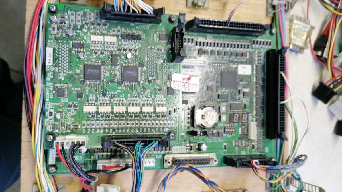

did you get your hands on this I / O? Bad….
If for some reason it has failed you will have practically 0 chance of finding it as a spare part, unfortunately these arcade cabinets are quite problematic! Have you reprogrammed the 2 Panasonic? If so, how?

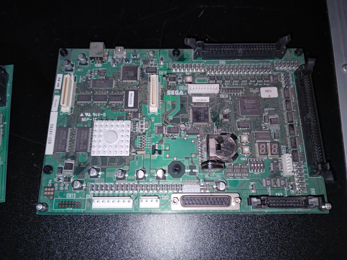

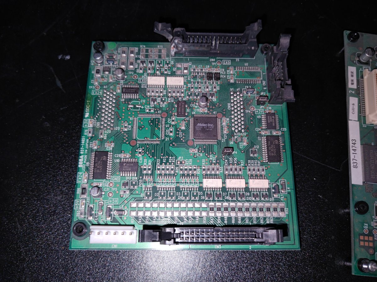

I have plenty of the bottom boards, and we have some different top boards. Aren't the same though

Those boards that I showed you in my last post are from a House of the Dead 4 Special, and 2 Let's Go Jungle Special cabs that were trashed in shipping and I salvaged whatever I could. We have a working cab of each of those, so those also work for backups to that.
So when I kind of pinpointed that that board was going bad I went and "shopped" my stockpile and found those boards.

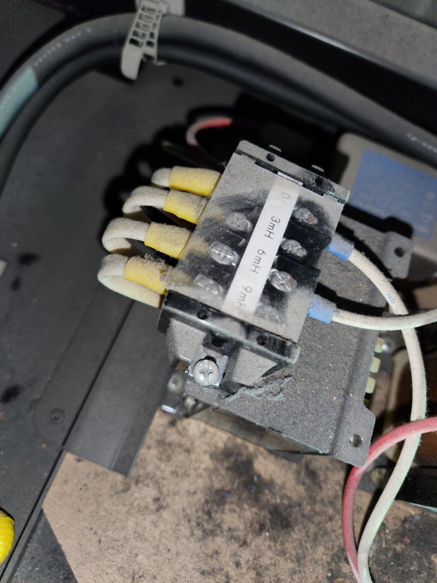

So I'm back at it and trying to add motion back To these guys. I have noticed a fair amount of misconnections with transformer inputs across multiple machines. The former techs never connected them properly, but just left what was connected from Dubai. I am trying to see how to measure these, at the motion controller, to make sure these are connected properly.
