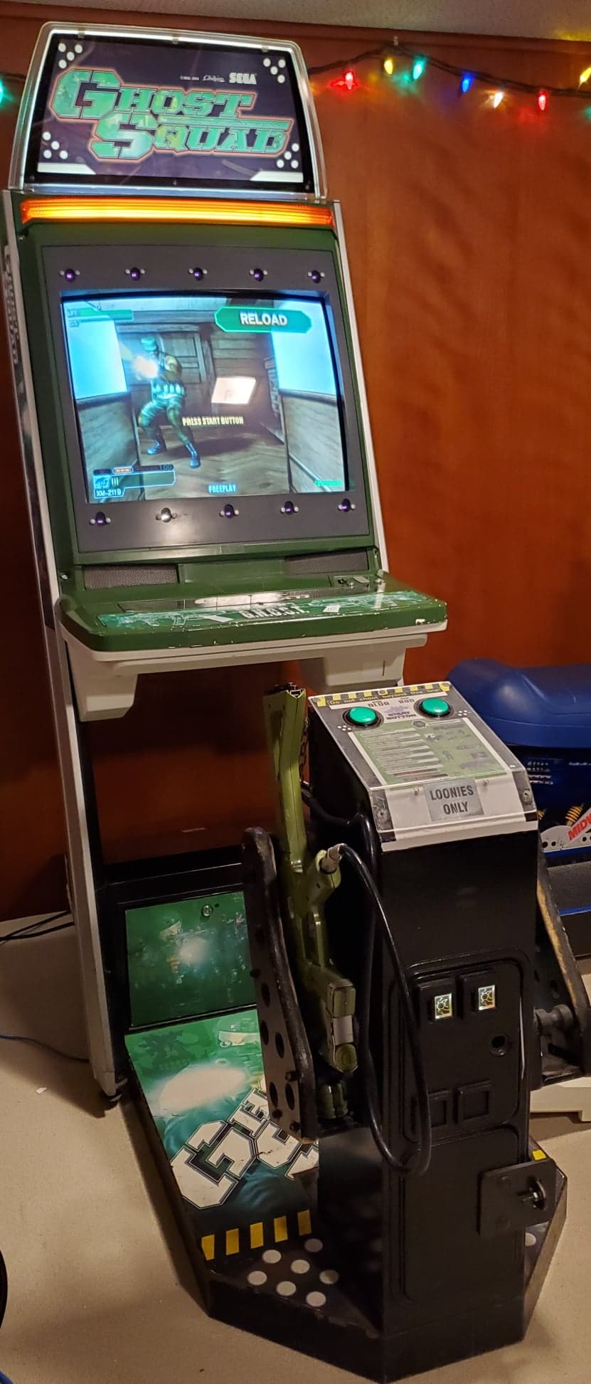

I tried these 2 games on my Naomi 1 in my Ghost Squad cabinet and it didn't work, Sports Shooting didn't see the gun inputs and Clay Shooting would not boot. All other naomi gun games work find including the HOTD2.
